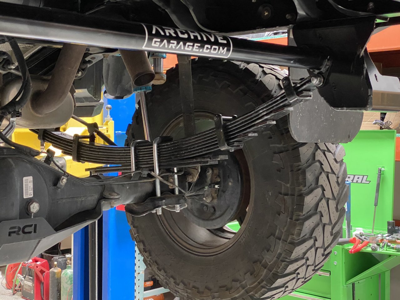

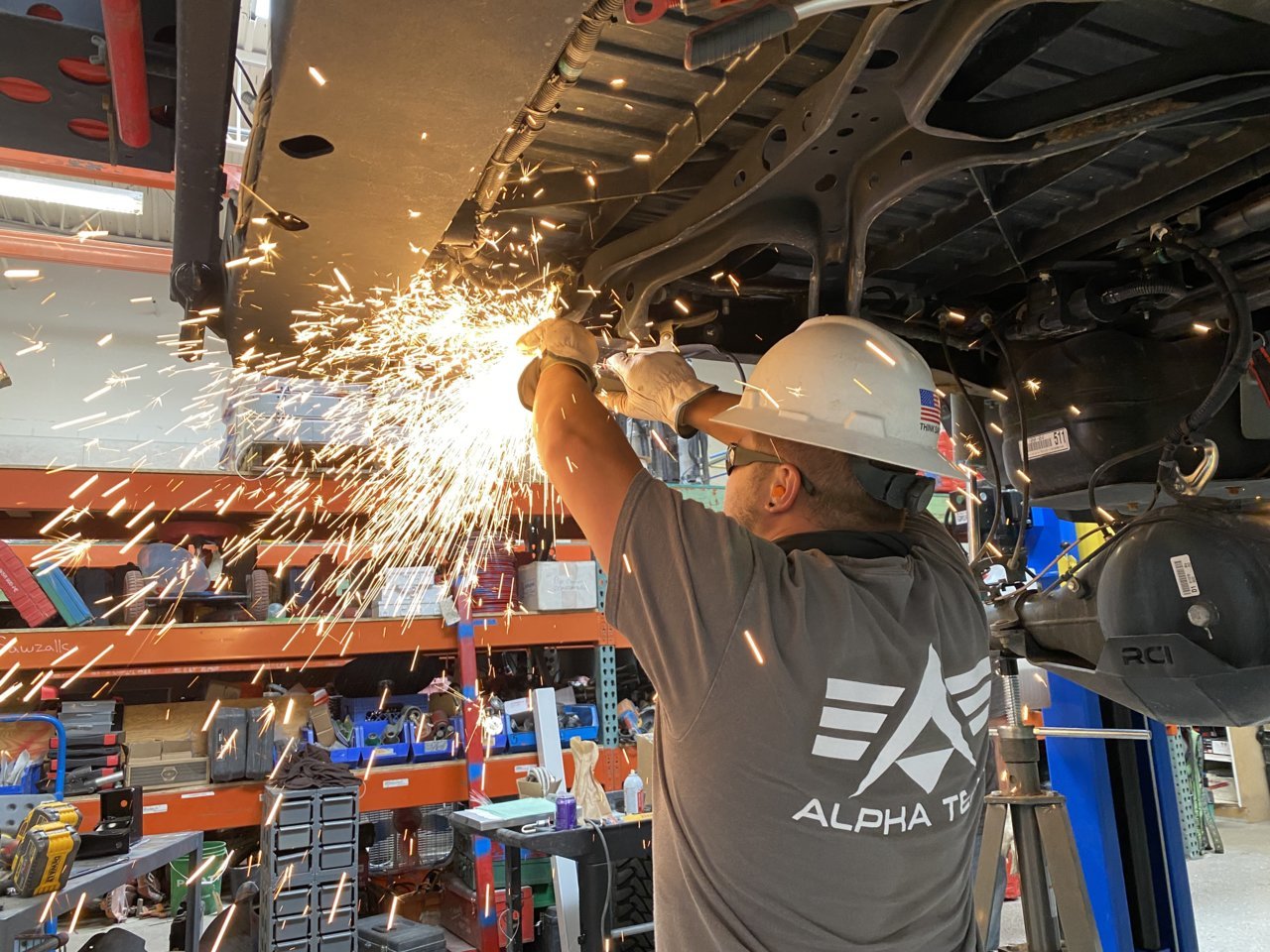

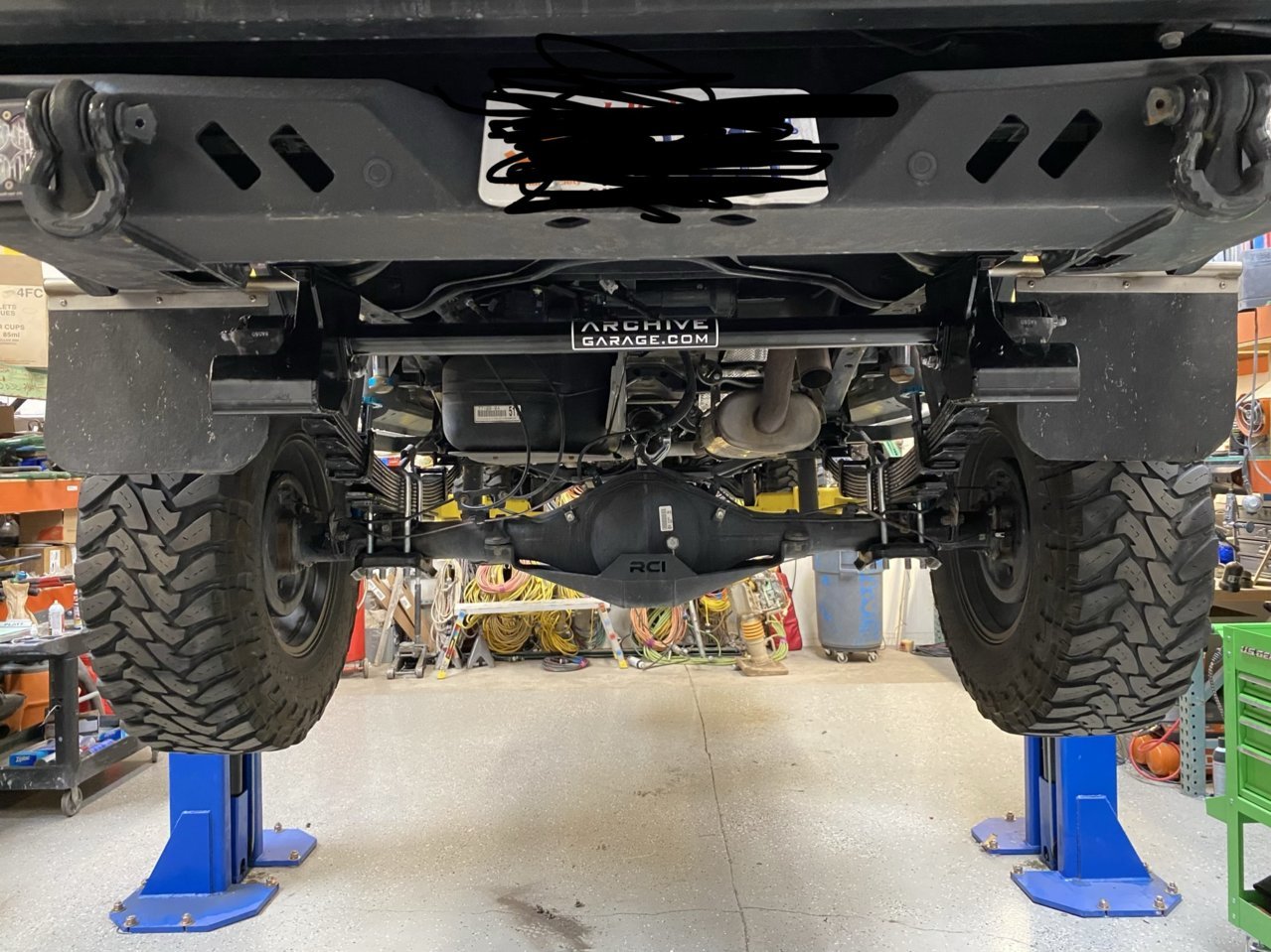

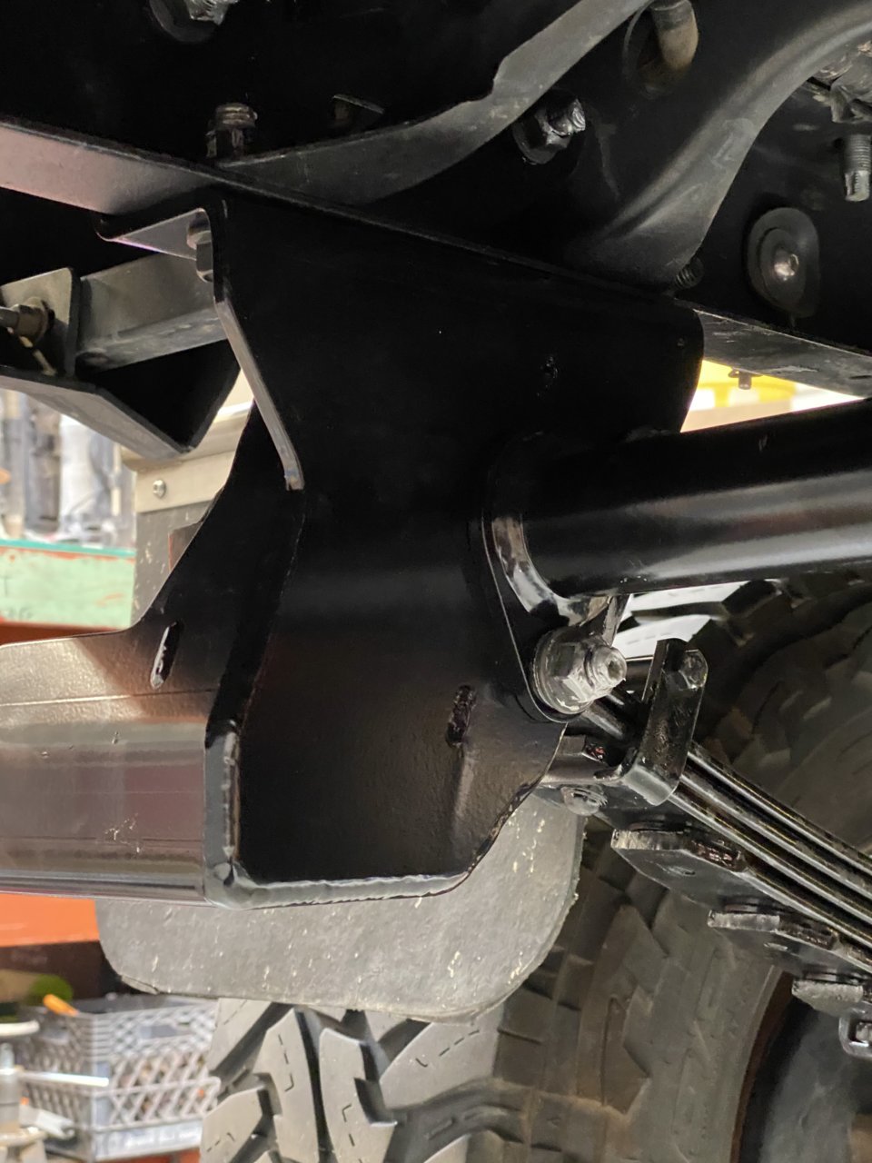

    Did this today. I slipped out of the office into the back shop and :sawzall::welder:
    EDCC8461-D23F-4982-A47C-1A1330745131.jpg 8B4786E4-EF1A-465A-B21F-B70A35F0B0A3.jpg 11A55E18-BDB0-4A30-9AD0-DFE9D30478F3.jpg 0315D48D-B288-4BAA-B002-C775243E72F8.jpg
    It went pretty smoothly all things considered. That’s my co-worker Kyle running the plasma cutter.
    Got everything bolted back on and realized the U402L III was on the right and the U402R III was on the left. It didn’t seem to matter, but swapped them anyway. Then got it all bolted back together, when my other co-worker Zach came to inspect and noticed that we had the bolt on the upper shackle on the wrong side (long end would hit the hanger). Damn it! This one sucked to fix. Used a 6’ pry bar and some cussing to fix it.
    Anyway, haven’t test drove it yet, but got a little rake back with the heavy Deaver U402 III’s.

    That looks so rad! Do the shackle hangers just provide a little more lift and suspension travel kinda like old school extended shackles? And I’m guessing the purpose of the crossbar is to box in the back of the frame and make it less twisty so the whole truck rides better?
  8. Jul 3, 2020 at 10:16 AM
    H3llRid3r
    H3llRid3r Well-Known Member
    Jan 23, 2017
    #208396
    3,458
    SLcUT
    2018 DCSB Cement TRD OR
    Not much stock left.
    Yes, this pretty much sums it up.

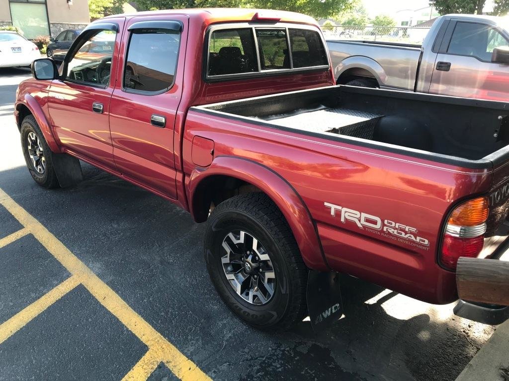

    I helped my coworker get into this gem of a 1st gen. Man I love the size of these.

    Looks very clean. Nice

    Damn! It appears to be in stellar condition.
