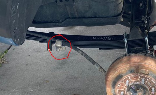

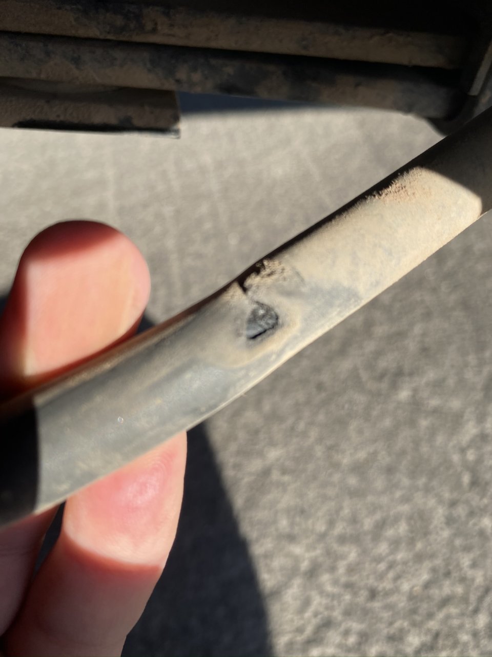

    Those of you mechanically inclined...is there any reason why a shop wouldn't of been able to keep my rear brake line holder on my leafpack?
    I notice my rear brake line, maybe its just the parking brake line, idk im not a mechanic (lol) was way low. It was caught under the leafpack bracket..and it got rubbed raw. I just saw somebody elses leaf pack here on the forum and noticed it had a clip for the brake line..
    So my question is, is there any reason you guys could think of that they WOULDNT of been able to reuse or put it back on after I lifted the rear?

    Thats the parking brake cable. The brake line goes up from the diff to the center if the bed area.
    Maybe the bolt was too big for the bracket hole?

    I don't have my overload spring in anymore..I wonder if the bracket was attached to that...? Either way..not happy. Is that cable hard/expensive to replace?

    If I remember correctly, mine used one of the bolts on the leaf pack.

    The stock leaf pack has a tapped spot for the parking brake line to mount with that clip. My aftermarket leaf pack doesn’t. So I cut my clip off.

    You should be able to attach it to the leaf pack alignment bracket. I drew you a picture. If you have a step drill bit, drill, and box wrench set (or crescent wrench if you’re a savage) this should take about 10 min.
