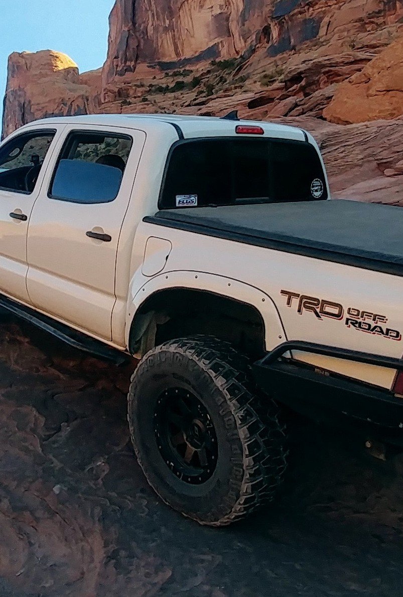

    I trimmed my fender sheetmetal back 2.5 inches or so and in turn did same to flares. The plastic tabs mostly broke, so I looked at others on TW and installed bolts, nuts and washers in the place of plastic clipz.

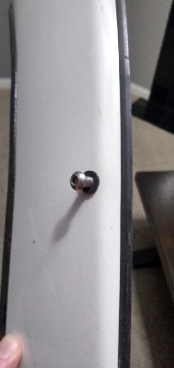

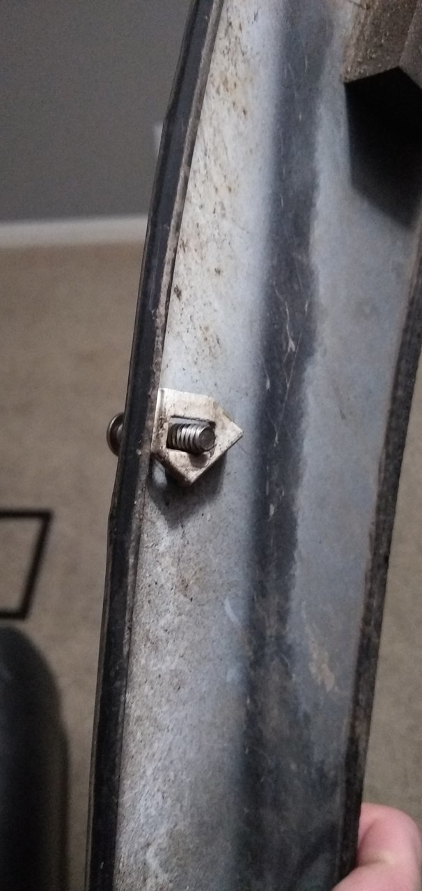

    IMG_20211108_184604461.jpg IMG_20211108_184551182_HDR.jpgInside and out of flare with new fasteners that attach with nuts on sheetmetal fender. Stock are fake bolts and flares held on by plastic clips.Gasket is attached to flare stock and has stayed attached

    So, you left the original gasket on? It looks like you put some kind of edge trim on their?

    Original seal/gasket on side that mates to fender and wrap around seal on other side because I cut 2 or so inches shorter
