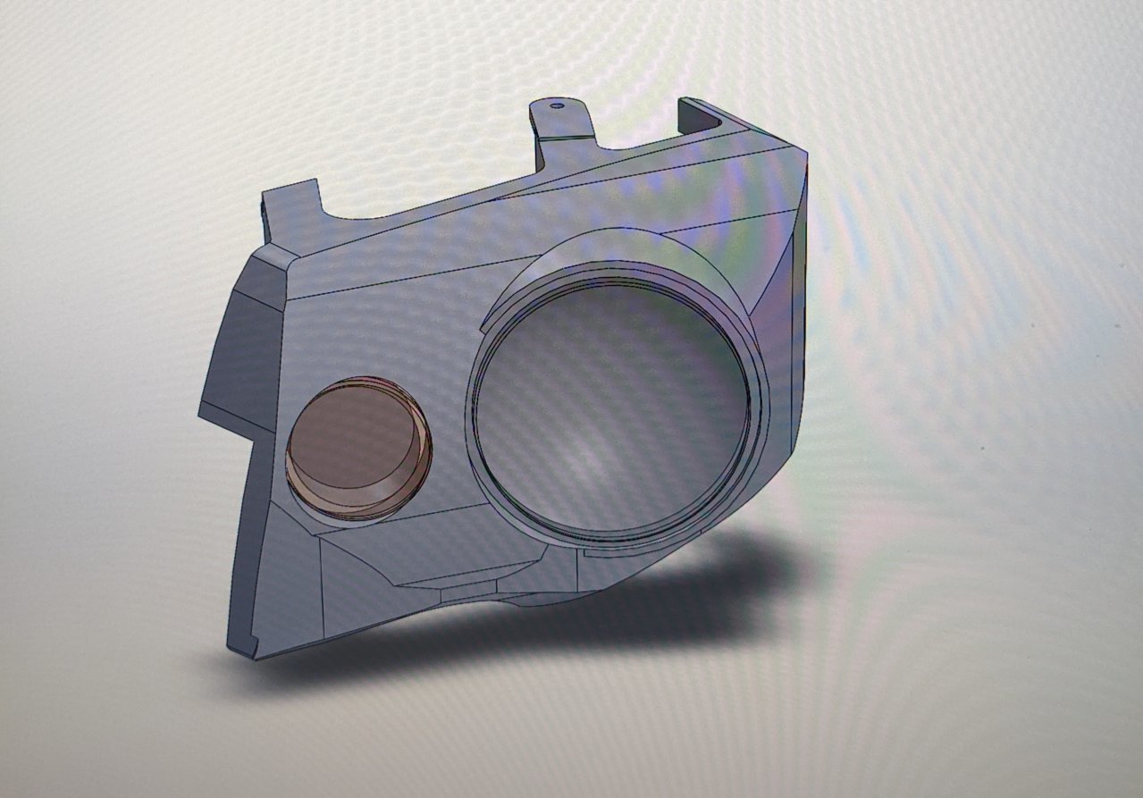

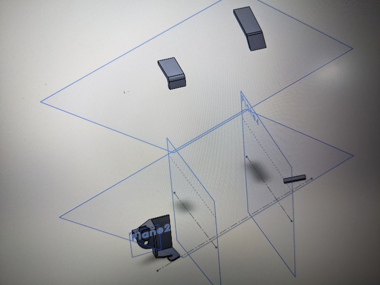

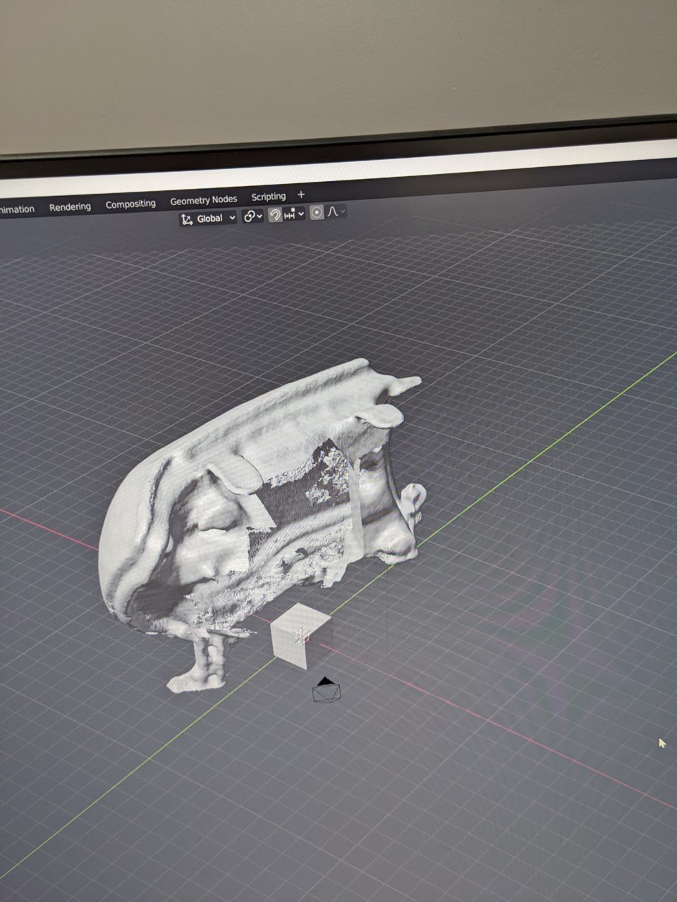

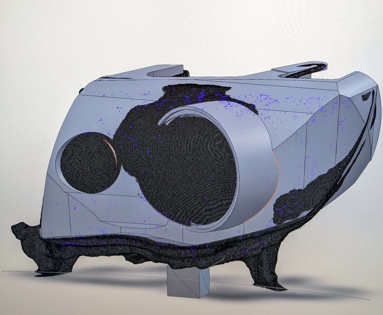

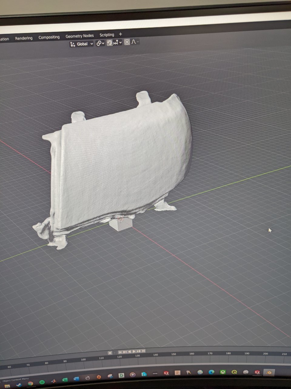

    Some progress on my headlight project.
    I scanned my driver side headlight with my xbox 360 kinect. I then opened up the .stl file in blender and deleted points that I didn't need. I then imported the .stl into solidworks to start the part build.
    I spent about 4 hrs today doing some solidworks modeling of what I think the assembly will look like. I also went down the rabbit hole of 7" LED headlights that are DOT/ SAE approved. I think I will have $1000 of lights into this project. Remember it costs $$$ to have lights DOT/ SAE approved. J.W Speaker has some decent lights that have this qualification. I still need to find a side marker light that fits this design.
    Some thoughts:
    - I think I need a dedicated turn signal. I don't think I can have a head light with the turn signal integrated. I was looking at some vehicle code requirements and I think they need to have separation of at least 100mm or ~4". J.W speaker sells a 7" headlight that has the turn signal integrated. I think this might be somewhat illegal.
    - The headlight itself has so many curves, I think it will take me many test prints to get to the final design.
    - I can see why this hasn't been done before.
    - Part of this design will require a headlight bucket to be integrated. I can buy this from JW speaker. This will allow me to adjust the headlights.
    - The overall design will have to be split in half in order for me to print this. I will have to incorporate alignment pins for final assembly.
    The headlight assembly has about 6 specific points that need to be 'exact' in order to fit in my 2011. I basically have to build around the imported mesh in order to get the right contours. This is somewhat challenging from a CAD persepective but its doable.
    More updates as time goes on.
