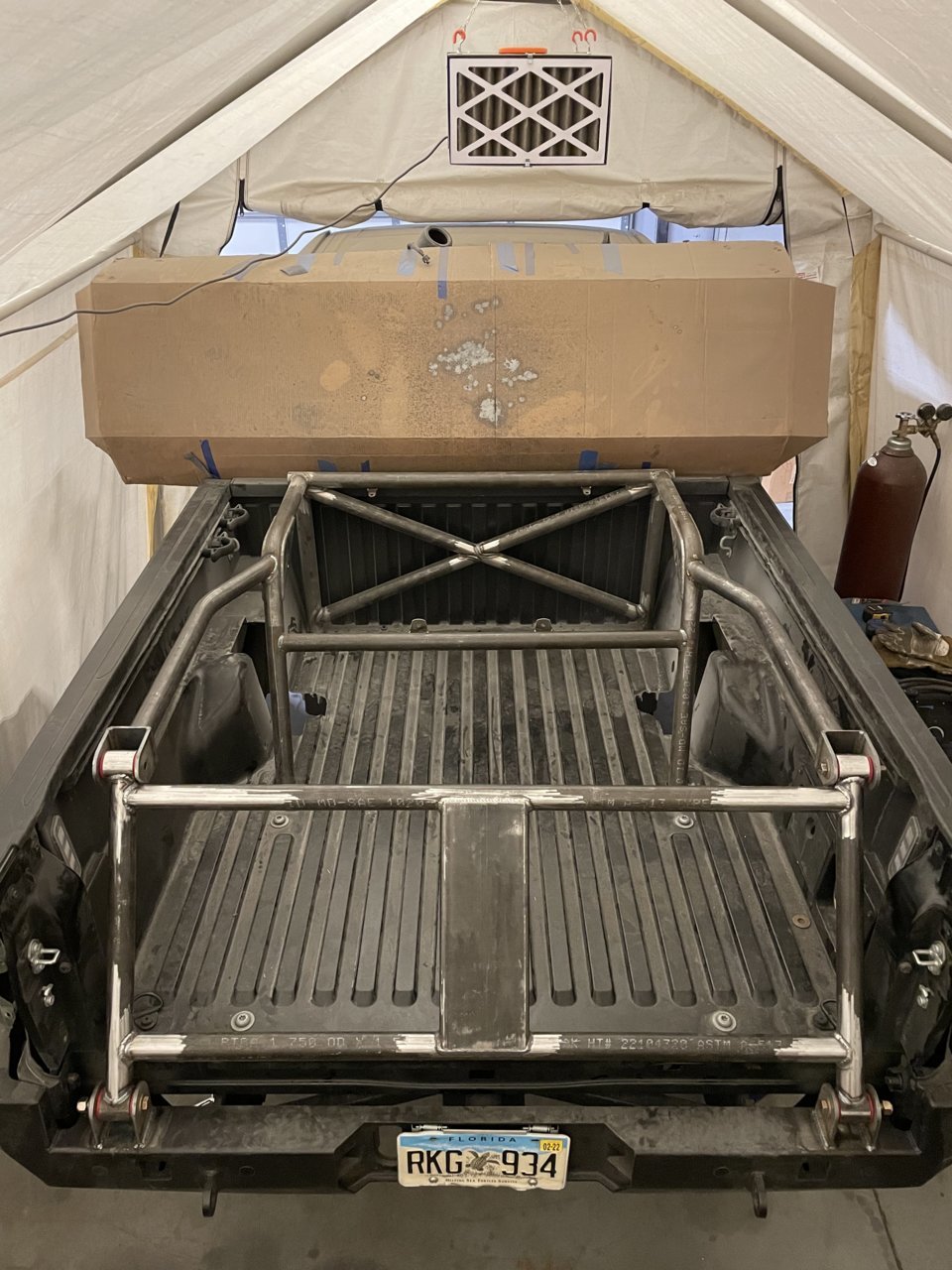

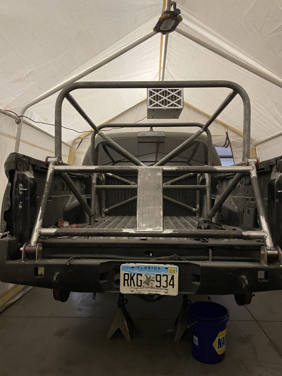

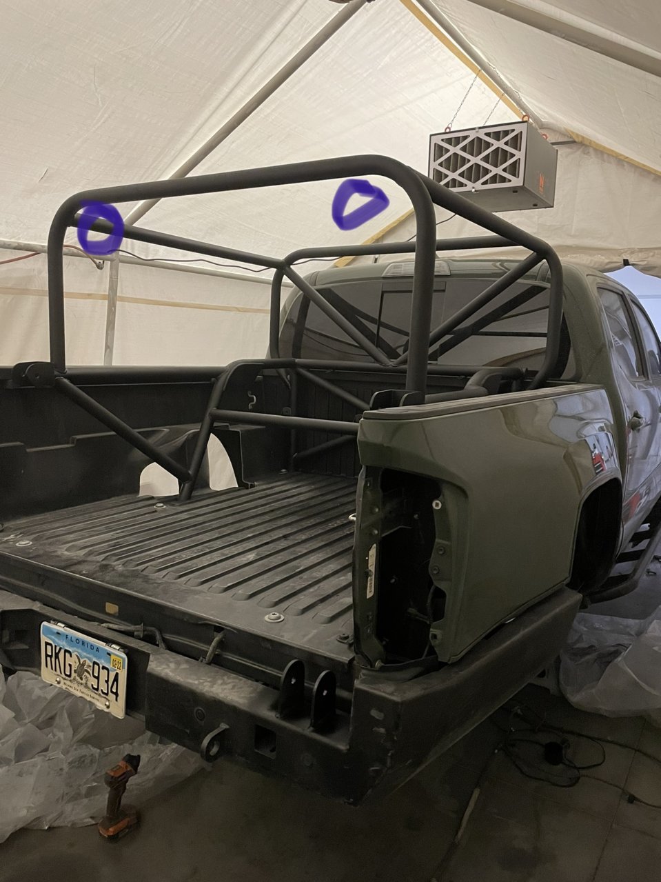

    this is the solution I came up with for a customer. The composite bed is great until you ask it to support weight on the top rails. Tied it all back down to the frame. No issue with the bed moving because it is mounted straight to the frame of the truck as well.

    How's that tied into the frame?

    tubes straight through the bed and welded to the frame. The sub structure below is the coilover mounts and fuel cell mount, then tent rack above.

    So definitely not a more permanent solution...
    I could never do something like that as I need my truck bed to do truck bed things from time to time but if it works for your customer then great!
    Surprised they don't just full cage and 4 link rear at that point if they're already basically going buggy....
    Looks like good quality work though. GMAW or GTAW?

    That’s a full bed cage and 4link rear, but with a still somewhat usable bed.

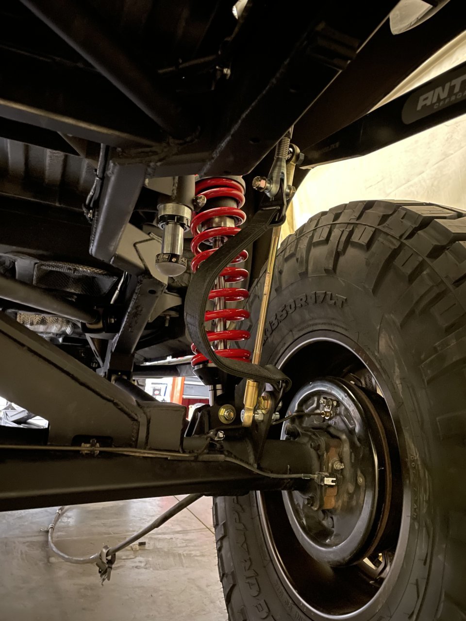

    What do you mean it isn’t a more permanent solution? Seems like it’s pretty permanent to me. It is 4 linked as well. Kept the factory bed trying to keep it as functional as possible. All Mig welded.

    I had two unfinished thoughts that collided there...
    Definitely not removable, and, a more permanent solution.
    :bananadead:
    So it is coiled and linked dope, only further adds to my confusion as to why they would want to keep the bed but alright then.
    Looks really good, what machine are you using?

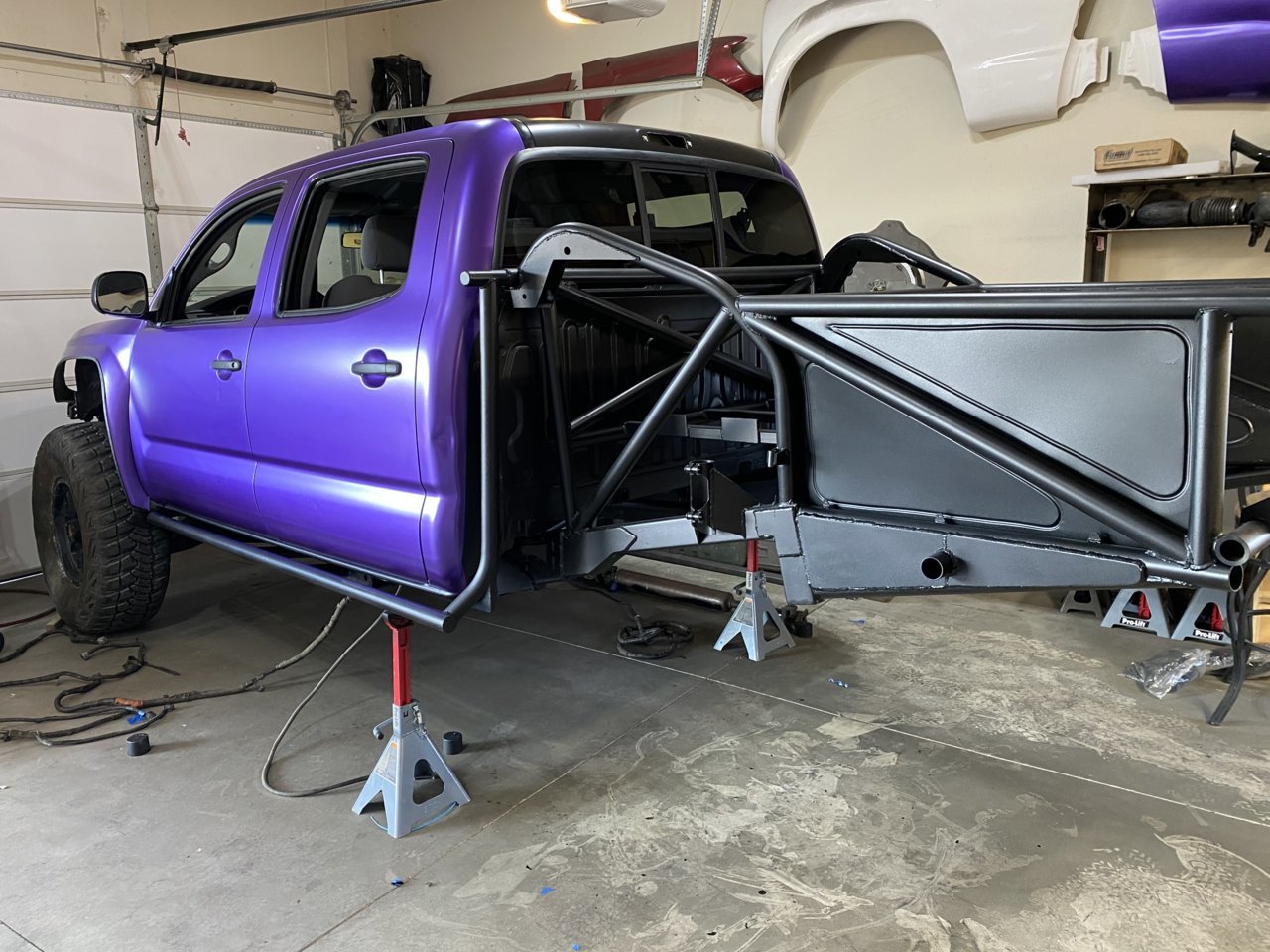

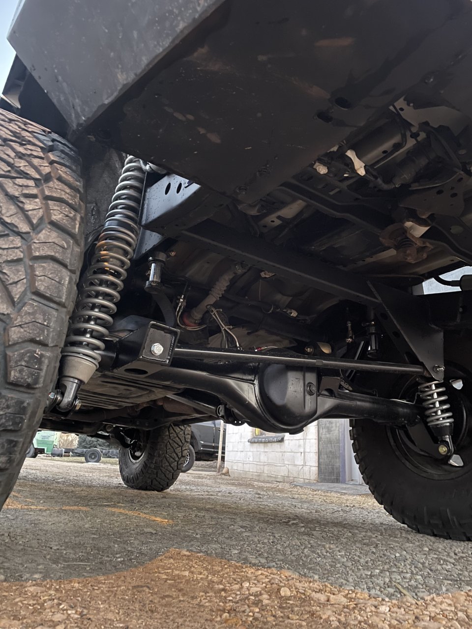

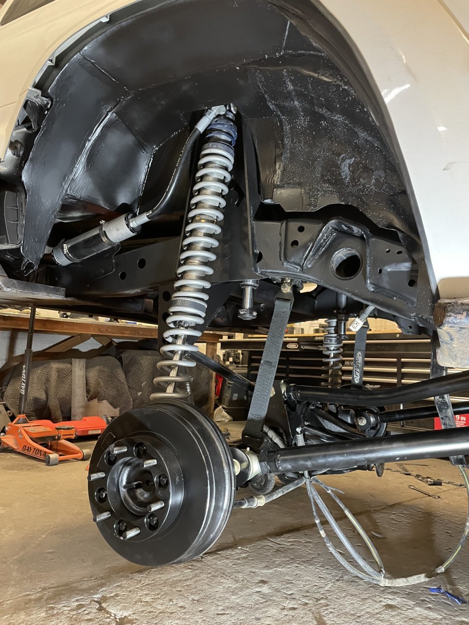

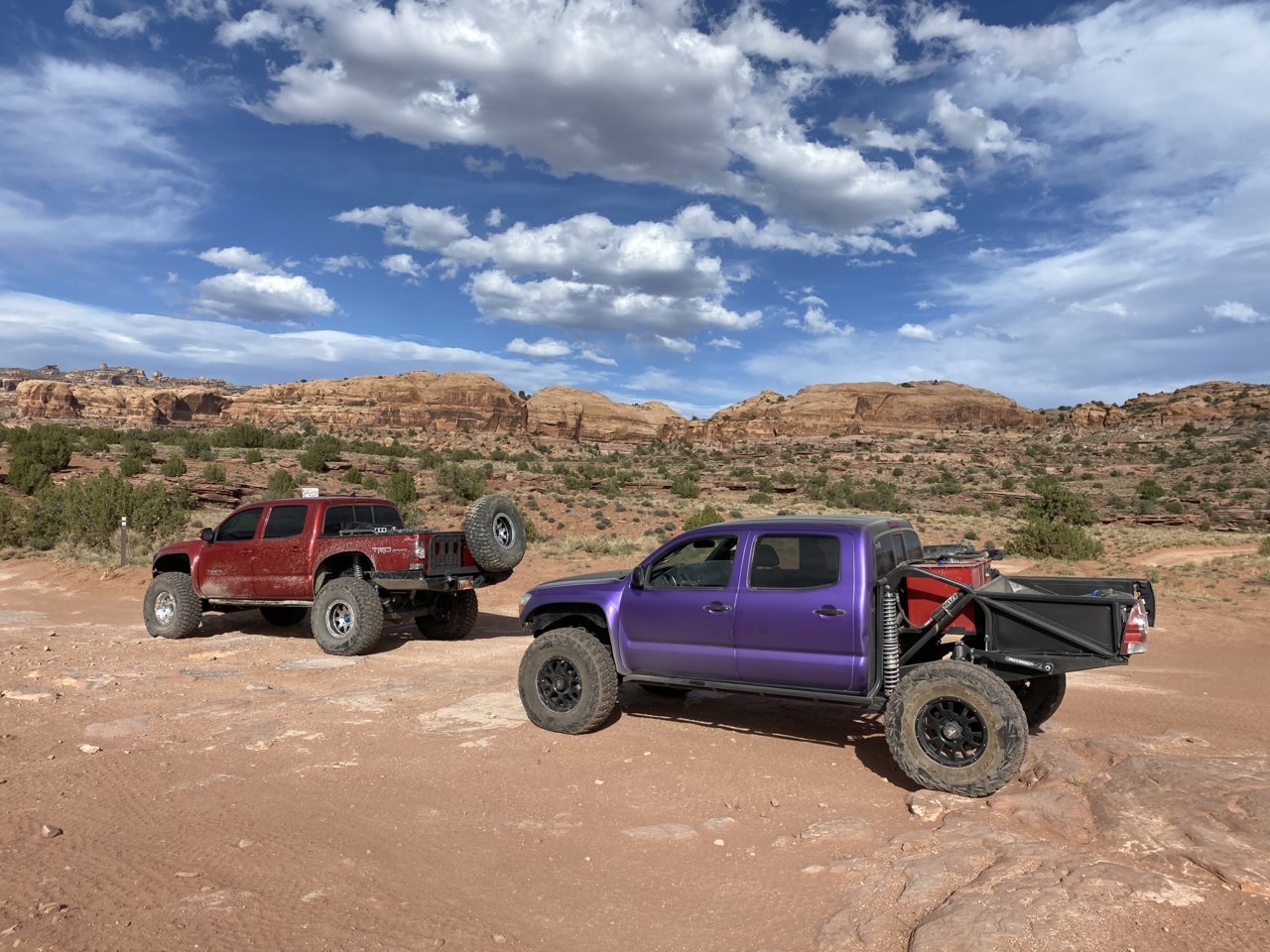

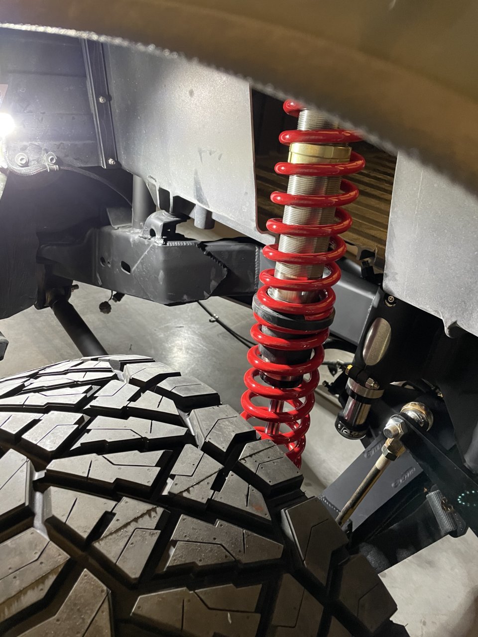

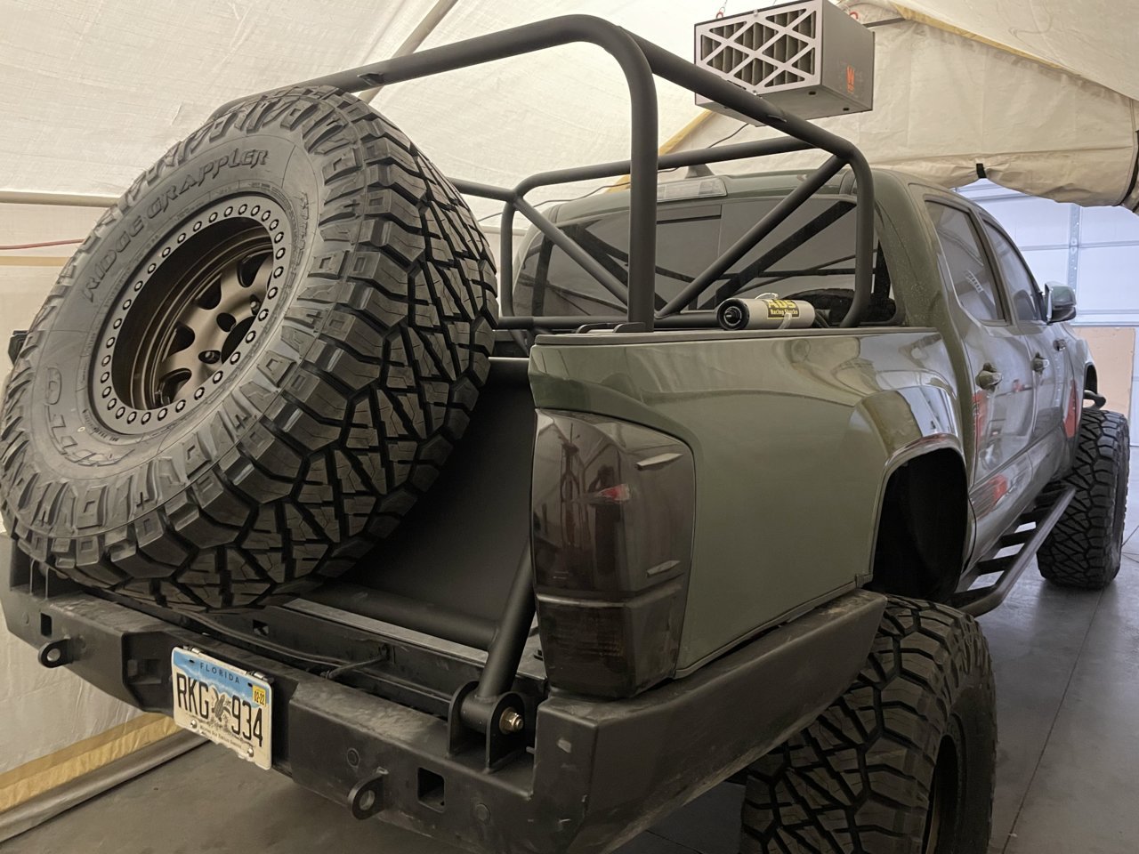

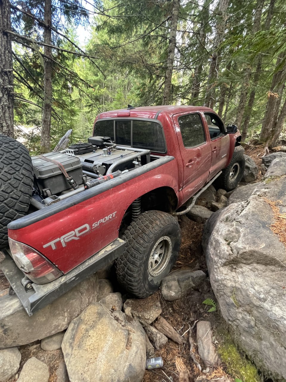

    My personal truck is set up the same way (kept the bed). I've done both full back half and linking with keeping the bed. Kinda depends on how you want to use your truck. I kept the bed in mine for ease of packing tools, parts and camping gear. full back half is more suitable for pure off roading and less camping out of it.
    The third option is also a great option for keeping all the storage space is doing a 3 link and keeping the factory gas tank in the same spot. Exactly what I did for this customer on his 2009 4Runner running the same 16” coilovers.
    Red truck is mine and purple truck is one that I did with a full back half.
    Miller 252. It's a great machine that runs and runs without hitting duty cycle.

    :ohsnap:
    Man that is the hotness!
    What's the little fan/radiator on top of the fuel cell in the red one?
    You got some great work my dude.
    Purple truck looks like Pro-Am Baja.

    Thanks! Linking trucks and putting big shocks back there is my favorite kind of work to do. The purple truck is coming back to get the full bedsides, spare tires mount and rear bumper next month. then it will look mint.
    The fan is my transmission cooler. big 16 pass cooler with a thermostat to kick the fan on and off. Keeps my trans right at 165-185 then when pushing the truck hard the hottest it has gotten is 212 at the torque converter.
