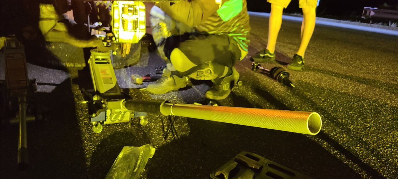

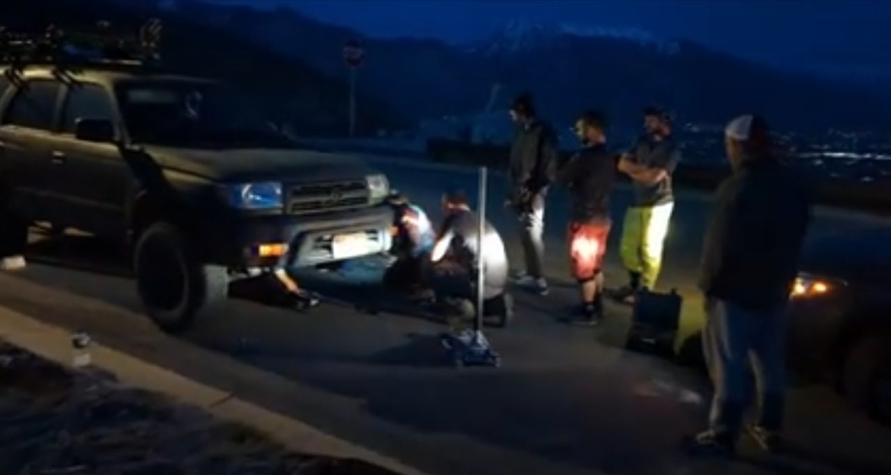

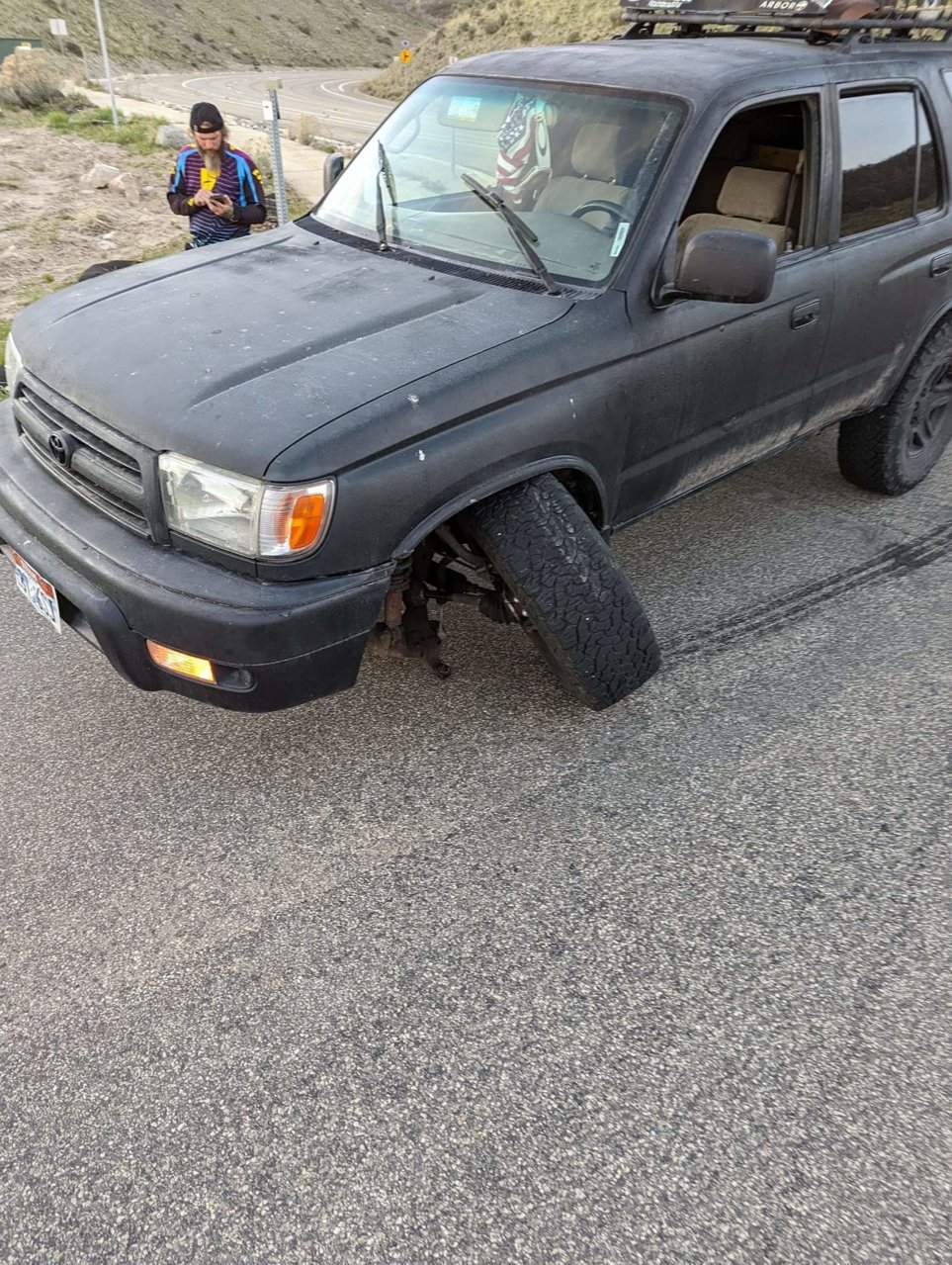

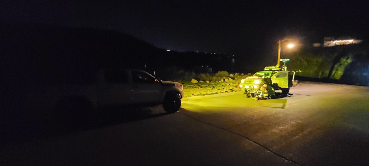

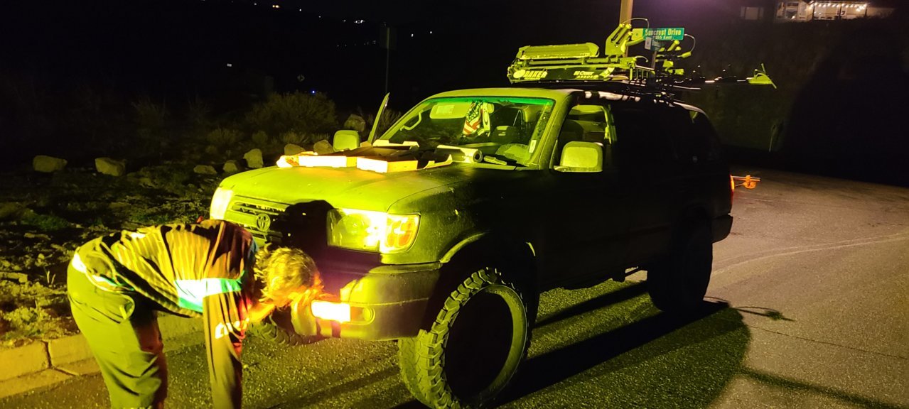

    Pulled the busted CV, bad ball joint assembly, and put a new one on roadside. Unfortunately, the wheel bearing got damaged in the separation and started squealing and smoking in the short limp up the hill to a buddy's house but at least we got it to a safe spot for a tow today.

    damn. that really does look like a party. haha! that's too bad though. luckily it's a simpler fix than not. what happened in the first place? did the control arm just break?

    Classic first gen ball joint failure on the LCA. Said he had the same issue not terribly long ago when the UCA ball joint separated in a similar fashion.

    I believe it was a non-OEM ball joint. That 4runner didnt have the LBJ on the arm, it has a secondary assembly that bolted to the spindle and tie rod and the ball joint dropped into the LBJ at an eyelet.
    One thing I did learn just now (unfortunately after the fact) is that on that design, the CV axle and axle nut sandwich/preload the wheel bearing, so by us removing the busted CV axle for him to get it home, we contributed to if not caused the wheel bearing failure. :(
    Regardless, we got him off a random street by Suncrest and to a buddy's house so he didn't have to worry about leaving it for the night, and everyone got home safe.
