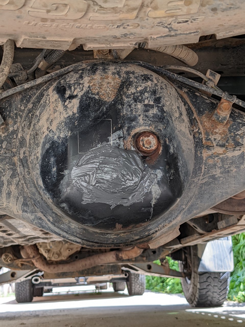

    Managed to poke a 1/2"hole tear in my rear diff while up in Idaho this weekend (no pics). I limped 30 miles back to town and fortunately found some quick steel and JB weld. We ended up swimming in a river for an hour for my quick steel to setup before driving back to camp. At camp I mixed some JB weld for some additional protection against the gear oil. I wasn't sure if oil will permeate thru the quick steel. Doesn't look the best but it got me back home to slc on our 300mi drive. I also topped it off with some 75-90 oil that I had in my backseat.
    Funny thing is, I am not sure how I punctured my rear diff. We were literally 75 Miles into our fire road drive. I wasn't doing anything hard by any stretch. The diff looked like it was punctured from the inside out. The truck drives fine. No grinding gears. I also didn't back into anything...
    I plan on taking my third member out and seeing if I have any chipped teeth. If I do have any chipped teeth, I will be surprised. The puncture in the diff definitely looked like it was from the inside out. My theory is that one of my nitro teeth finally chipped an then flew out towards the cover. It's a stretch on the theory front...
    I also plan on cutting off my diff cover and welding on a new one from Barnes off-road.
    https://barnes4wd.com/products/toyo...ifferential-cover?_pos=2&_sid=939328fc5&_ss=r

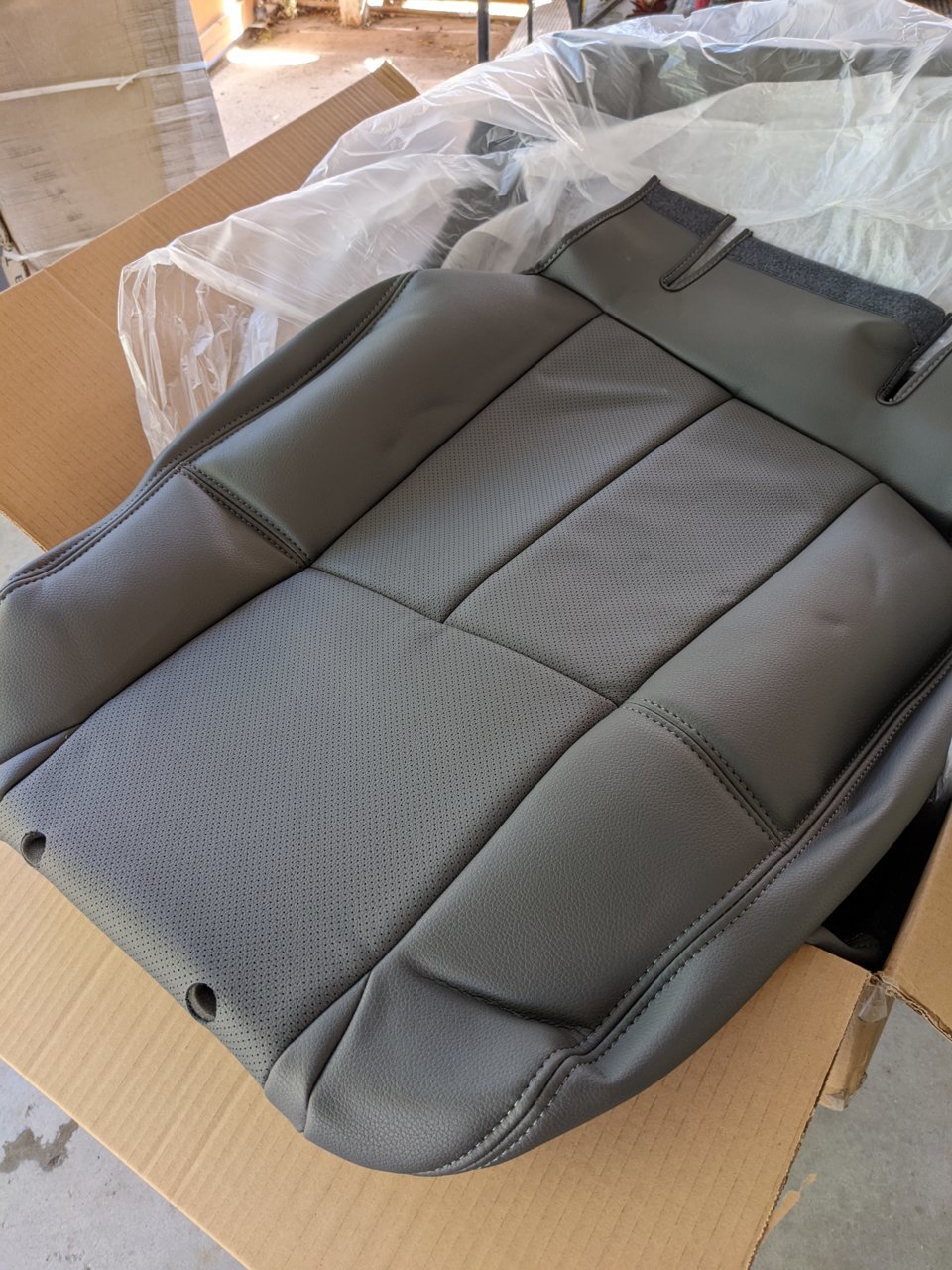

    On another note, I ordered some clazzio seat covers. These are leather and the installed pictures look identical to traditionally covered seats. I'll post more pics after I Install them .

    I suppose you have no pics before the JB Weld...

    Nope.. too pissed off and worried about a tow of over 300 mi back. Home. Haha

    How many miles do you have on the gears?
    Clazzio makes a fabulous seat cover.
