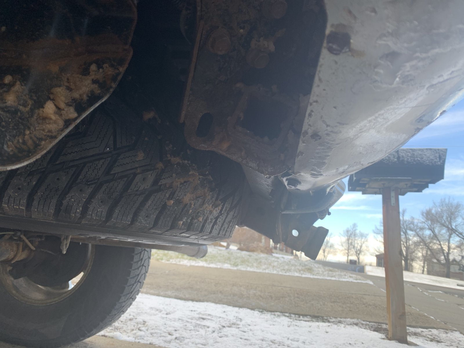

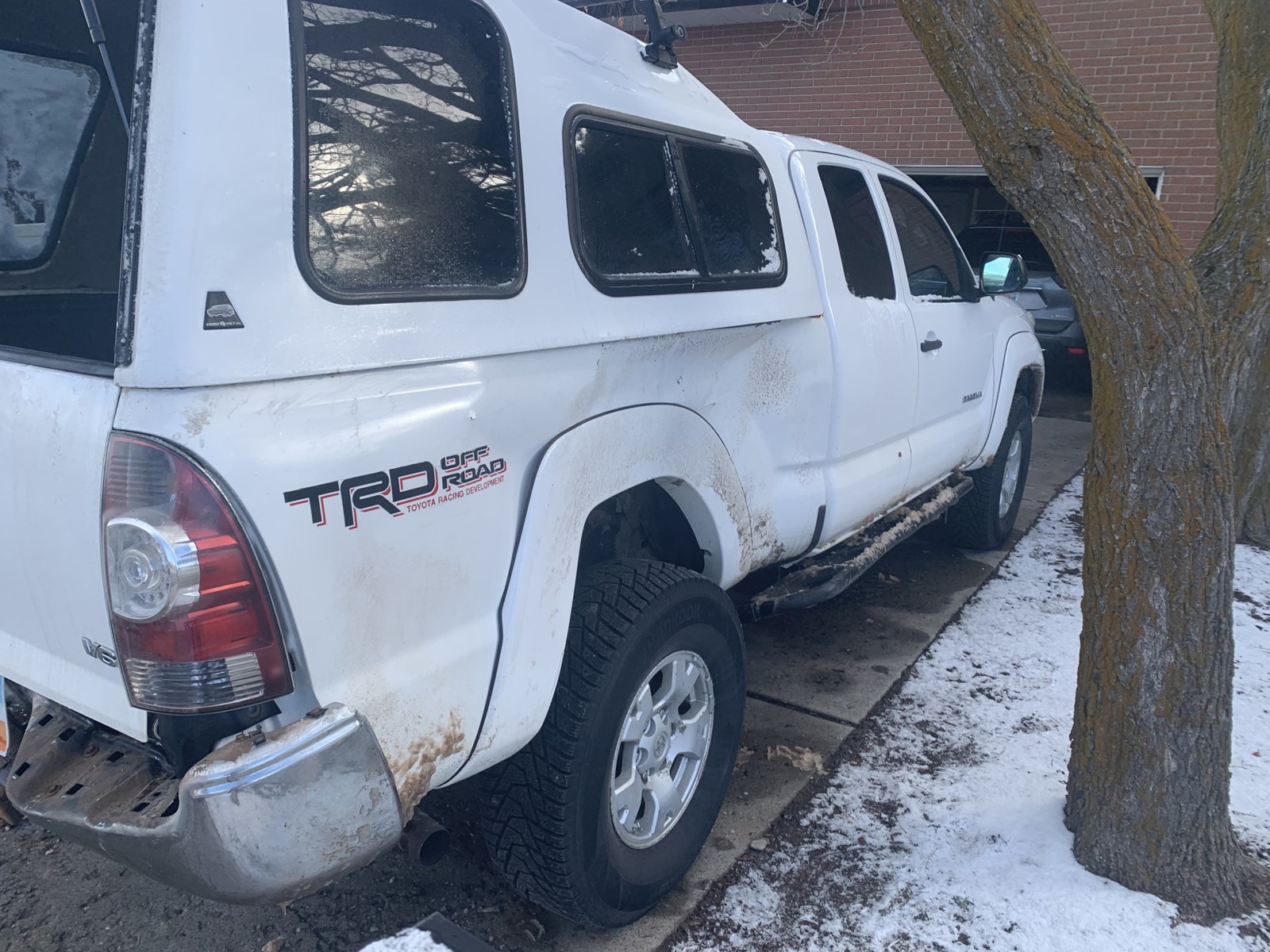

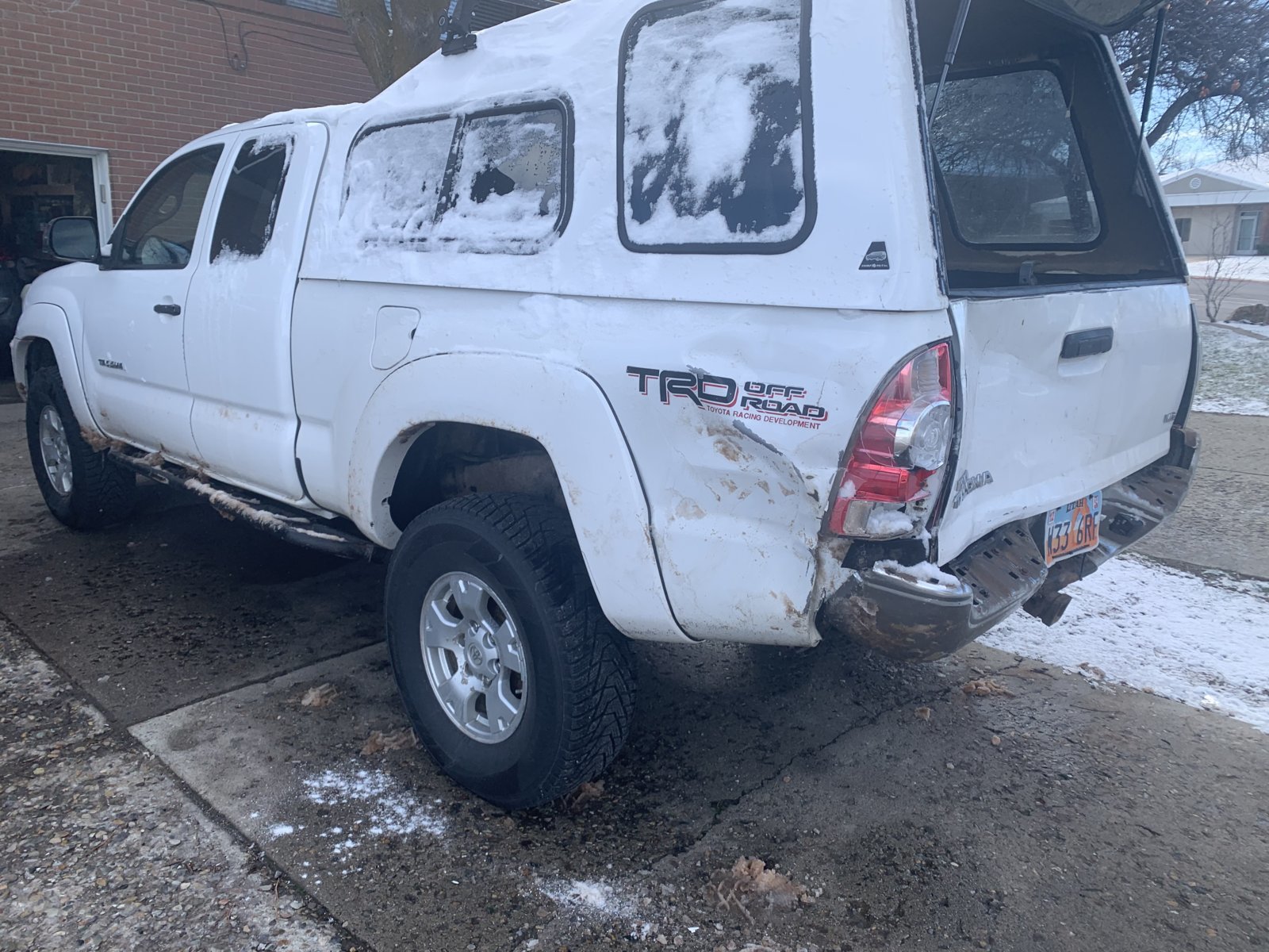

    I took my bumper off and the frame horns are sheared off at the rear spring hangers. There is no straightening that can be done, the frame horns either have to be replaced or the whole frame has to be replaced, which is not happening. Insurance wants to total the truck out. Anyone know a reputable welder/fabricator in the valley?
    Otherwise I’ll be attempting to find a new rig. Used car prices are ridiculous nowadays! Anyone got a deal on a DCLB Off-road or 1st Gen tundra, also looking at 2nd gen tundras just not sure I’m willing to go that big yet lol.

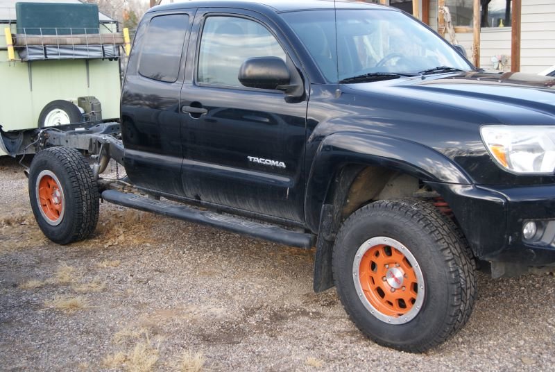

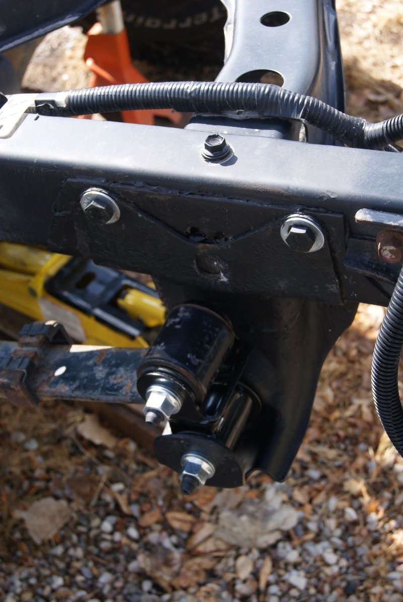

    Buy the back part of a frame from a truck with front damage. Just enough to be in front of the spring hangers. Then cut off the rivets that are holding everything together, and cut off the back of the bent frame. Cut some slices into a corner of the frame, front to back, far enough that you can lay the straight parts over the existing frame tightly. Then use grade eight bolts to tighten the overlaid frames to each other. Weld if you want to.
    This one is only done similarly using the new chunk of frame only on the bottom. The green truck I posted a picture of had the complete frame done from behind the spring perch on one side as I described. I don't have pics of it.
    What do you want for the truck as is?

    I'm serious about buying the truck if you don't want to fix it yourself. Find out what your insurance company will sell it to you for and I'll pay you up to $500 more if the money is right.
    What's the milage on the truck? V6?
