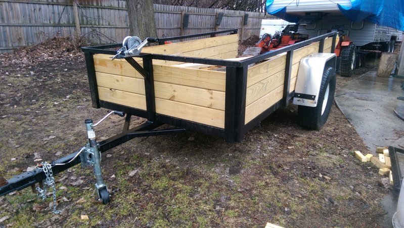

    You won't regret getting a utility trailer. My suggestion is to get the cheaper one with smaller tires. You will be replacing tires/ rims in the near future. Replace with bigger,radial tires. It will come with bias tires and they are all shit!
    I build utility trailers, so I kind of have an idea on what is decent out there.
    This is what I like to build.

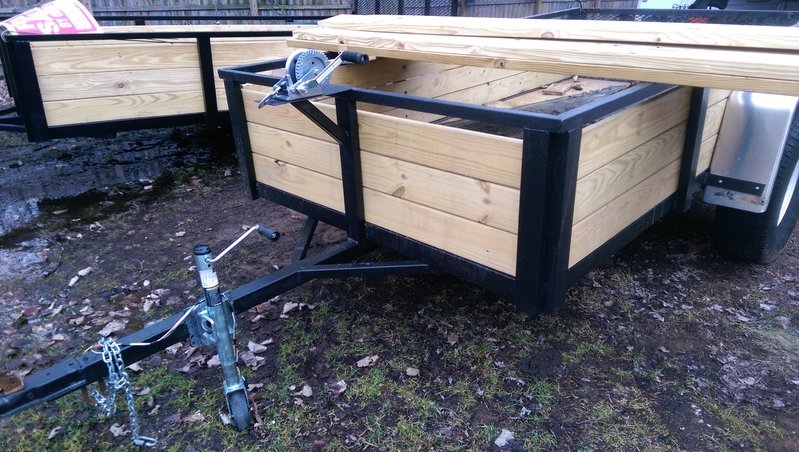

    Its just a distorted PIC. Here is the best PIC I can find.

    You do need the tongue long enough so the corners of the trailer don't knock out the tail lights on the truck when sharply turning the Trailet while backing up.

    Yes, the winch is a nice feature. The first time you have to winch up a dead quad or mower, you will be thankful.
