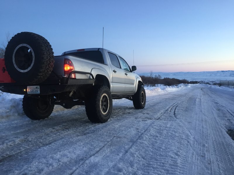

    Finally got both diffs back in, and drive line back on. Bleed the breaks and set the rear drums. Started the break in process, have about 4 weeks to get 500 miles on the new gears.

    60miles down 440 to go. I think 500 miles sound easier than it really is.
