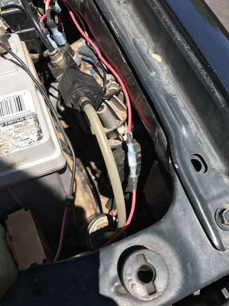

    I have this exact issue. Put a nozzle on the breather of the compressor and now oil sprays into a catch can hahahaha. It will stop working one of these days I'm sure

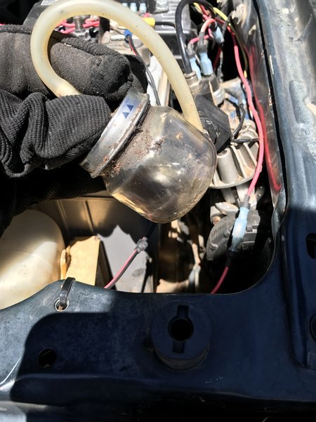

    Need 2 people for a video, but you get the idea haha. Just a baby food jar with a some JB weld and a plastic fitting.
    You can kind of see a teaspoon or 2 of gear oil in there

    pretty slick fix

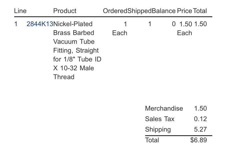

    McMaster part number for the compressor side
