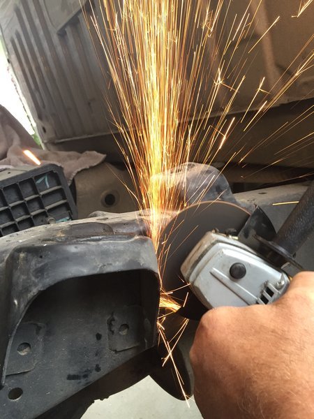

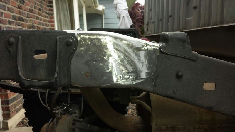

    Got some more grinding done on the stock shock mounts, man those things suck to take off. Still have the driver side to do.

    This!! They suck to cut off haha!

    No kidding on that one, I spent more time than I wish to disclose on the first side... and gouged the axle. :annoyed:
    The second side wasn't so bad but still a ton of work in the end. Where's your obligatory shooting sparks photo?

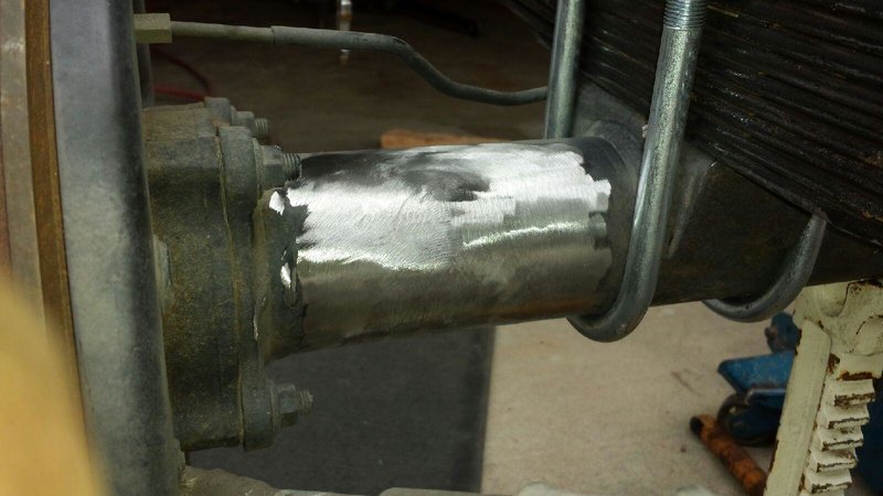

    Yeah, it sucks and you have to be careful which is a bad combination. Did pretty good on the axle only went a tad deep in the frame once.
    Just for you @TacoSTIG

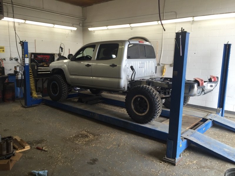

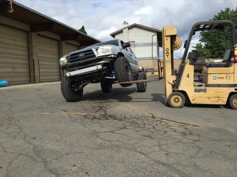

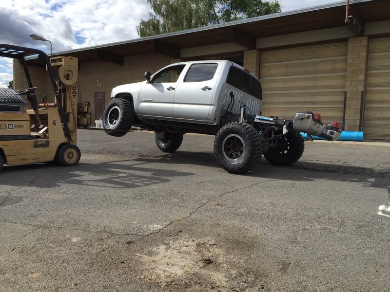

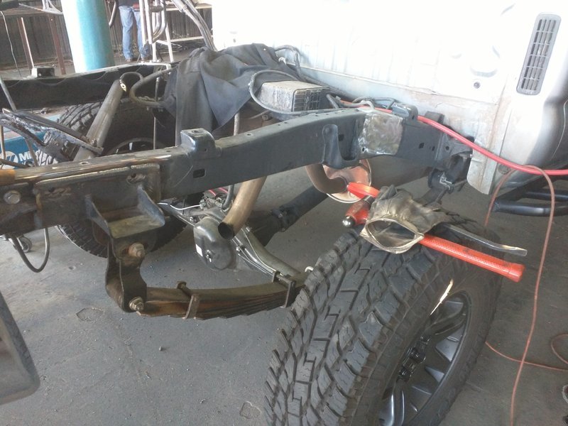

    Started the day off getting the truck over to the shop to start welding on the relocation and finish cutting off the stock mounts. Thought it looked pretty good on the lift.
    After starting work, the day just kinda got away from me and didn't get any more pictures of the work, but got relocation, and shock mounts and limit straps welded up. Got to flex the truck for time.
    After flexing noticed I need to adjust the limit straps, welded them a bit to low and ran out of adjustment. Also going to have to run spacers in the rear to clear the shocks when flexed. I order a set of 1" BORA spacers last week should be here soon. Still need to paint the frame and towers, and finish welding up the CMC.

    Awesome!!! I got 1" spacers in the rear too cuz of the rear shocks rubbing a little. It works out nicely cuz it helps the rear track width match the front since you're running the LT up front now

    Yeah, I almost went with .75" spacers, but thought 1" would be better. I'm tempted to added some cross braces to the rear since i have the bed off, and maybe box it in a bit.

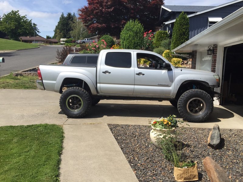

    Well, got the suspension completed, bed back on and limit straps set.
    Hoping the first week of June to order the armor. Any recommendations for skid plates?
