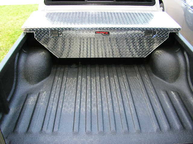

    Looks great!

    I had same questions when I installed mine. It was a Kobalt from Lowes (by BetterBuilt). I just drilled new holes closer to the rail so the j hooks were not at such a radical angle. I know what you mean though, it seems precarious, but really is not as the box is on there real tight.
    One enhancement I did do was, instead of the regular bolts, I used bar knobs I think they are called. They are bolts that are embedded into a black plasic t-handle, for quick on and off w/o a wrench. Wish I had a pic right now but I don't.
    Nice box though you have, the black looks good. John

    Your mounting is probably OK. You could have made the holes a little closer to the lip and just used the two J-bolts. They really don't want to move after installed, esp. if you used the foam pads on the upper bed rail.

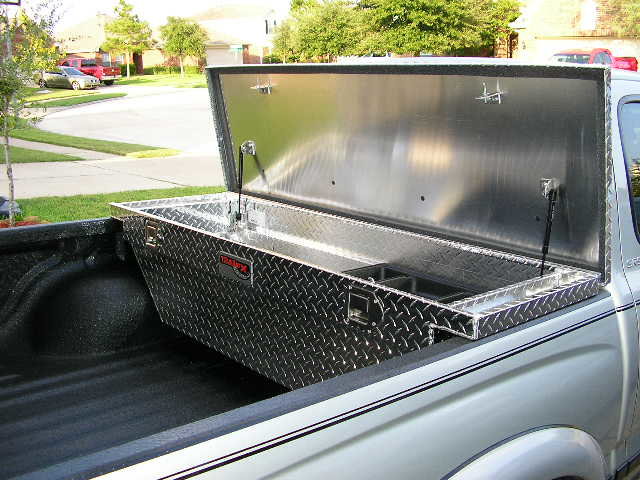

    I mounted mine with two J hooks per side. There are slots underneath the bed rail. Very stable with two per side.

    I didn't use J hooks at all for that exact reason. It looks like you have the bed rail mounting system. Try this:
    http://www.tacomaworld.com/forum/2n...write-up-tool-box-mounting-using-j-hooks.html
    Scroll down to the bottom of page one and look at the write up AG4892 did with the carriage bolts. I made and used one of those brackets on both sides and the rear of the box. I think the carriage bolts i used were only 2" long. You would have to rip the rails off to even move the box if you were a thief! very secure. Let me know if you have any questions or want me to post some pics.

    I found images on Amazon of the lid up, and there is hardly any clearance at all between the lid and the rear window. I have a CleanBreeze truck window screen on my sliding rear window, and it sticks out an inch or so from the rear window assembly.
    How far toward the back of the bed could you slide the UWS box before it hits the wheel wells in the longer (6') bed?
