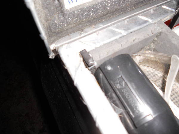

    the lights are actually powered through a rocker switch in the very corner of the box. when the lid is opened they turn on. when it is closed they turn off

    can you share the light set up with us, sounds good.

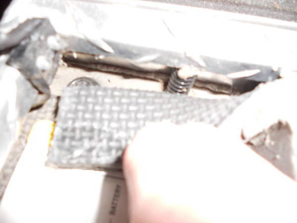

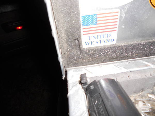

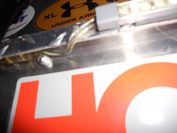

    I will not a problem. I used a switch from radioshack. I ran a hot wire from my aux fuse panel and drilled a very small hole in the driver side corner of the toolbox. I drilled 2 small holes in the corner on the edge that I mounted the switch too. From there I ran the wires to my lights up under the ledge. I used led strips from oznium.com. After over 2 years of use lights are still working great and the switch is too. The light bars are also waterproof. Also heatshrink can be put around the arm of the switch in order to adjust the contact point if it needs more. I will upload some pictures shortly and this will all make a little better sense.

    Switch and you can see the contact point for the lid
    Light output at night
    Another shot of the switch
    Wires Under ledge for the lights
