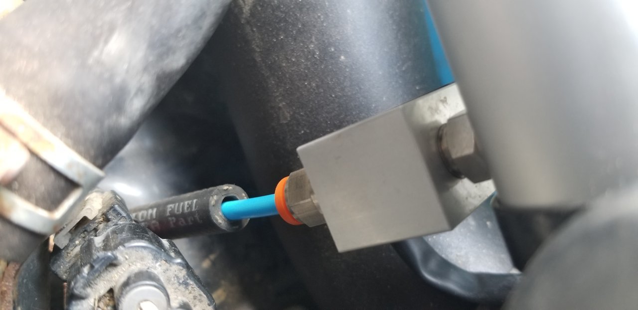

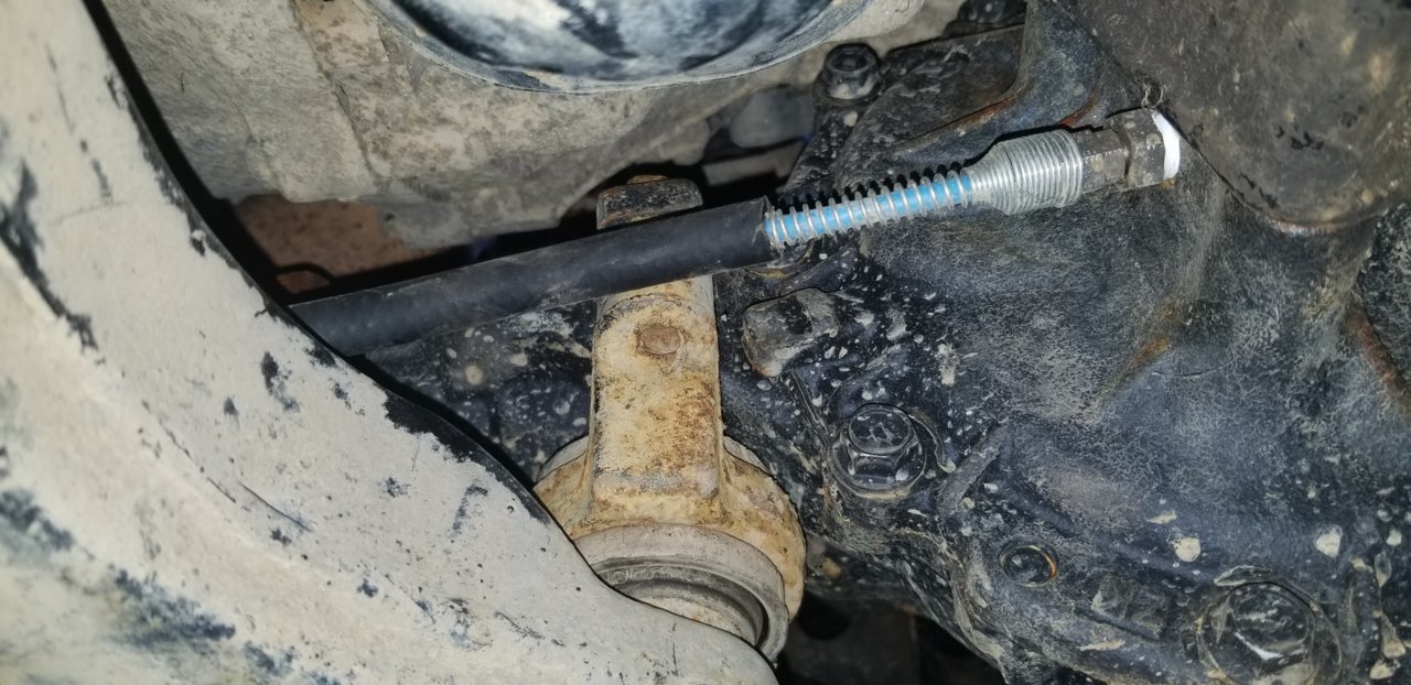

    Buttoned up the front ARB Locker (another mod that I fail to complete for a long time)
    PSU Taco suggested that I protect the air line from heat and chafing by running it through a stronger hose....
    I ended up using about 6' of 1/4" fuel line from pep boys..... in total this simple mod ran me about 20 bucks

    Good move - the factory air lines are fragile. I used Nylon coated stainless steel braided air lines from Quadratec.

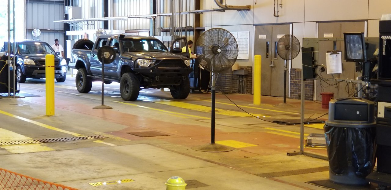

    Gotta love NJ's no-safety-emission-only inspection these days....
    Just passed with my tailpipe cut just past the axle, no rear shocks, no front license plate, and 30% windows tints
