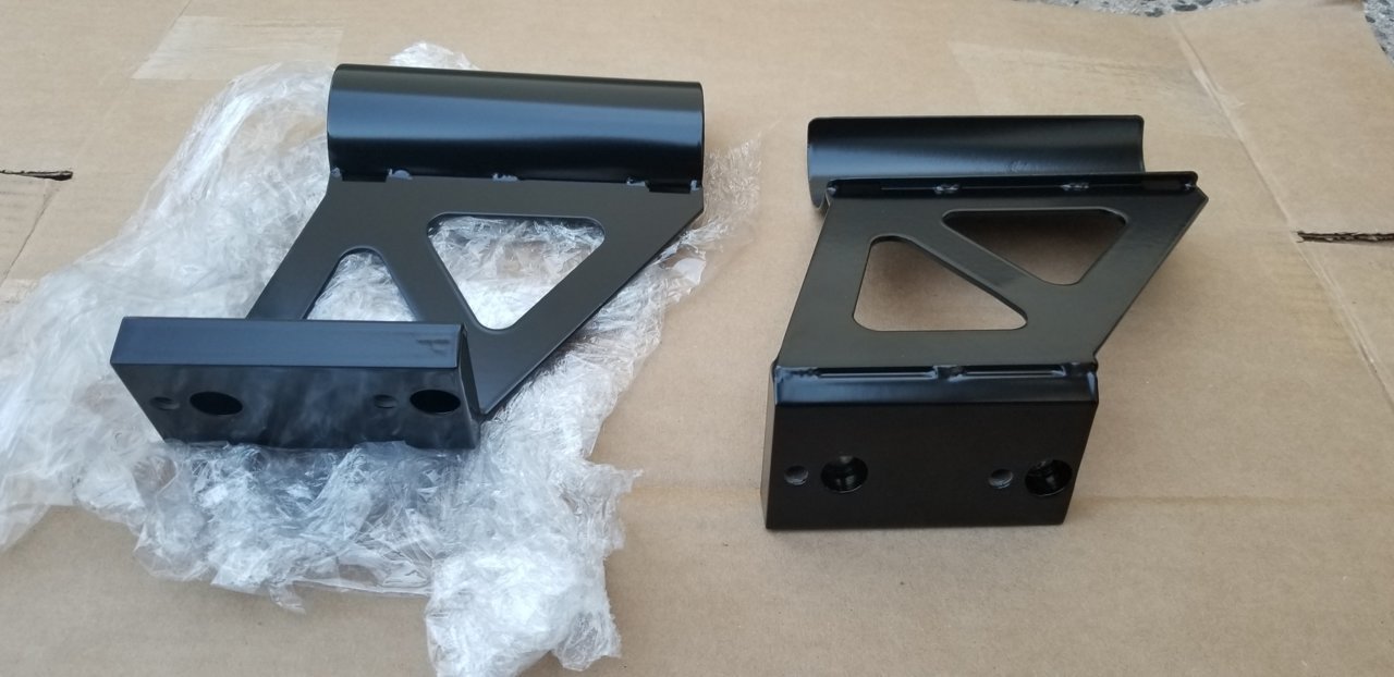

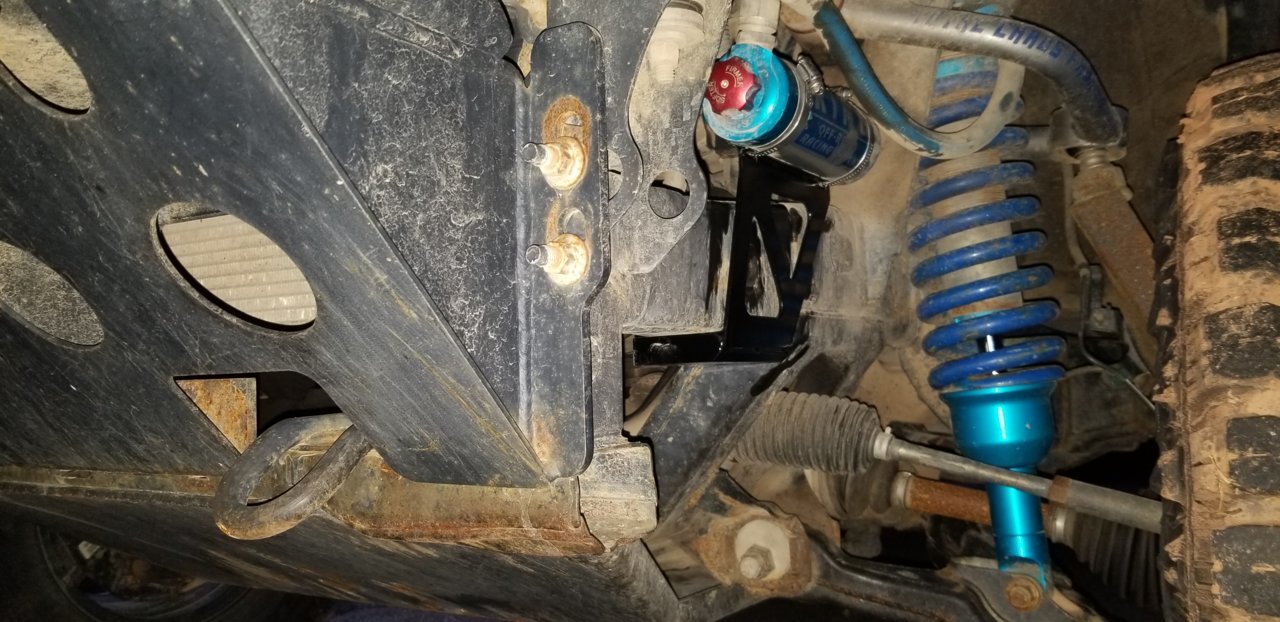

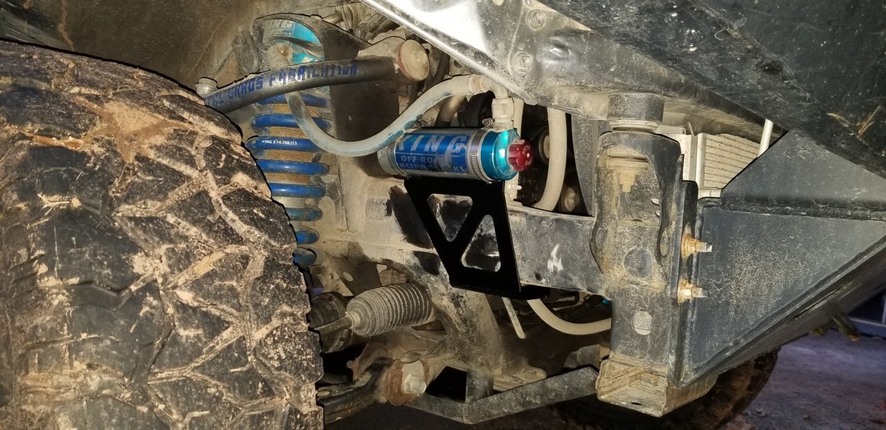

    Had my resi brackets media blasted and PC'd a while back but a usual, I took forever to put then back on.
    They sure make all the rust and dirt stand out even more. :mad:
    When I took them off, I "temporarily" held the resis with zip ties and even though they sat lower than usual they held just fine during normal conditions, but then I went out to explore on some really tight trails the other day, the tires rubbed the resis a little at full lock and damage the King stickers (what am I going to do without the King sticker glam :eek:)

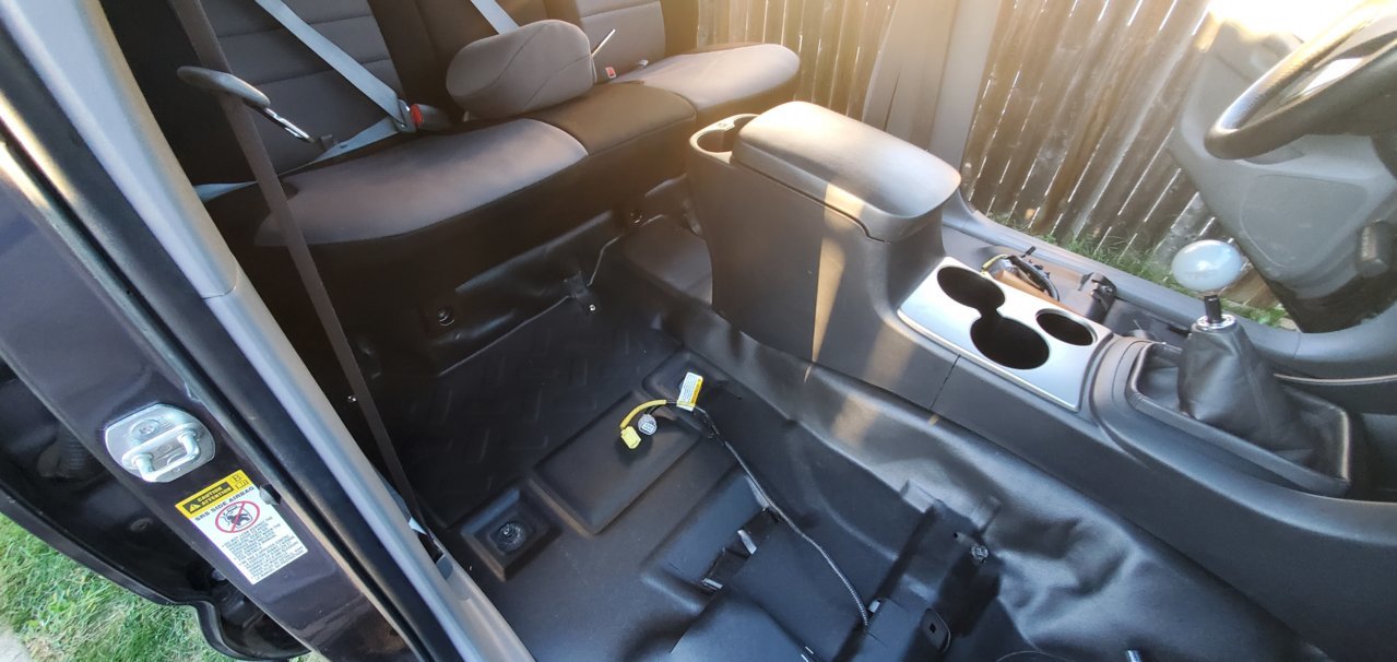

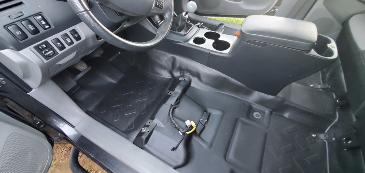

    Gave Ron some Vinyl flooring
    Toyota part # 58510-04980-B2
    Vinyl MAT ASSY 2nd gen tacoma up to 2015 manual trans double cab

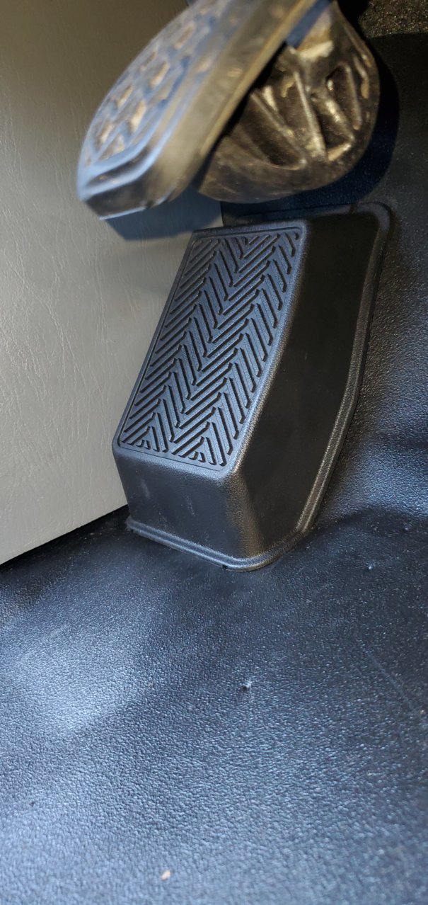

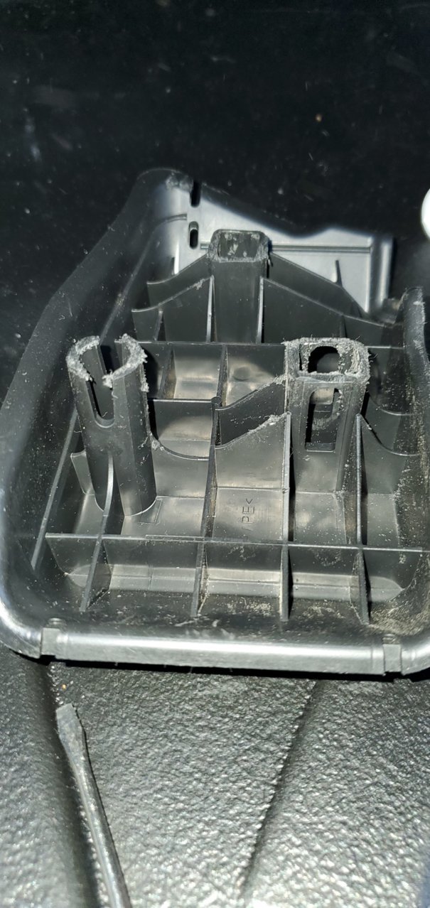

    Also fiddled with the rest pad/pedal since it was all wonky and didn't sit right after smashing firewall for the dirty cincos.
    Raised the top clip with washers and trimmed the pegs/feet on the pedal/pad.
    Now it sits pretty firm and straight
