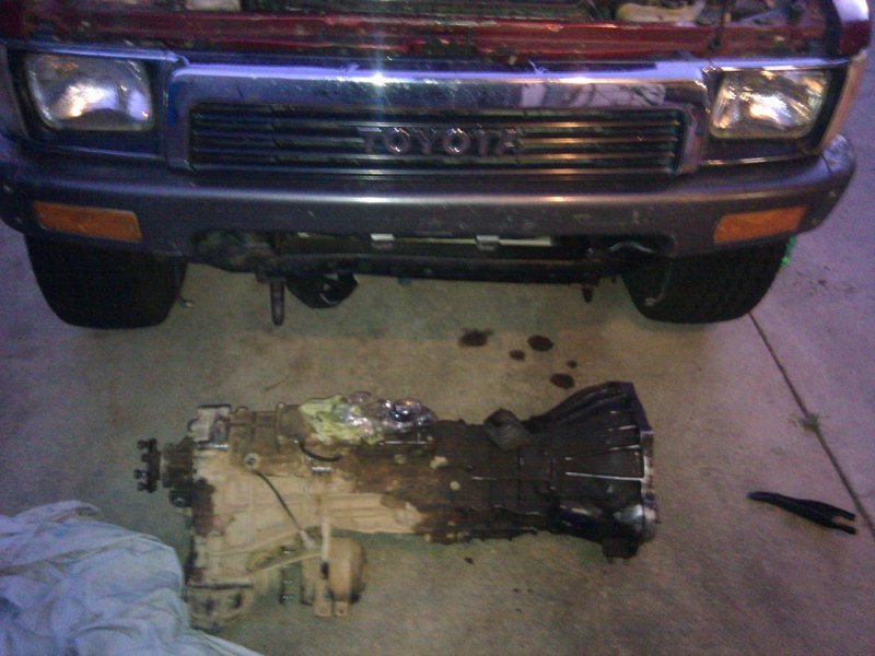

    Same here, Not a 1st gen but I did the clutch on my 91 4Runner 4x4 with hand tools a Kawi impact wrench and 3 jacks, I was able to get it out by myself but needed a friend to assist putting it back in.
    If I had to do it all over again I would take it to a shop, unless I had a lift, power tools and a trans jack otherwise F-that noise.
    To get to the top trans bolts I had to combine all of my extensions, about 2.5 ft roughly.
