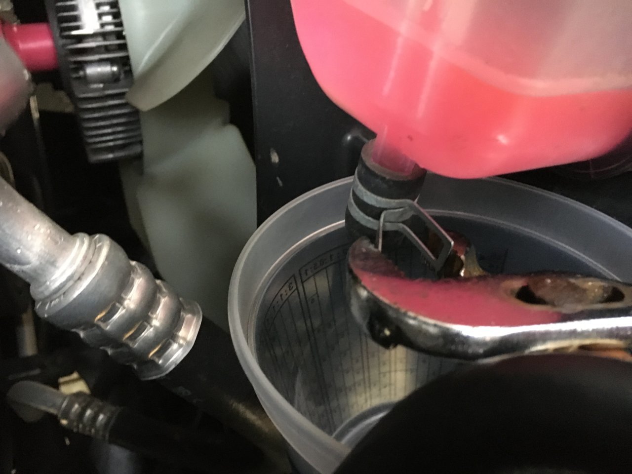

    Excellent write up!!:cheers: Just finished mine, Took about an hour & used just under 2 gallons of the Toyota SLLC. Was able to reach both engine block drains w a 2’ breaker bar and a socket joint. Only thing was I probably should’ve bought one of the cooling system funnel kits, pretty messy bleeding the air bubbles out. Ended up just holding a 16oz coffee cup under the radiator cap to catch all the overflow.

    Just did this today, easy to do (except putting the tubing on the drain on the driver's side) and the spill proof funnel was the key to not making a mess.

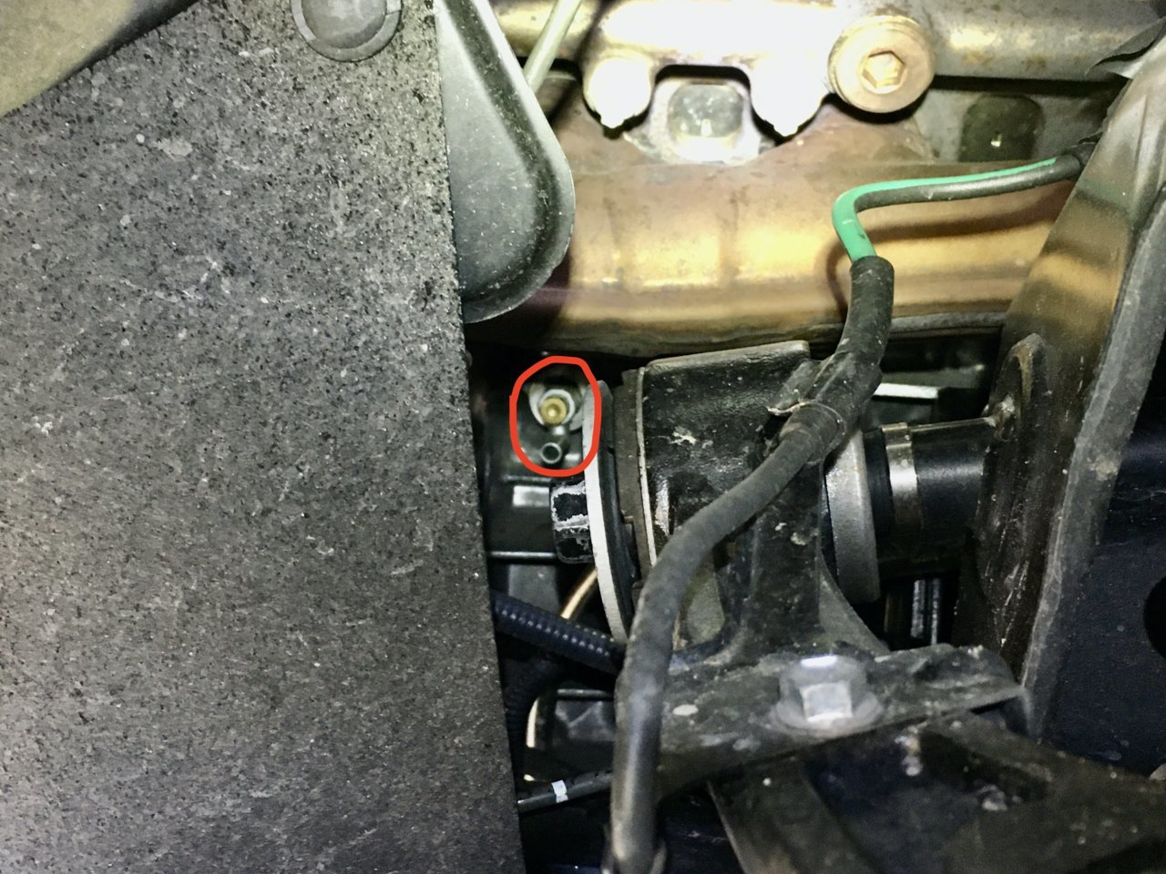

    Did this today on my ‘15 with 85k. Doubt it’s ever been changed. Used almost the complete 2 gallons but my overflow reservoir was at the low mark before I started.
    I opted to go for the Zerex because it was supposedly cheaper, but after striking out at 2 auto stores I found it at O’Reillys for $25 and just said why not. Toyota quoted me $29 a gallon so I’ll just go that route next time.
    I was able to use two small extensions and get the driver side loosened from inside the engine bay. Other than that super easy.

    Great tutorial, thanks. Hardest part was the driver side hose and plug. I had to fit the wrench in the way pavement.is.lava showed how.
    Almost all of the engine block's coolant came out of my passenger side. So when I finally drained the driver side, very little came out.
