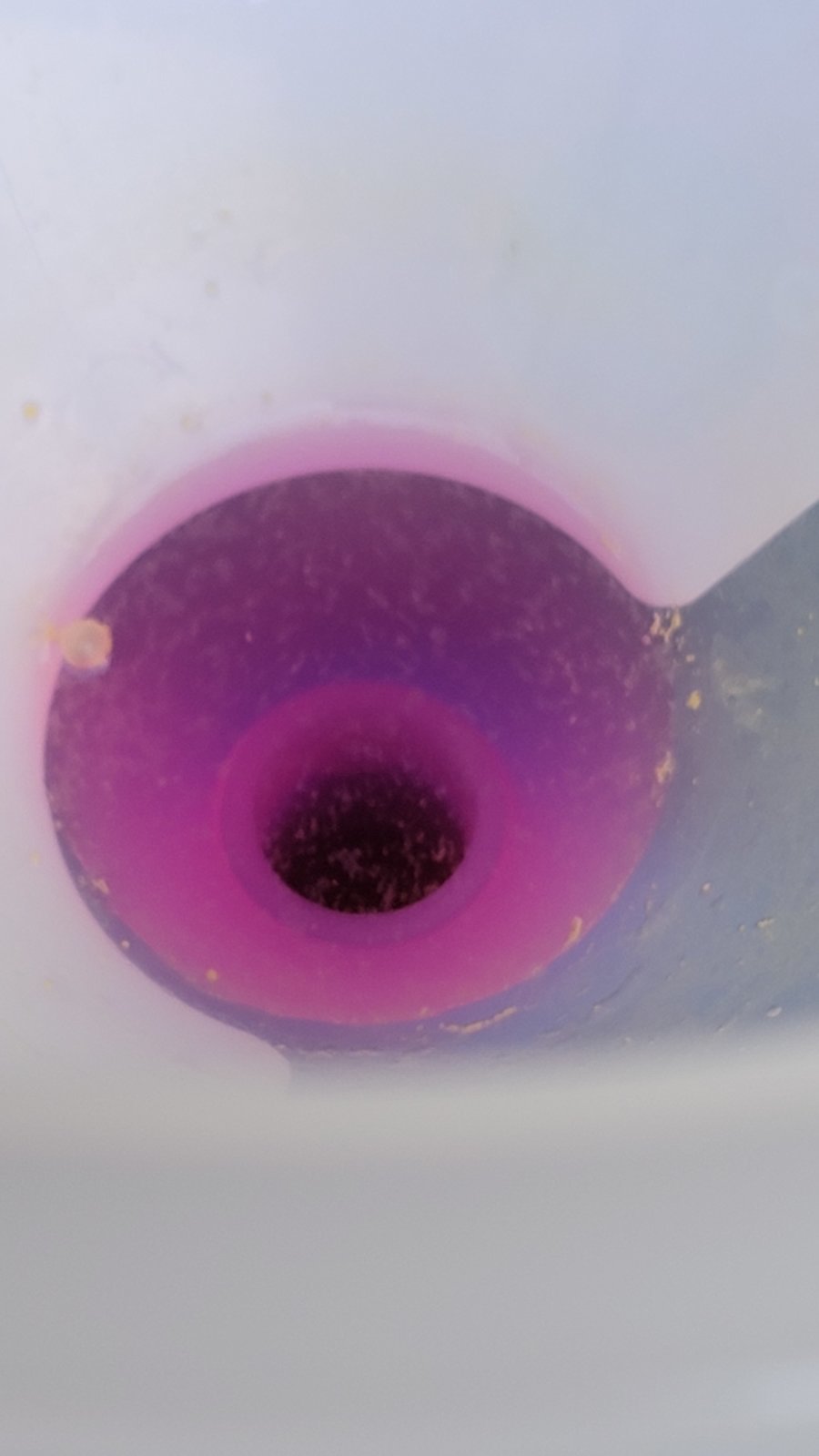

    Should I have any concern for this yellow pollen looking like substance coming up after changing the coolant?
  5. Apr 29, 2024 at 5:31 AM
    #65
    JustAddMud
    JustAddMud Professional Grease Monkey
    Aug 20, 2012
    #85169
    1,708
    J
    Summerville SC
    12 4x4 TRD OR
    Yes
    It's probably just what you say it is, pollen. Hard to tell from the photo but it doesn't look like oil bypassing the head gasket. With the engine running and the nose of your vehicle elevated slightly, are you witnessing tiny bubbles forming in the coolant? My money's on pollen.

    Hopefully normal, I noticed the same type of thing when I changed mine a few months ago. I was planning to change it again before the end of the year just to be extra safe since the process was easy enough.
  7. Apr 29, 2024 at 9:17 AM
    #67
    Walakazoo
    Walakazoo Member
    Sep 5, 2017
    #229143
    15
    2012 Silver Tacoma PreRunner SR5 V6
    Thanks for the reply. I did have the nose slightly elevated and did get a bunch of bubbles when going through the process. I'm not too sure about tiny bubbles forming. I do park under an oak tree so it's definitely plausible that pollen has found its way through the entire vehicle over the years. So far, I haven't had any issues since draining and refilling.

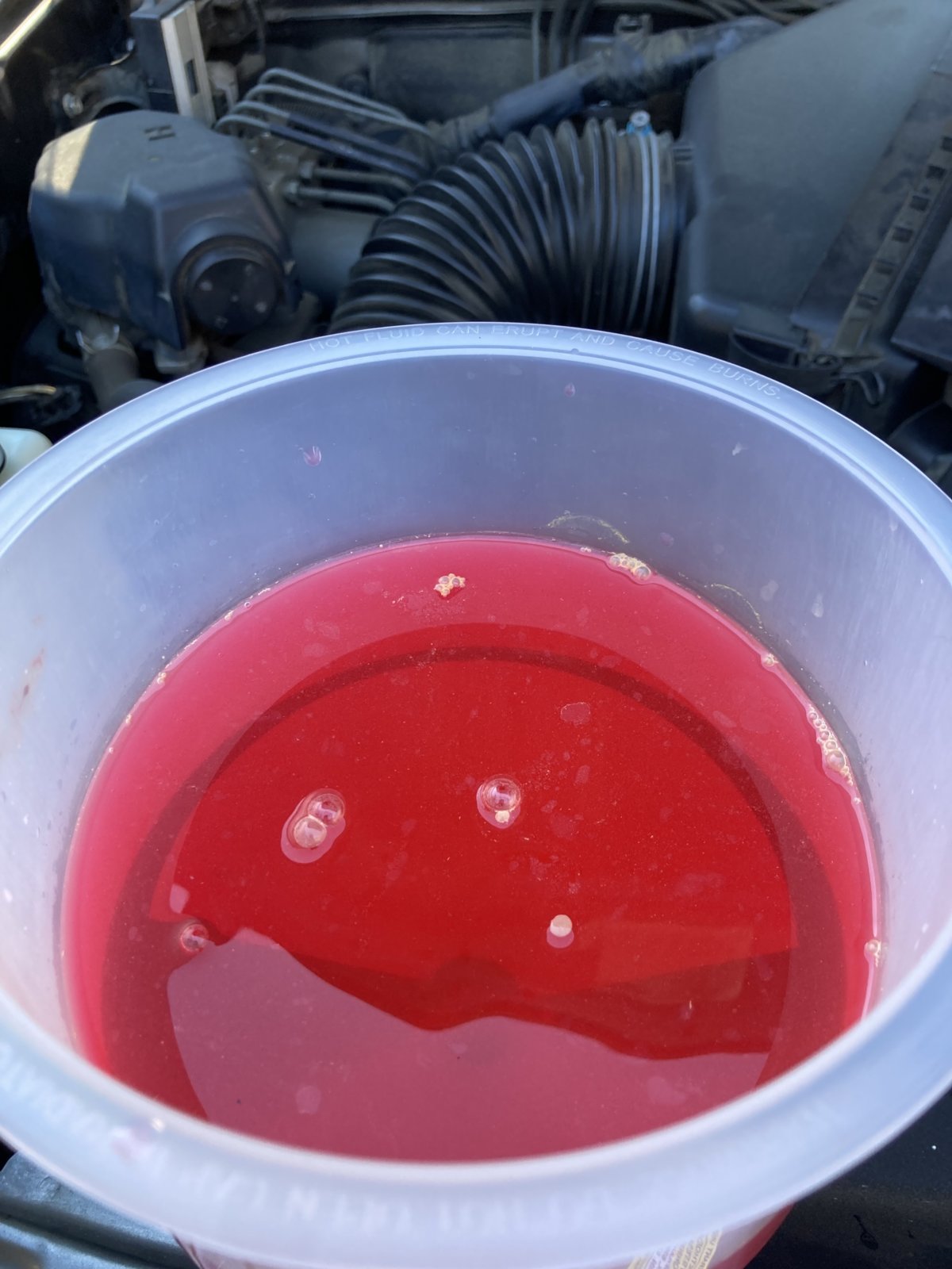

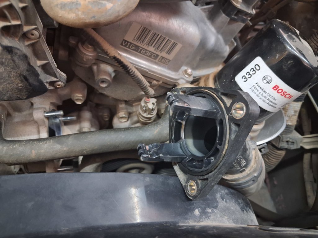

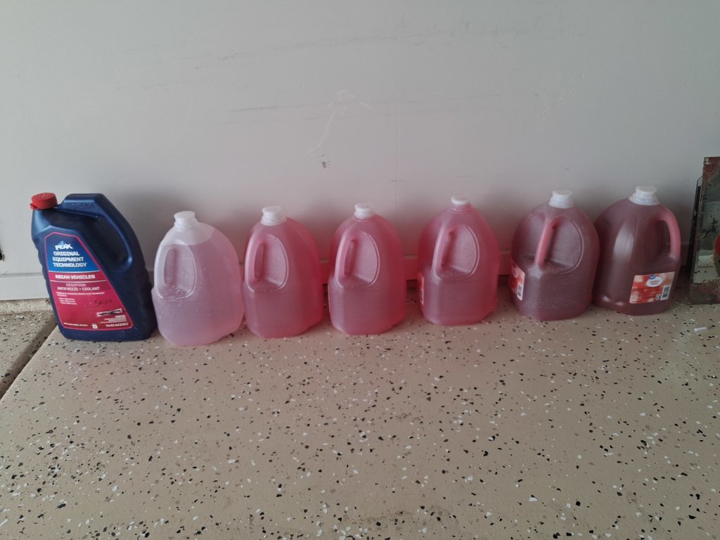

    Did the coolant flush on my 2015 v6 AT today. I decided to get a new thermostat too since according to the carfax it was done at 100k miles and I'm at 197k now.
    Ended up removing thermostat from housing so I could flush distilled water without having to wait for it to heat up each time. Saved time and was able to get a thorough flush that way. Thermostat was easy to pry away from the two holding clips.
    Bought 7 gallons of distilled water, 1 gallon premixed peak Asian pink coolant, 1 gallon concentrate pink coolant.

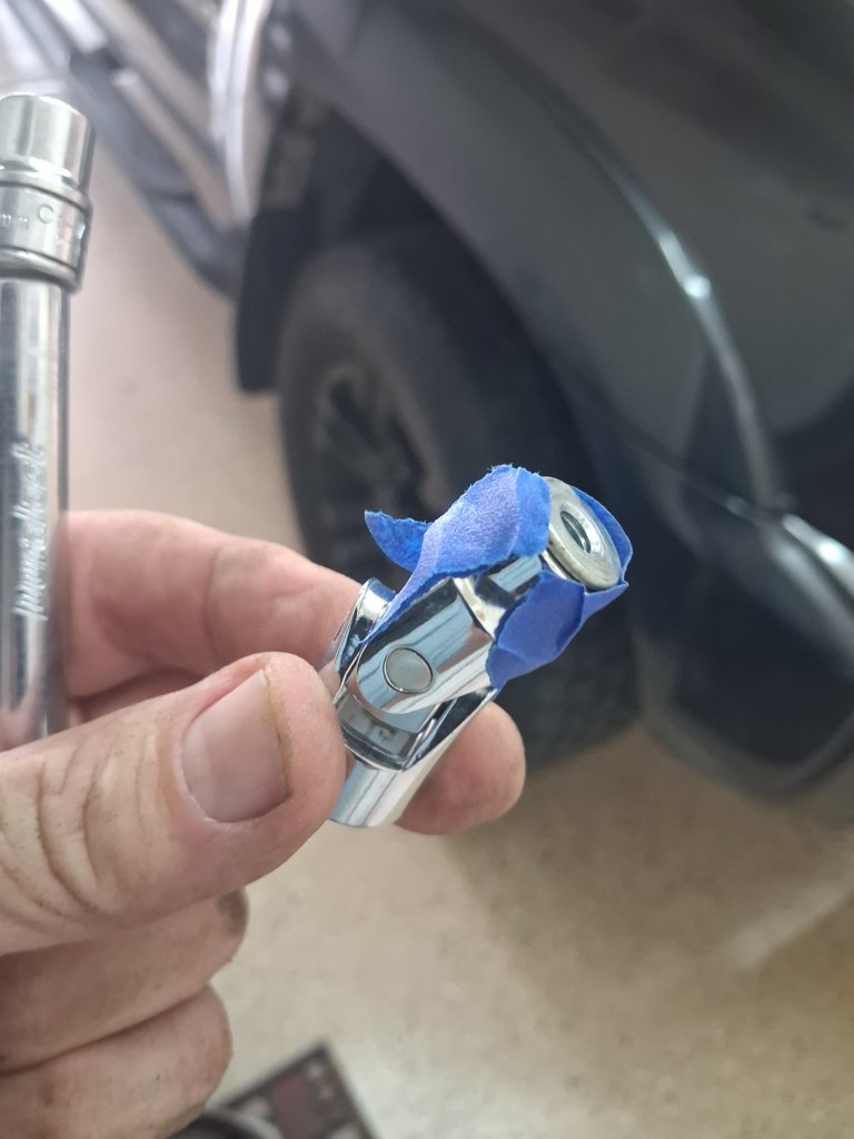

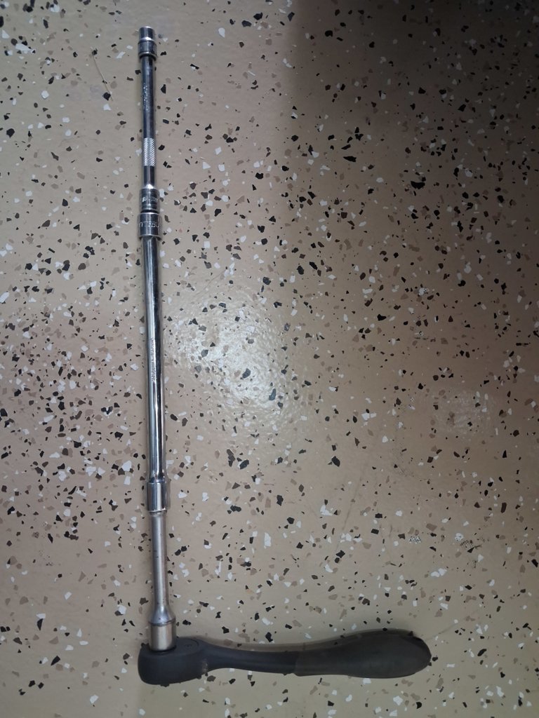

    Drained almost 2 gallons using the radiator drain and the passenger side block drain. Didn't drain the driver's side since everyone says it doesn't drain much at all and it's tougher to access. I used this set of tools for block drain, last extension has a wobble tip on 10mm socket.
    Here's the coolant progression, 3 cycles of distilled with just a hint of pink after 6 gallons went through.

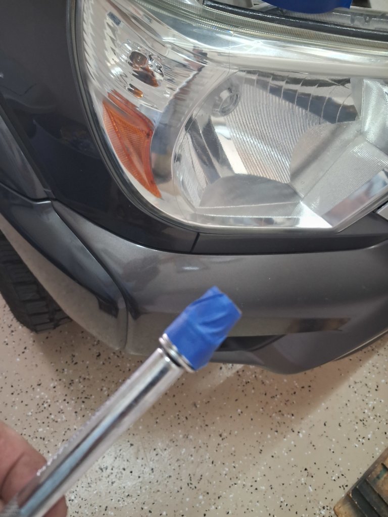

    I put a wrap of painters tape on the sockets and thermostat nuts that are hard to get to so I wouldn't have to search the chassis when they drop into the abyss.
    Took the clamped plug off the coolant tank, drained what was in there, replaced the plug, filled with distilled, then drained it again so it would be clean for fresh coolant.
    Ended up with 1/2 gallon of distilled left and 1/2 gallon of 50/50 coolant left.
    Took about 2 hrs.
