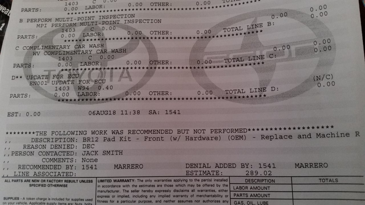

    How do you know what you got, all mine says is ECU update?

    Assuming you are due for the latest update, you cannot load a non-current calibration in, the update program verifies the latest file is downloaded and if not, informs you there is a more recent choice. It won’t let you load an incorrect file, either.
    Chances that you do not have the latest calibration after a recent update are very slim.
