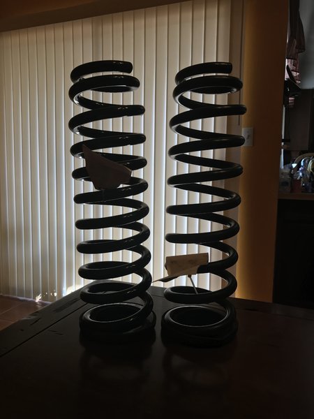

    My V6 coils came in yesterday but I'm hesitant to put them in. Tags have the right part numbers on them so that checks out but they're a little different from each other and that's what worries me. For one the finishes on them are different. One is dark black & glossy and the other is more washed out with a flatter finish. Also as you can see one spring is coiled up a little tighter than the other. It makes sense I guess since it's the driver side spring but I just expected them to be identical.. What do you guys think? Just install them or hold off? I'm gonna call the dealership I got them from on Tuesday to try and get some info but I wanted to run it by TW first.

    Eh I think I'll just put them in..

    Looks fine to me. The extra coil being on the drivers side is normal. More weight on that side

    I'd check b4 tackling installation. I hear installing the V6 coils on the 2wd are a pain, especially if you're replacing ball joints, tie rod ends, and bushings, (if needed) which is a good idea since you're gonna dismantle the suspension to complete the swap.
    Those appear to be a bit tall; you might be able to confirm, I believe the Moog website has dimensions of coil springs.

    I'm gonna push it back to next weekend on second thought but I'll keep the thread updated with info. You think you could post a pic of your coils for comparison?
    I'll be calling the dealership I got them from on Tuesday to try and get some info. Hopefully they'll be able to clear things up.

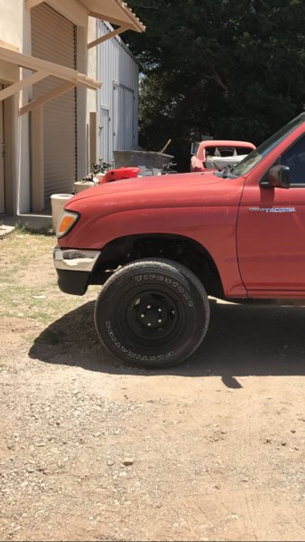

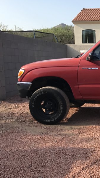

    I actually forgot to take pre-measurements so the best I could do was measure both sides with one side complete and the other side 'stock'. The completed side was exactly 1 inch taller.
    Before and after install. The camera angle might be a little deceiving.
