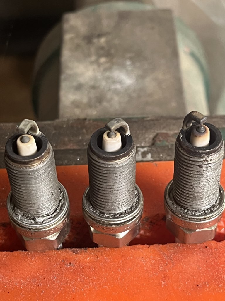

    Update: I went to the dealer and bought new OEM copper Densos. When I pulled out the Denso iridium’s, with only 4500 miles, I think the technical term is SMOKED! The .044 gap on the Iridium's is now .075+, they are completely shot! I honestly don’t know how the truck ran as well as it did.

  10. Aug 7, 2025 at 1:14 PM
    Peter603Taco
    Peter603Taco Well-Known Member
    Sep 13, 2022
    #405709
    394
    Peter
    New Hampshire
    2013 TRD Sport DCLB
    Yeahhh something isn't right lol. They should obviously be lasting wayyy longer than that. Throw the OEM coppers in and see how they last I guess...

    Looks like the iridium points came off. They are probably sitting in the cat now. Not good. I've been running NGK Iridiums for about 10 years. They still run flawlessly.

    Iridiums require more voltage to spark because they have higher resistance. Use copper plugs because it has much less resistance and is what the voltage of the ignition system was designed to use. You can get lucky with an ignition system on the edge of enough voltage to reliably use iridiums but not every time. It's not that hard to change plugs on 2nd Gen 4.0 V6. Regarding resistance, silver will be the least, copper 2nd, then platinum is way down the list (iridium is mostly platinum). They use silver plugs in race cars but only get a few hundred laps on them. Great performers but lousy longevity.

    I wouldn’t say that the points came off, they look like they burned away.
    I was very careful when I bought these plugs to be sure that they were genuine Denso. At this point they are either fakes, or my ignition system just didn’t like them. I had these identical iridium’s in my 06 V6 Tacoma with no issue.

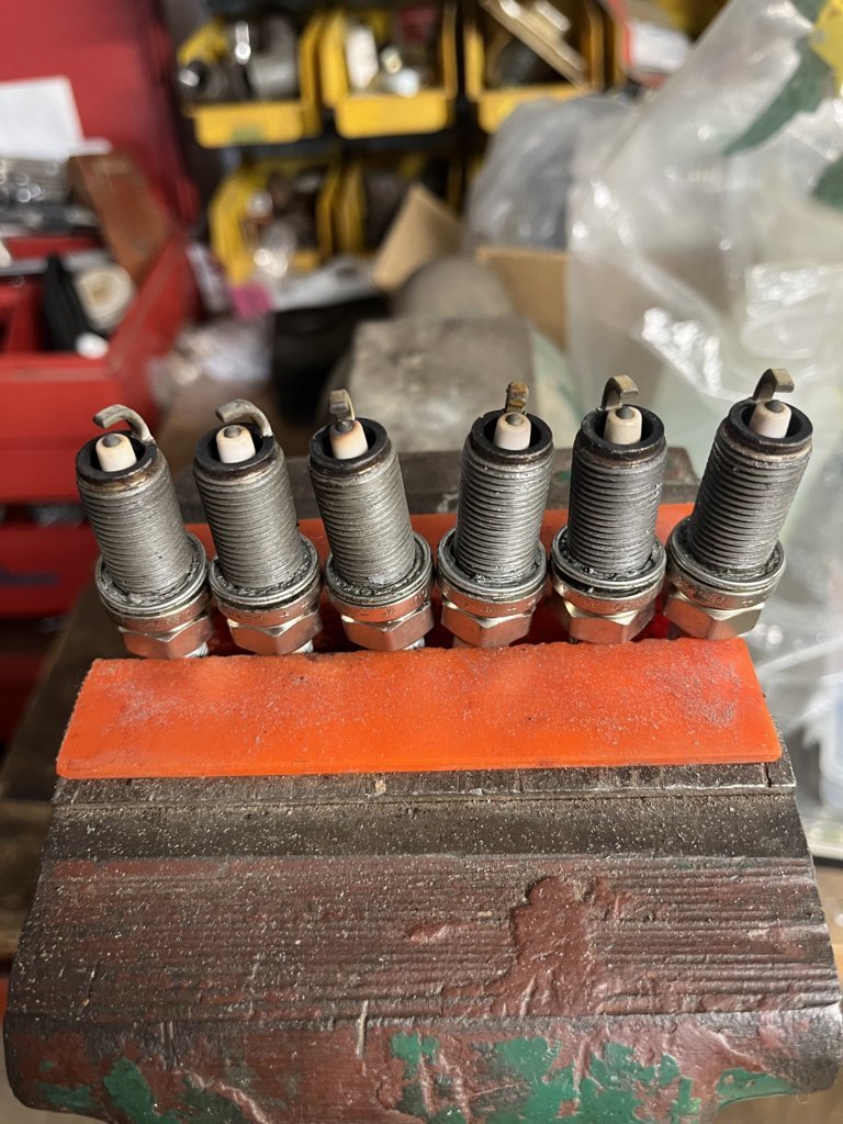

    UPDATE: I installed the last of the plugs, the miss is gone and it’s running like a top!
    Attached is a picture of the old plugs. Full disclosure, I miscalculated the miles on the plugs, they have 20,250 on them. A little more than the original thought of 4,500, but still way less than the 100,000 they’re supposed to last. They have been failed for quite a while, so the mileage when they failed is not exact.
    I sent an email to Denso customer service to see what they say.

    Glad your truck feels better, but I would still do a bit more diagnosing because iridiums should not look like that after only 20k. I would check the easy things first. Are they counterfeit? As crazy as it may sound, I have seen it before (https://assets.denso-am.eu/production/attachments/Spark-Plug-Counterfeits-Poster-English-upd.pdf). What is the part number? Are they the correct heat range? After that, I would look at your fuel trims. With electrodes worn down like that, you could be running lean. Monitoring fuel trims can point you toward a vacuum leak, fueling issue, exhaust leak, or other problem that could cause the plugs to see hotter conditions than they are designed for, which would lead to the type of wear you are seeing. I run iridiums on my Tacoma and have pulled plugs at 80k that had minimal to no additional gapping from the pre-gapped spec of 0.044 inches.

    I am familiar with the fake Denso issue and I thought that did my due diligence before I bought them, maybe I was fooled.
    According to the part number, these are the exact same plug but with an iridium tip. I can’t comment of fuel curve and I know of no vacuum leak. I would have expected a rough or erratic idle if I had one. I did have an exhaust issue, my muffler rotted out from sitting. I don’t think that I put on more than 30 miles once I discovered that.
