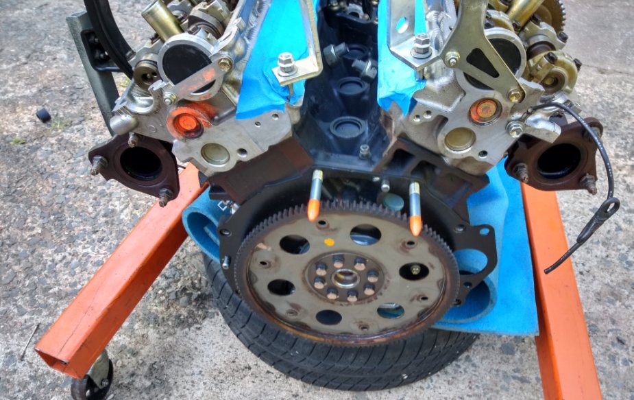

    Leave the exhaust manifolds on if you're worried. Disconnect it from the back. Then attack them on the bench.
    It sounds like a failed gasket to me, I'd buy a kit and start the tear down.

    So take out the 3 studs/bolts on the manifold flange that ties it to the crossover pipe? Didn’t think of that approach. Worth buying all new exhaust studs given the miles?

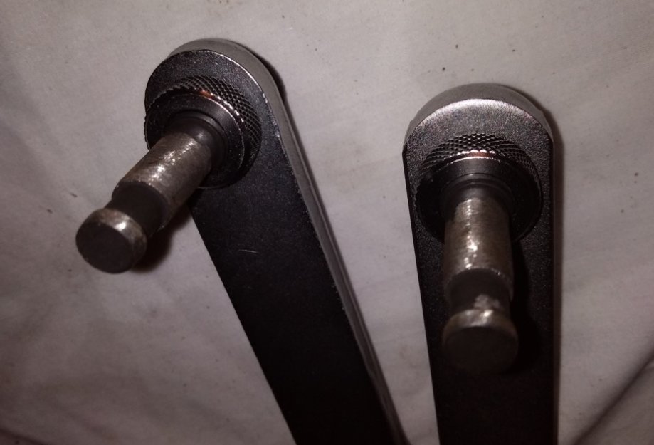

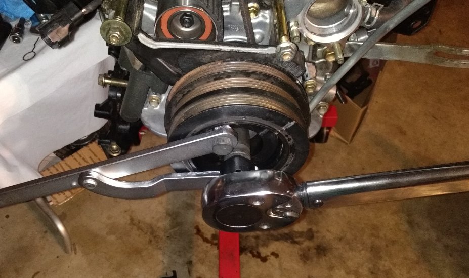

    ^^^ Yep. I did an engine swap with exhaust manifolds attached and the cross-pipe removed.
    I'm sure you know to have the engine set on TDC before you start?
    If you don't have a tool for timing pulleys, I had good luck with the tool in this video. I used the one tool for all pulleys.

    Buffed down the larger heavier pins to use on the crankshaft pulley.

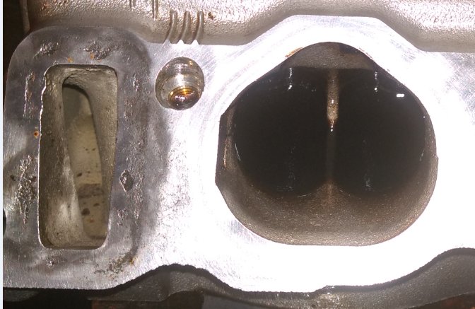

    One last question, when you had the intake manifold off, did you have any pitting around the coolant ports that could be leaking now?

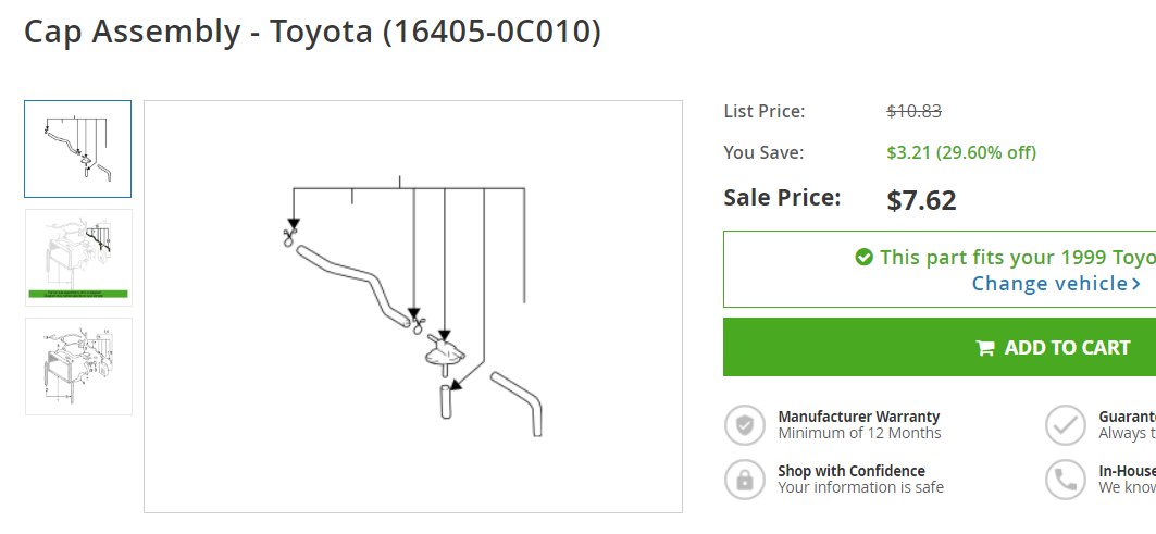

    Haven't had the issue on my Tacoma but on my LC when my reservoir was filling up and then not backflowing into the radiator as it cooled down I bought a new one of these. System needs to be airtight to work properly I believe, if not it will suck air in before sucking the coolant back out of the reservoir. I figured for the money it was worth a shot before getting elbow deep. Seems to be working so far.

    Thank you for all the replies! Giving me a lot to think about. Just ordered the Carbon monoxide tester and the new overflow cap/hose kit. Hope the $7 part fixes it but I know it's a longshot!

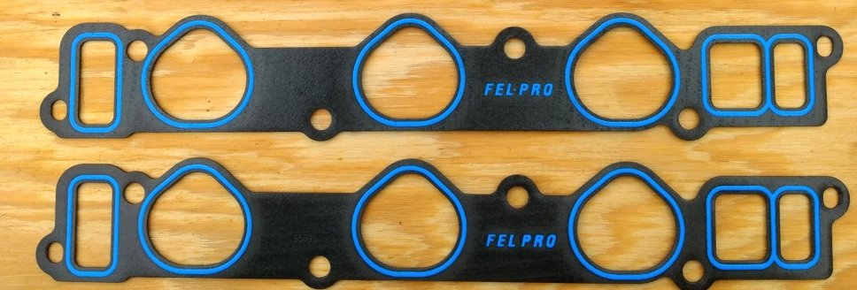

    CS_AR: My coolant ports were not THAT pitted but I don't recall them being perfect. Might be worth another teardown to check. I did use new OEM gaskets there as I had some suspicions. Not sure how forgiving those gaskets are but the old ones were definitely a problem and had been re-used. Any ideas on fixing those if needed? Belzona and a good polish afterwards?

    If yours aren't too bad, I doubt that's the problem. Check your other head gasket and coolant items first. I've dealt with pitted coolant ports on other aluminum head engines over the years.
    I polish then the best way that I can with a Dremel tool brush. I've had good luck with a gasket that uses a silicone seal for imperfect mating surfaces.
    Its the same surface seal concept as the new and improved OEM water pump gaskets.
