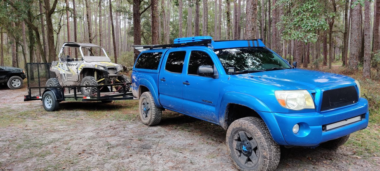

    For what it's worth, I have a similar setup as youc but I have the V6 2" lift, 31" tires and NOT loaded up for camping I get average 16 MPG mixed 50/50 hwy/city. On this trip towing this SxS on 6x12 trailer I average 12 MPG. I'm not sure how people manage better MPG than me with similar setups because I drive like a grandpa and don't exceed 65 MPH because more than that is more than 2k RPM and i'm not a fan of losing MPGs.

    What gears do you have? You definitely don't have aerodynamics working for you, and all terrains aren't great for milage either.
    EDIT: It could be other stuff too.

    Stock gearing, only running 265/65/17s so they're not causing any problems with gearing. ATs and the lift definitely are the biggest thing along with the roof rack somewhat but it's relatively flat except for a solar panel 24/7. Only have the traction boards when out on trails because I don't want to take the hit to look cool on the streets. I doubt OP will be getting 17-19 MPG with an identical setup with the V6, it's meant to go forever not exactly efficiently lol
