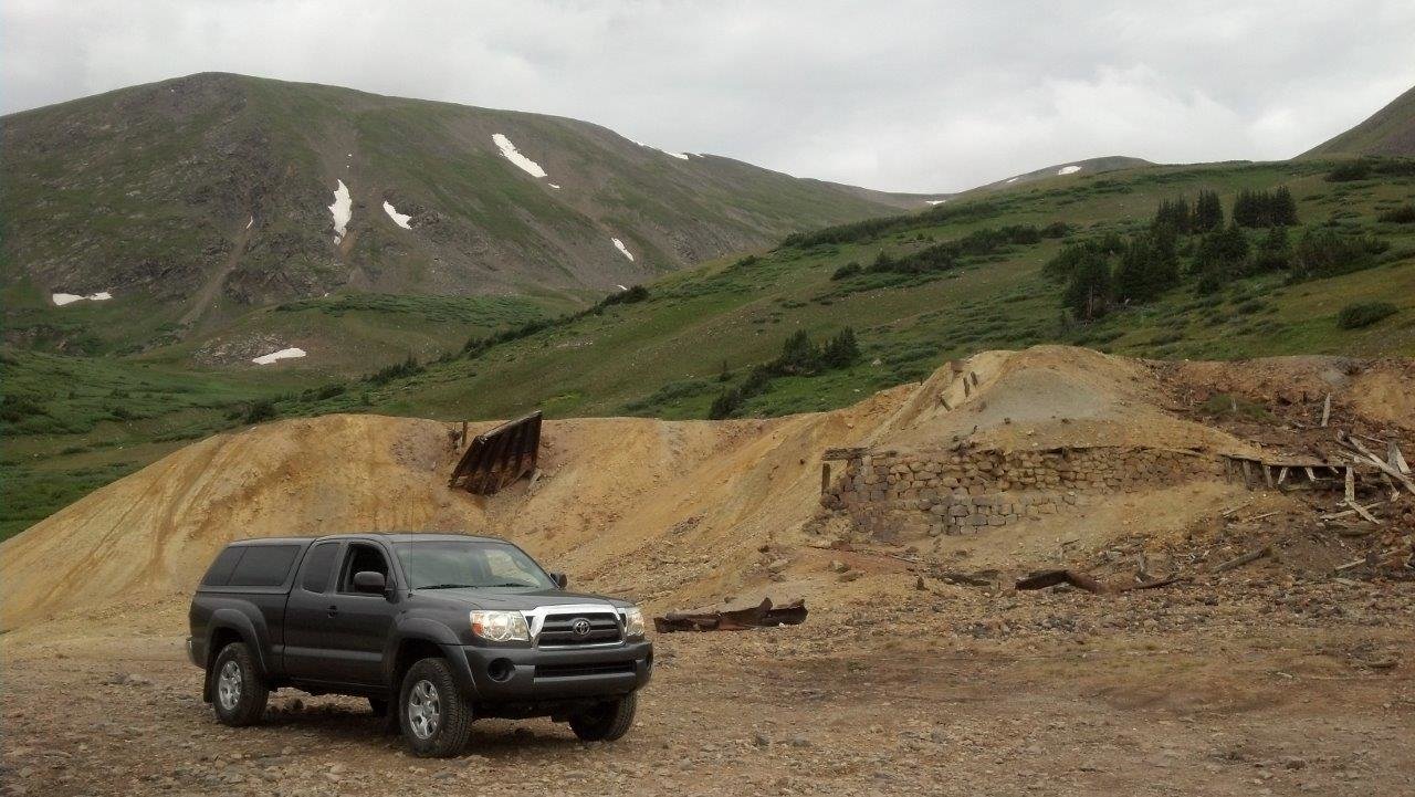

    09 Tacoma SR5 4WD 4cyl
    I have a 4 cyl 5 speed with an ARE shell and spend ~3 weeks a yr in CO on a hiking vacation. The 4 cyl is weak at sea level, and especially so at high elevations. It is fine on I-70 east of Denver on the plains. It struggles on I-70 west of Denver when climbing to the Eisenhower tunnel- I'm in the RH lane going ~45 with the flashers on. Yes, it will go faster, but I keep it at 2800-3000 RPM where it's happy. If you are going to drive the truck every day as your only vehicle, I'd recommend a 6 cylinder unless you just can't afford it. On steep dirt roads, even if they don't actually require 4WD for traction, I have to use 4WD low for power; I typically start in second gear and shift higher as necessary, because the truck doesn't have enough HP to climb slowly at lower speed / RPM at 10,000+ ft elevation where you're at a 30% HP loss vs sea level. You will have no issues with the 4 cylinder on dirt roads in 4WD low, but on the interstate it's often underpowered. It's not bad on most highways where the speed limit is 55- I only occasionally wish for more power on some of the high passes. The good news is it gets pretty good mileage; I've gotten as much as 25 MPG in CO and I typically get ~21 MPG at home.
    Edit- I reread your post. If this is a secondary vehicle, my Tacoma is secondary for me, then I wouldn't worry and get the 4 cyl and save some $. This was my justification on the 4 cylinder. You can't be in a rush climbing passes as I said. Do not worry about excessive engine wear or strain; just keep the RPMs at a sane level, as I said and you'll be fine. I bought my truck new, it has ~115k miles on it, and I rarely exceed 3000 RPM as the giant 4 cylinder gets very buzzy.
    at the Waldorf Mine, ~11,600 ft
