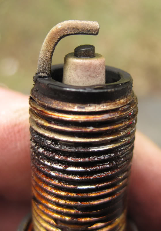

    Just changed the plugs on this truck. it has never been done before. Here is what they looked like.

    They look good should be tan .

    Yea i was a little disappointed that they never have been changed before, but they where still half and half. the NGK is the top one. I put 6 Denso in from the dealer.

    what was the gaps on the used plugs?

    must feel like a new truck!
    Is that oil on your plug?

    Wha....?? Better look again. :D

    Well they are not black no signs of oil and there are carbon deposits which are normal what are u talking about.

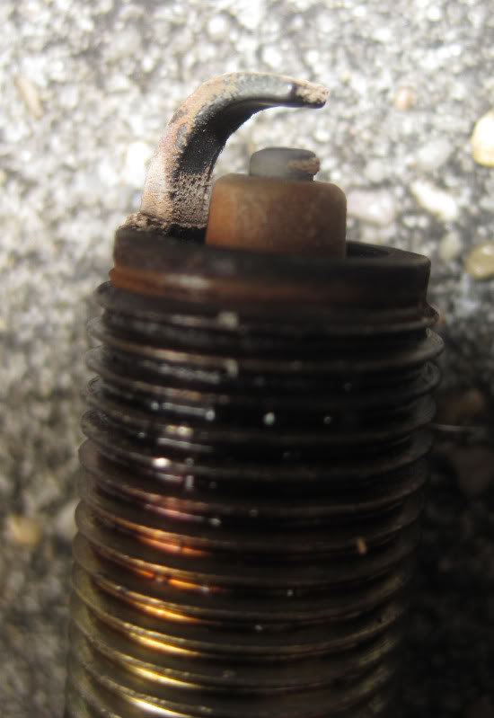

    I just picked up 6 Densos for my Taco. 122K on originals. I'll post pics of the ugly ones.

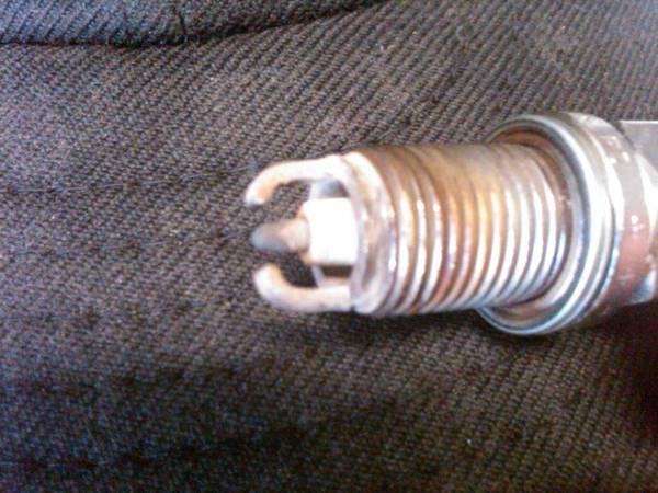

    I bought my truck used about 6 months ago with 62k on it. The 3 plugs on the passenger side were NGK's and the 3 driver side were the factory Denso's. The picture is of the factory ones. The NGK's weren't as bad but why would someone only change 3 of the plugs?

    toyota puts ngk on passenger side and denso on driver side from the factory. your plugs have likely never been changed.
