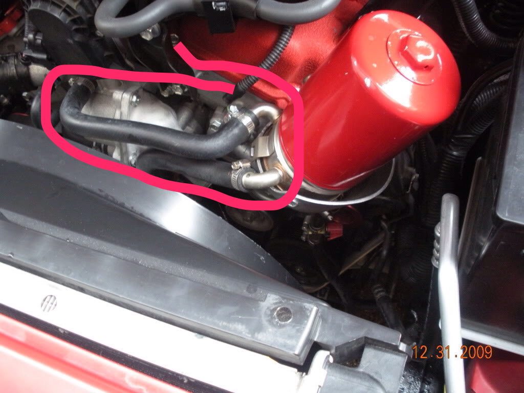

    The engine oil cooler is part of the tow package. Although most TRDs came with the tow package, not all did. It’s a completely separate option.

    The tow package includes a transmission oil cooler if the truck is an automatic and a engine oil to water heat exchanger(oil cooler). The circled part in the pic is the coolant hoses for the engine oil cooler.
