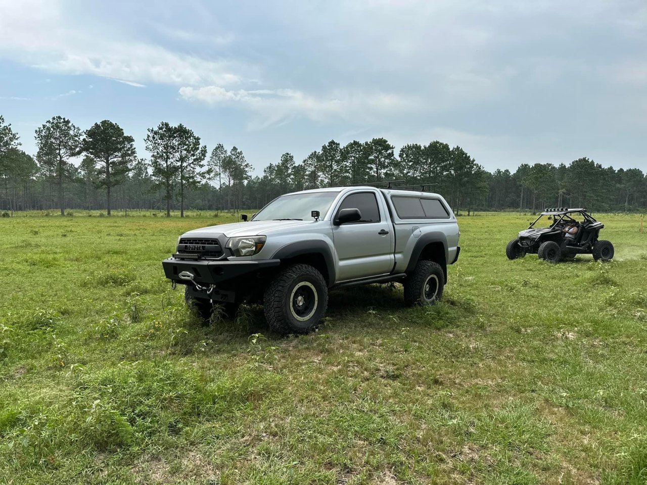

    I have a 2013 Regular cab 2nd gen, I have done everything to this truck that I have wanted to do, but it seriously lacks power and I am not driving it as much because of that.
    Onto my question folks, does anyone know of a shop in or around Houston that is willing to do a 1GR-FE Swap or if anyone has ever done one.
    TIA.
