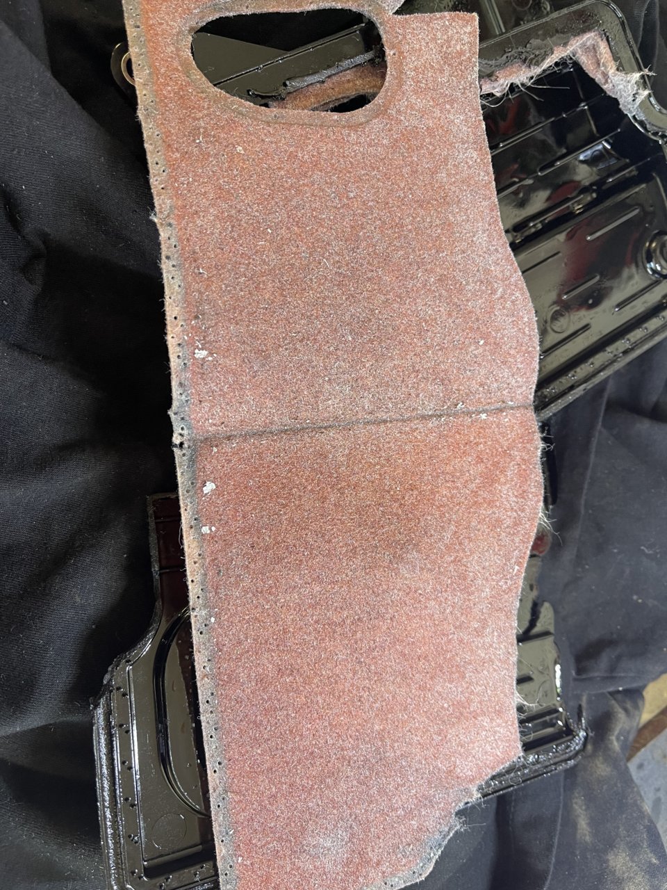

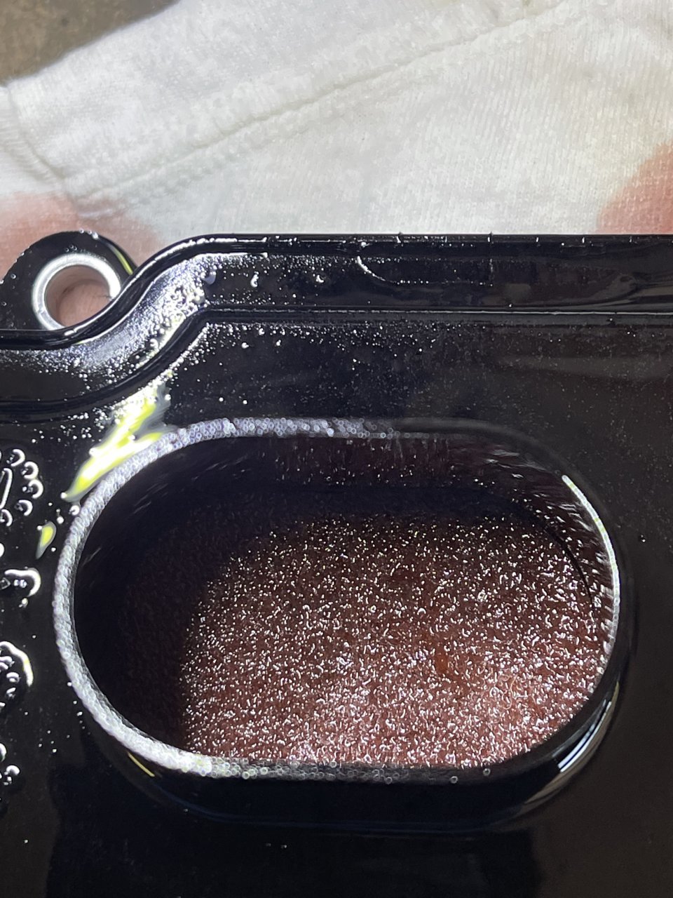

    Def a filter in there but probably can go at least 100k imo before changing
