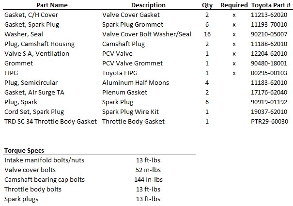

    Here is a snip from a spreadsheet I put together for this job. Keep in mind my idea of "required" may not be the same as yours.

    Only 2 camshaft plugs needed? I see another that said 4 needed
    Only 2 needed

    I haven't done this job yet, but do believe there are 4 "half moons" and only 2 camshaft plugs. One on the back side of each valve cover

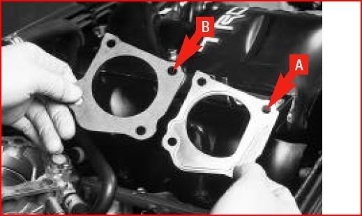

    @ekul310 I am doing this job soon and have a list of parts to, a few people told me to get the TRD SC gasket but I am not supercharged so is it even worth me doing that? I have the part numbers 22271-62040 for the throttle body gasket itself and 22215-62180 for the throttle body cover gasket.

    The difference between the two can be seen in this picture:
    A is the stock, naturally aspirated version
    B is the TRD gasket for the supercharger
    The throttle body on your truck is a circle, not a "D" shape. It's your call.
