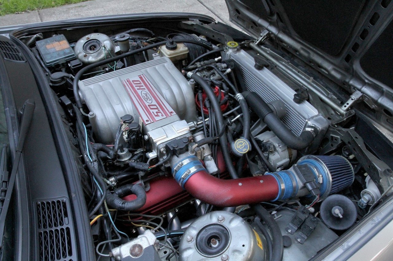

    Too cool! Then you will enjoy seeing my 325i with a 5.0
    Was a tight squeeze and cheap to do. Well not cheap in hours spent, but super fun to drive.
