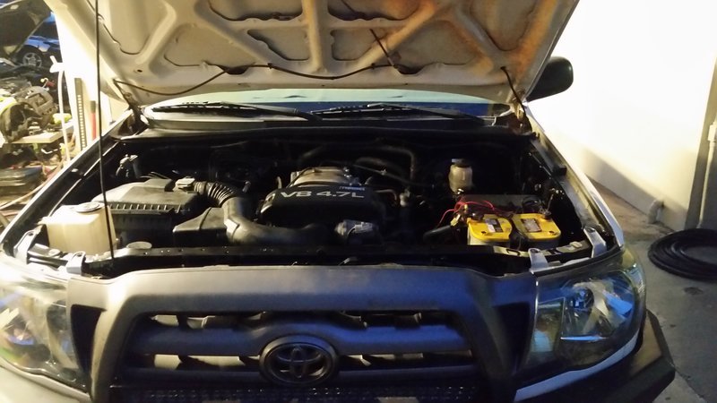

    What's up guys just thought I'd share my 4.7 Iforce v8 swapped regular cab taco. At the same time are there any others out here with a 4.7/5.7 taco?

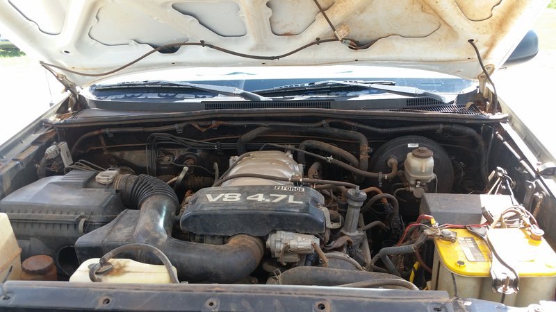

    Sorry been busy
  13. May 22, 2017 at 9:29 PM
    v8taco671
    v8taco671 [OP] Well-Known Member
    Apr 2, 2017
    #215117
    156

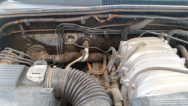

    All the harness ro the fuse box and fuel lines are in factory location

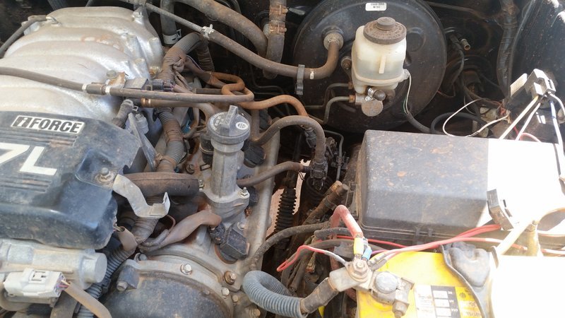

  14. May 22, 2017 at 9:31 PM
    v8taco671
    Apr 2, 2017
    #215117
    156
    Harness to ecu and AC lines all in factory location
