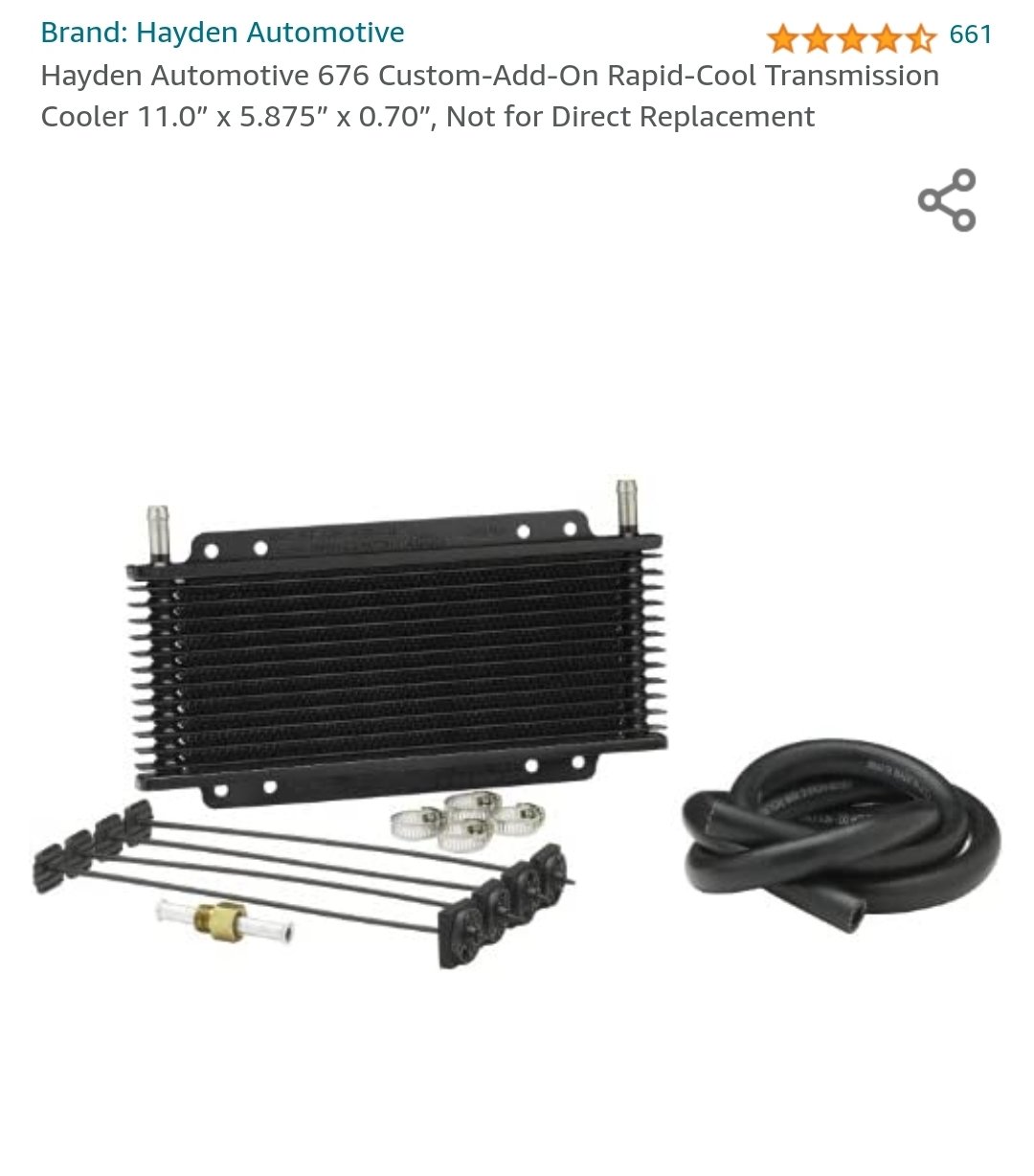

    Tranny cooler perhaps? Blowing a tranny and "burning it up" from a urd super charger is a pretty poor and vague description.
    Normal driving I see about 160* from the transmission pan. Spirited driving it gets up to 180*-190*. I have a large aftermarket transmission cooler and the ratiotek shift kit. I remember seeing 210* before the cooler install on a hot summer day.

    In the market for a aftermarket cooler. ‘What trans cooler are you using? Any pictures?

    I installed this Hayden automotive cooler. It's about $40 on Amazon. I tapped it in line after the radiator cooler, just before the transmission.
