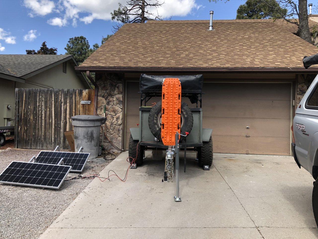

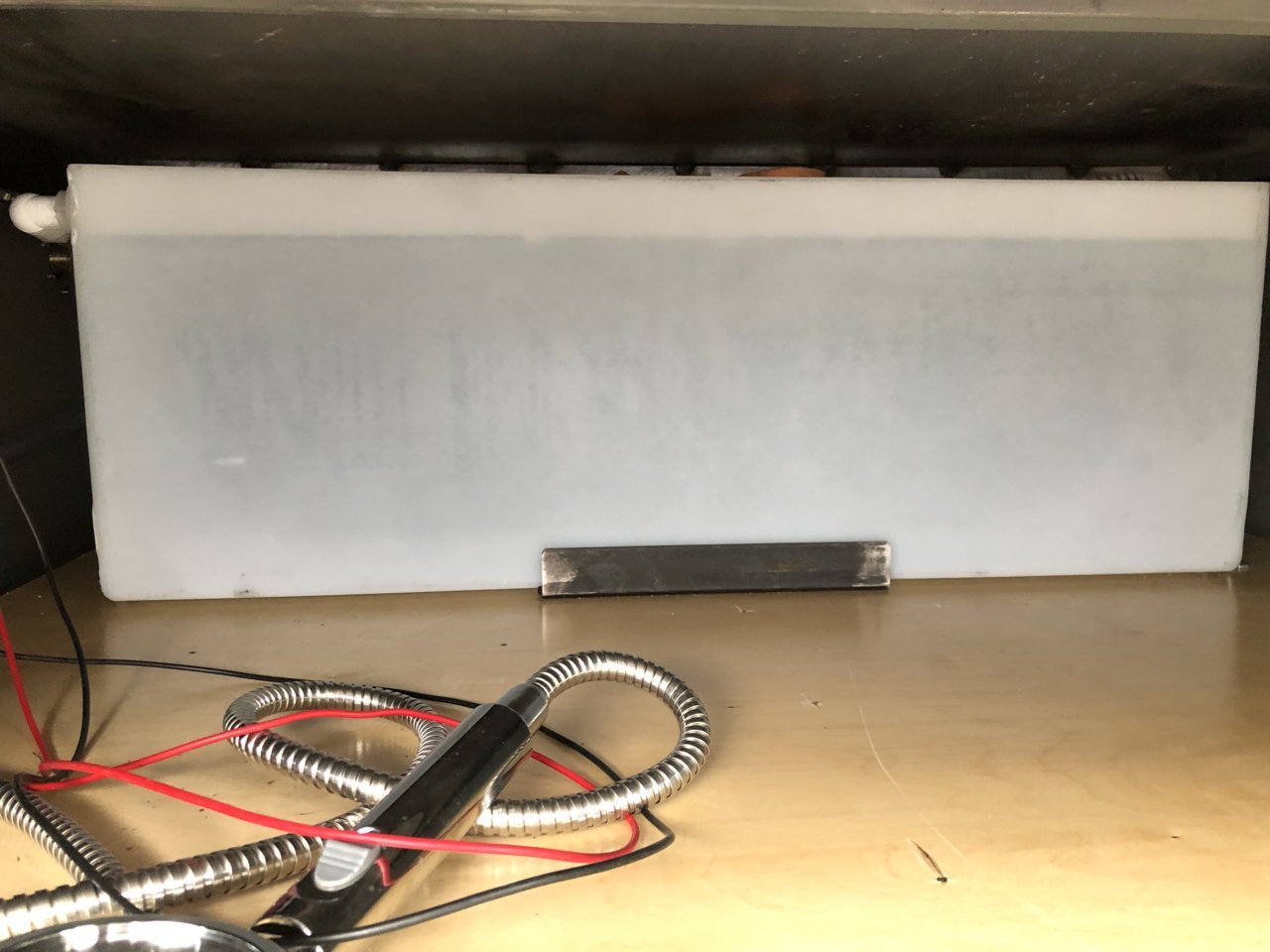

    Since I’m using this thread as a checklist for what still needs to be done, here’s what I need to accomplish by Thursday so we can head to Big Sur. I know this thing is built for much more than on-road use, but for its maiden voyage I prefer to keep it on street so I can troubleshoot any issues easier.
    Mounts for the hot water heater
    Breather hose
    Drain
    Connect H2O in final config
    Camp lights (waiting for Amazon)
    Propane bottle mount
    Solar mounts (possibly if I have time, probably just toss them in the trailer for transport)
    Seals on front doors
    Upper seal on rear doors
    Flip struts on RTT mount
    Spare tire Mount
    I’m sure I’ll add to this in the next few days as I figure out more.
    We leave for a week on the coast on Saturday but I’m trying not to work on this thing right up until we leave and give myself a day or two to pack and organize.

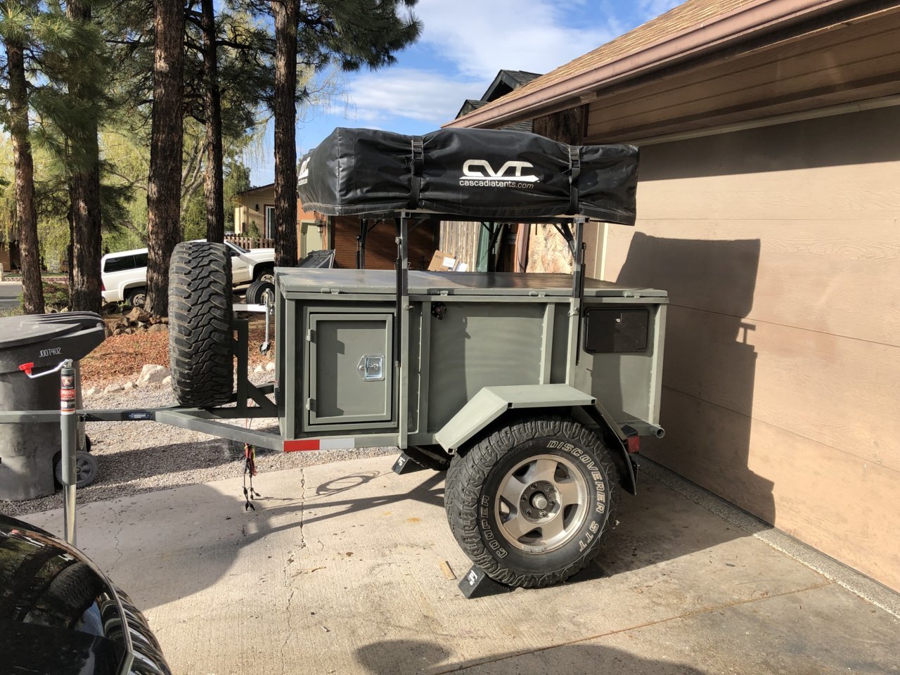

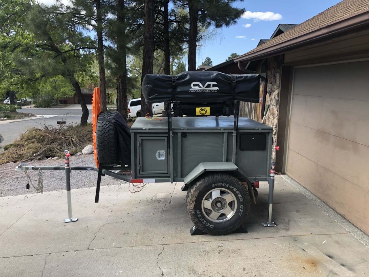

    Thanks! Sure I don't mind sharing the specs with you guys.
    Main lower frame box built from 2" square tubing 1/8" wall
    1 1/2" square tubing 1/16" wall (uprights for the walls)
    1"x2" 1/16 wall rectangular tubing (top rail)
    1"x1" 1/16 wall square tubing. (fenders and lid)
    Sides of the trailer are 16 Gauge sheet steel
    Floor is 14 gauge sheet steel.
    Main box: 4'W x 6'L x 2'h
    Tail to tongue length: 16' (Will be shortened in the future)
    RTT extended height: 78" fully extended to top of support bars
    RTT collapsed height: 64" to top of support bars

    The list is getting shorter!

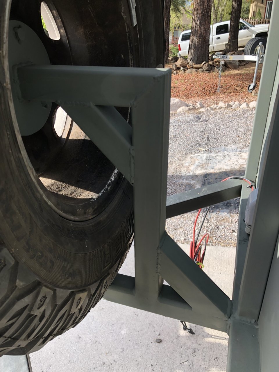

    I got a ton done yesterday, fabbed the spare tire mount, hooked up all the H20 where it needs to be for good, made a latch catch for the front doors, Got the drain, breather, and overflow all squared away.
    Maybe this afternoon I'll have some time to do a few more things.

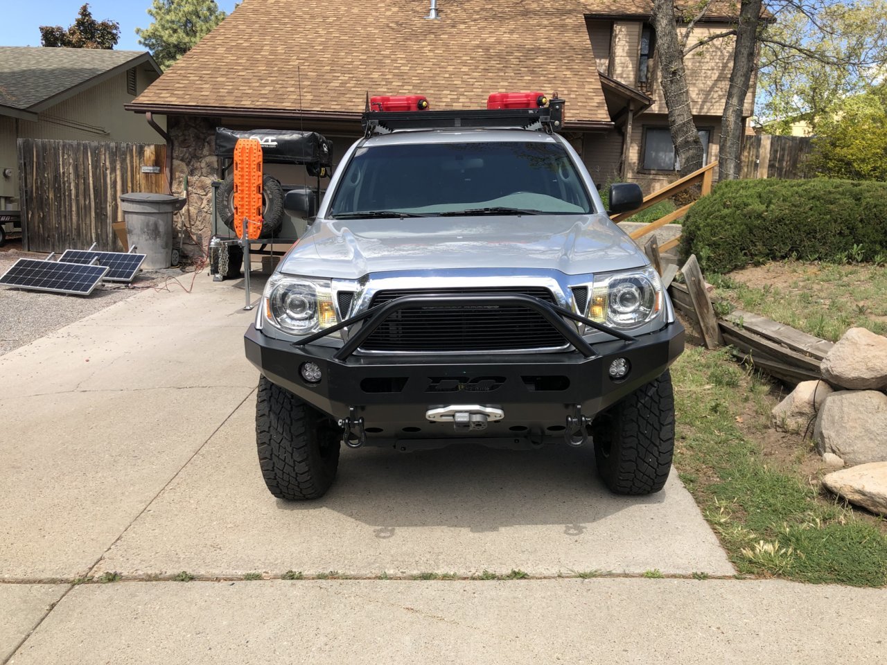

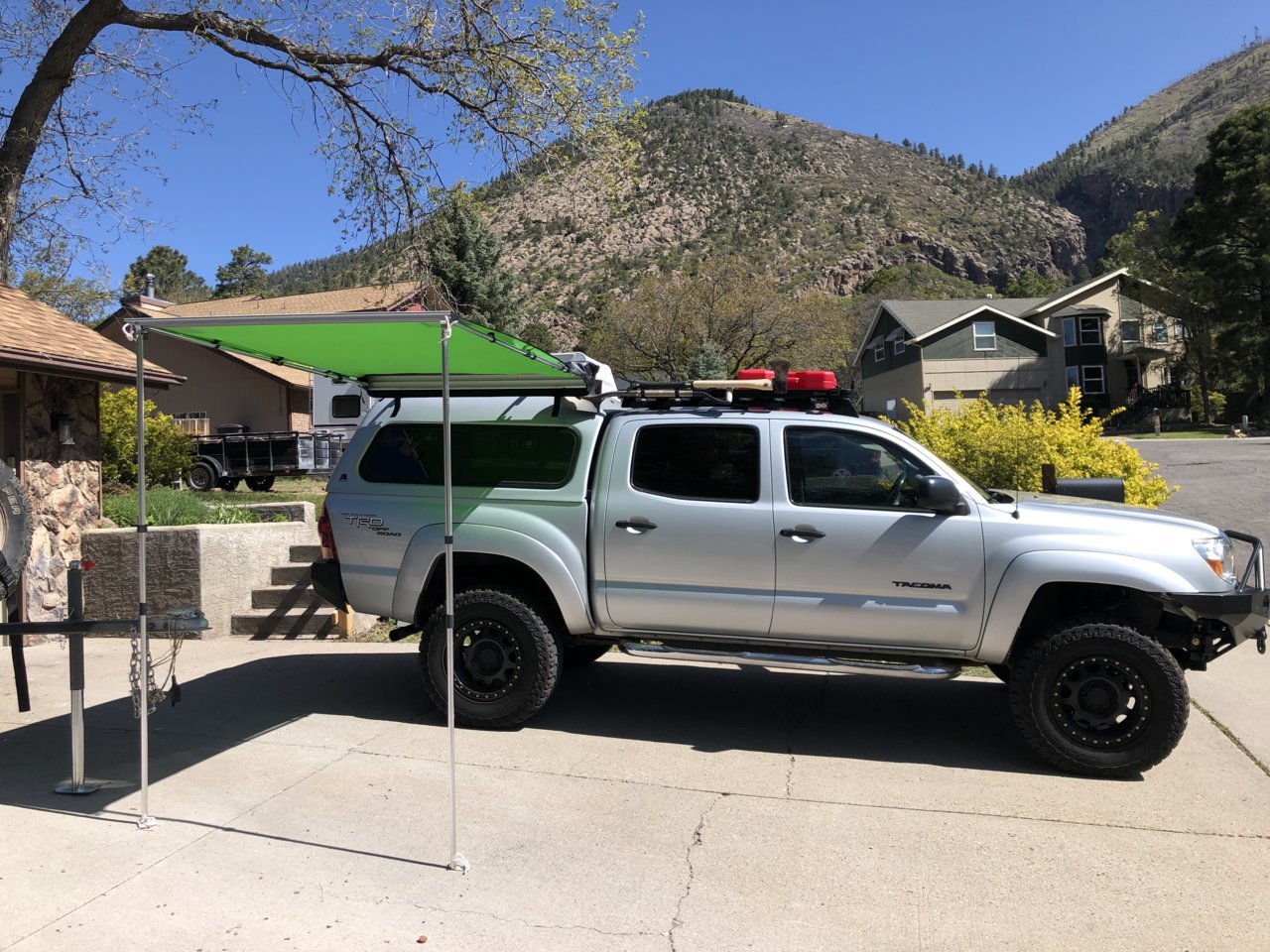

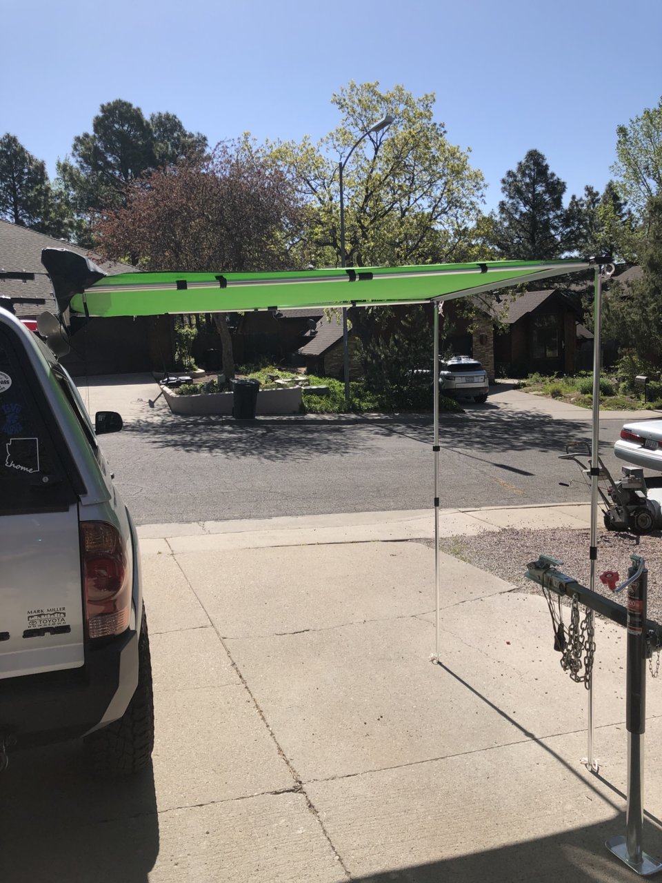

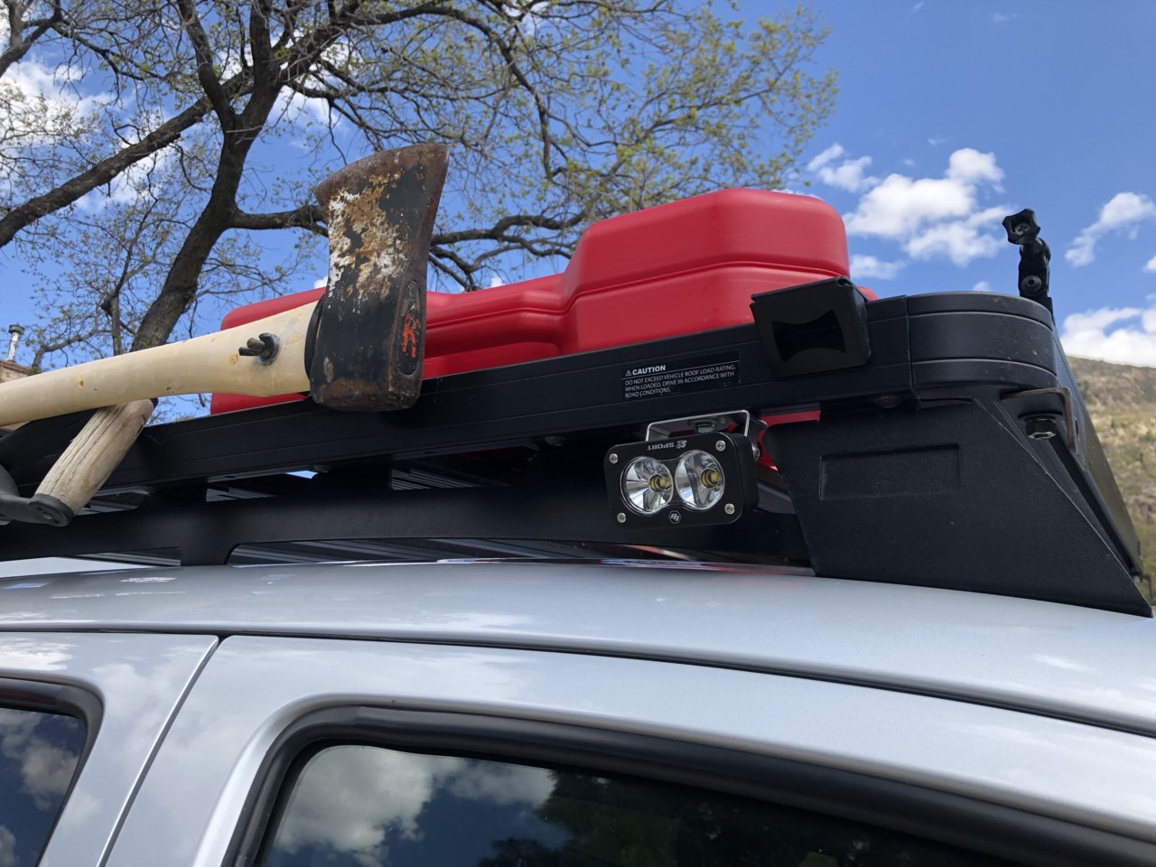

    Mostly packed up!

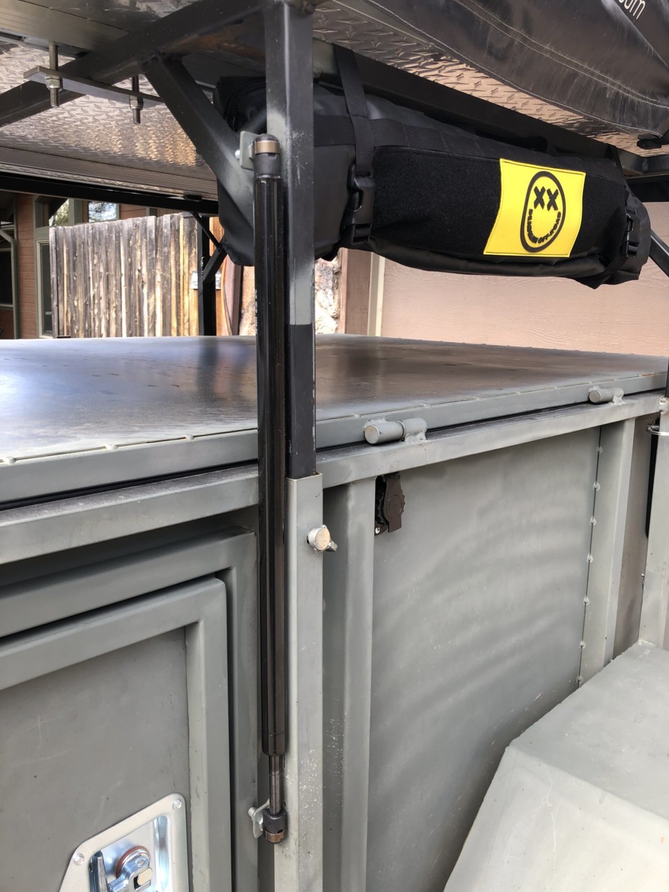

    Flipped the struts on the tent rack
    Made awning mounts (cvt dropped the ball)
    Got the awning installed
    Maxtrax strapped to the spare
    Baja lights installed
    Foggy headlight fixed
    Deadman found a home
    Got the camp lights beneath the trailer installed
    Plastidipped the chrome grill
    Realigned the front bumper
    Btnewman likes this.

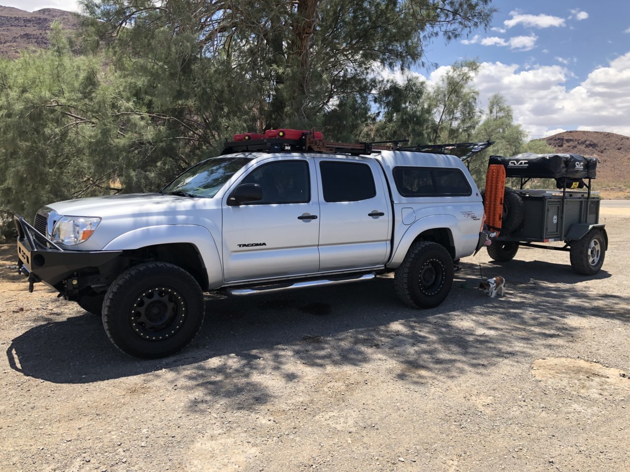

    All hooked up and ready to go this morning!
  13. Jun 1, 2019 at 3:36 PM
    #53
    Vacationgangster
    Vacationgangster [OP] Well-Known Member
    Sep 19, 2016
    #197746
    207
    2005 silver Tacoma
    OME 886's, Dakar Leafs, fk29 cb shim, 3deg spacers, 17" Method Vex, 255/80/17 Cooper S/T maxx, Leer shell, frontrunner rack, Thule bars, 40" light bar, Hids, Seat covers, JL's, Headunit
    500+ miles down and not a hitch! Stoked!

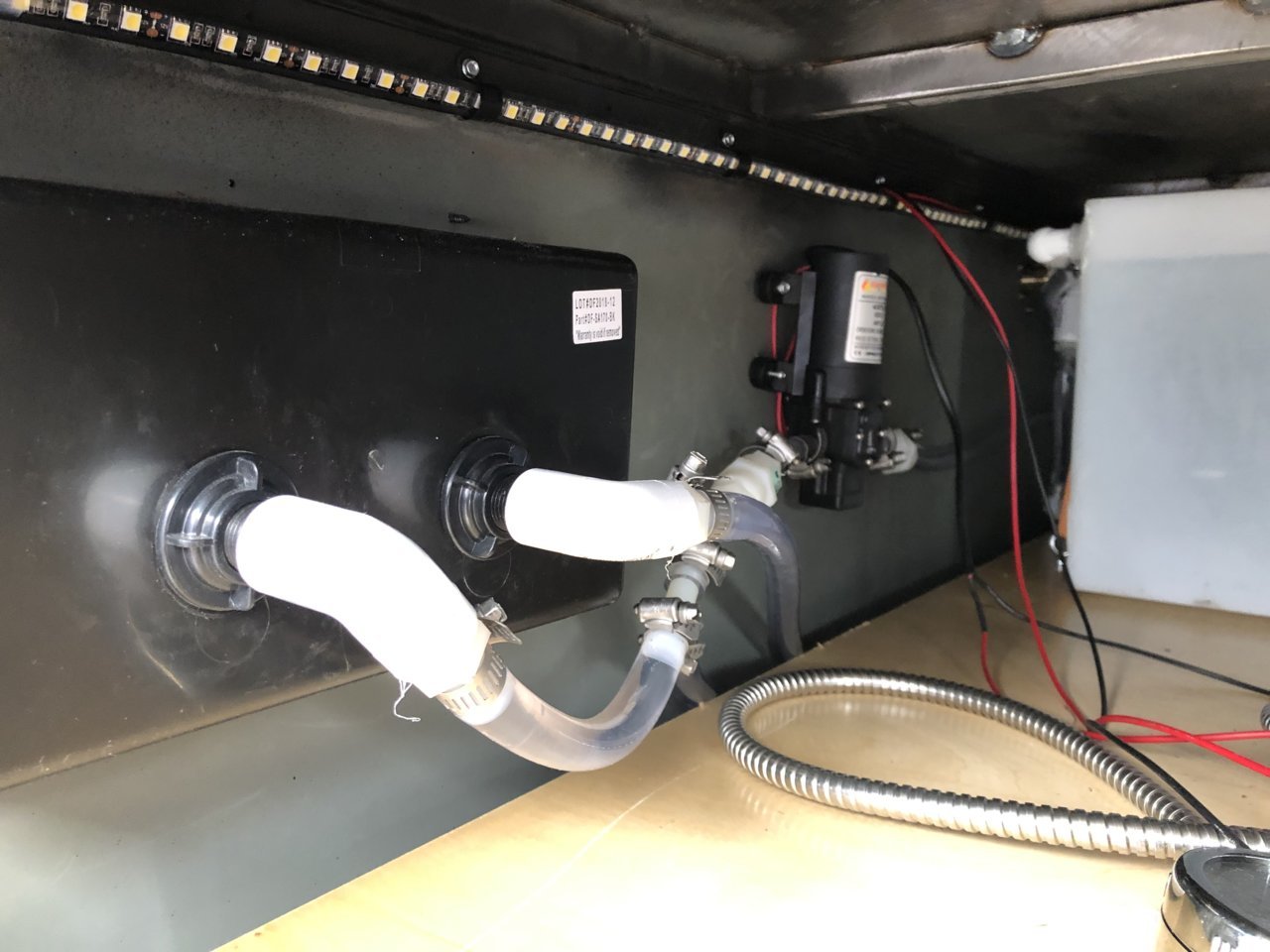

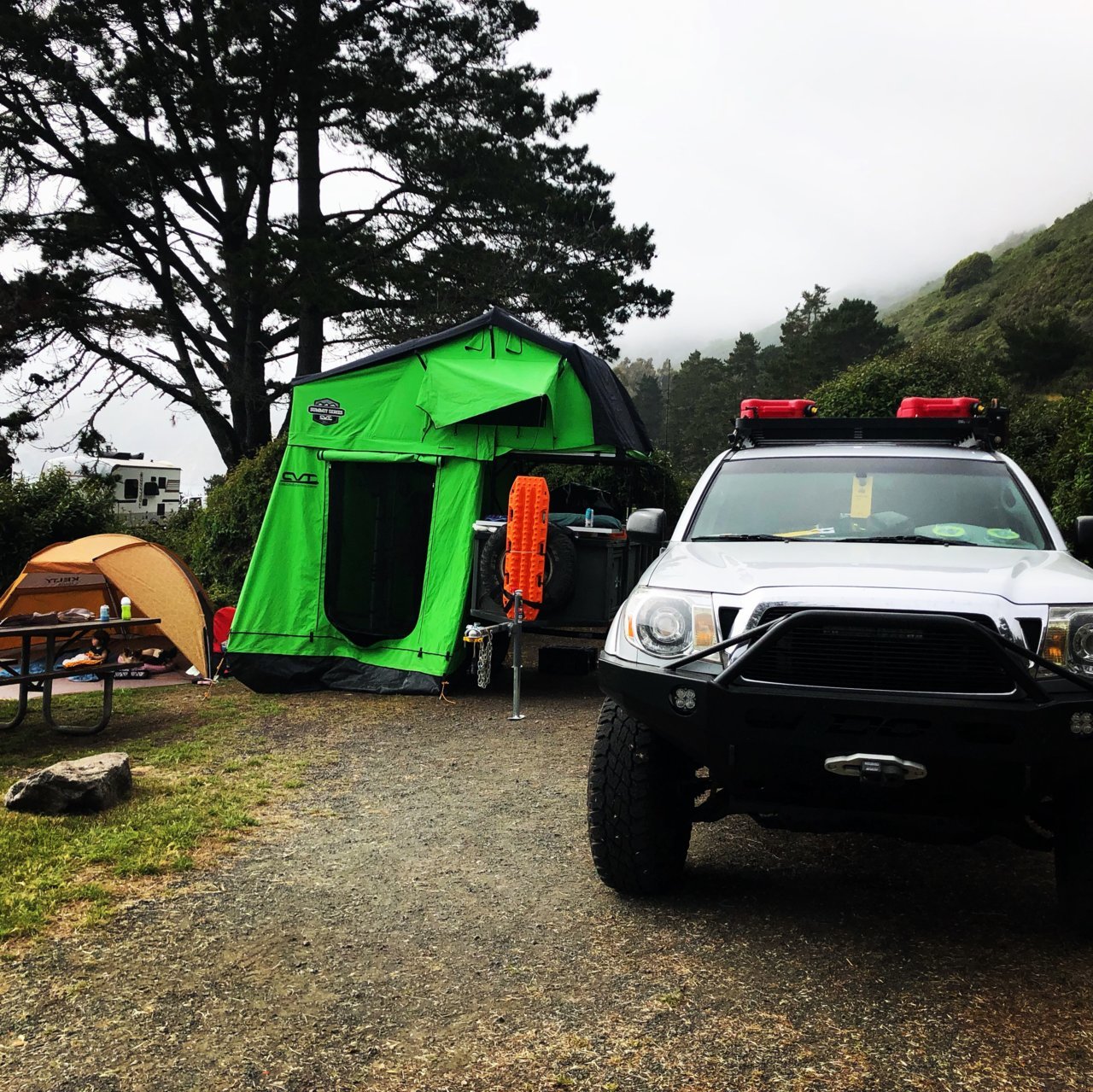

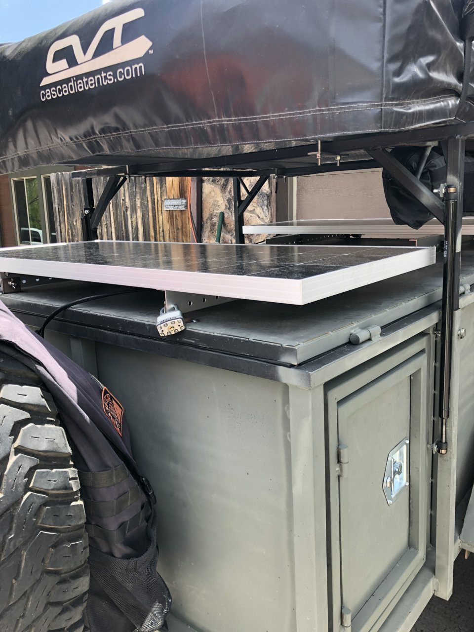

    Trip to Big Sur went well, 1600+ Miles on the trailer and everything performed well, with the exception of a few small things
    Table off rear tailgate is mounted too high
    Need a Hose to fill off of non-fitting equipped water spigots
    Need to adjust the door locks so they aren't so tight
    Secondary holes for RTT bars for multiple heights. (Fully extended was too high for uneven campsites)
    Make a better trasharoo mount
    Make better maxtraxx mounts
    Fender steps
    Move water pump switch next to spigots for ease of use
    Propane tank mounts
    Hot water heater wouldn't get hot enough to have good hot showers
    Things I really liked
    Leveling jacks at both side of the rear of trailer.
    Camp lights
    On to some pics

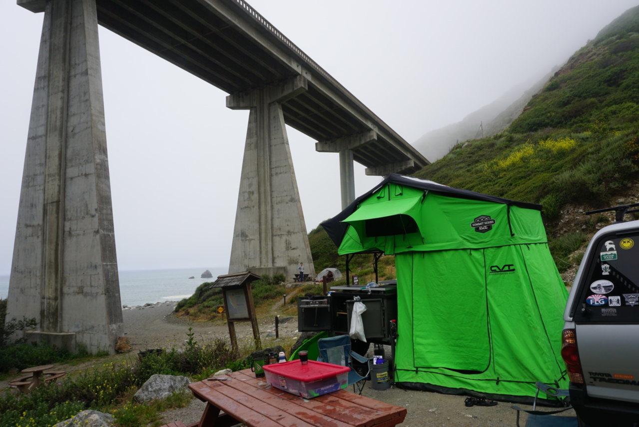

    After messing around fora few days there we drove a mile down the road to our next reserved site at Kirk Creek

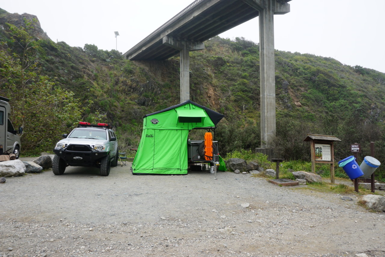

    This site is where I realized the tent at full extension was just too high, The Annex was barely touching the ground at this point.

    I couldn't have been happier with how the trailer pulled on the drives, you can definitely feel that it's back there, but it tracked straight and true the whole way. I dumped the H2O in ashfork and towed dry because of the weight and how much gas we chewed through those first 60 miles, After that I got around 12-14 mpg most of the way. I kept it steady at 65-70 most of the way and ignored the 55 only signs in CA.
    After four days of fog we decided to leave a day early and head south to morrow bay again and stay in the Morrow Strand Campground again before heading home, Thankfully that last day we had some weather blow out and it cleared the coast. So we spent the last day there driving back up to Lucia and checked out everything again in clear skies. It was a great trip and the trailer performed wonderfully, but it was wrought with setbacks because camping with a kiddo in campgrounds is definitely different. We will be heading back sooner than later, but I've got some changes to make before next weekend when we head to the north rim. Point sublime here we come!
    Till next time!
