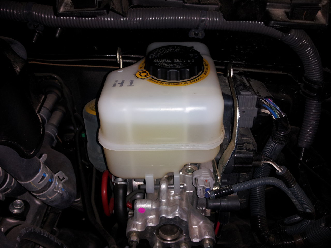

    Does the master cylinder setup in the 2015 look like this?

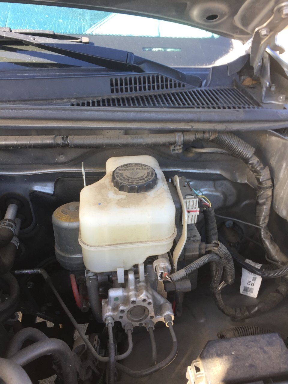

    I couldn’t say i did forward him the pic because hes not on here and computer illiterate. He has a 15’ OR acces cab. Pretty identical to my 14’ heres my master cylinder. Looks same. The first thing a independent mechanic mentioned was the master but he didn’t delve too deep. Said there is or was a gnarly shake when breaking but I thought maybe he just wasn’t used to these touchy brakes. Thought i had maybe seen a thread in lessening I the touchiness if it all

    If his MC setup is like what we both see here, I will say that one is a bit touchier than the std. vacuum-assist MC. The pic I posted is from my wifes '14 4Runner. The 2nd Gen Tacoma's(2005-2015) that use an electric-assist MC, have the same unit as the 4R. I don't drive her car on a daily basis, but have driven it enough in the 4+ yrs. she's owned it to say that it's more prone to what I call "nose-dive" braking. Braking is a bit more sensitive.
    I too have neuropathy in the bottom of the upper part of my feet, but it's not far enough advanced to affect braking. I could be wrong, but I suspect your friends neuropathic situation and a difference in '14 - '15 electric-assist braking may be involved.
    I would be hesitant to let anyone tell me this VERY expensive MC needs replacing. The cost for the parts and labor are way up there.
