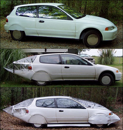

    Hyper miling (Hypermileing?) Is wringing every last possible efficiency point out of a ICE vehicle.
    Typically via duct tape and hack job diy aero.
    Some 80's CRX supposedly averaged 85mpg per tank with a kit like this.

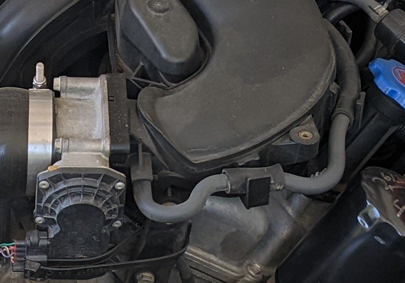

    FWIW the 2nd gen Tacoma uses throttle by wire the TB butterfly kinda only sees driver pedal input as a suggestion and will open only as much as the computer tells it to in conjunction with AFR wide band and MAF readings unlike older true cable actuated TB's.
    What's this mean?
    Well, like you I want to see my manifold vacuum to monitor efficiency but I do so via a OBDII dongle and an old phone using the Torque Pro app, with that said, there's little we can do with said information beyond continuing well known efficiency driving habits as we don't have direct modulation power over the TB.
    Beyond that, ram air is real, I have a snorkel and a custom significantly more free flowing intake with some other goodies and if I do a 3rd gear WOT pull to get up to speed and then skip 4th and 5th right to 6th for cruising I can see exactly when that TB slams shut as my manifold "vacuum" jumps to nearly +2psi.
    Beyond that my MPG is higher and my intake vacuum is lower on average after snorkel install so that definitely screws further with true vacuum readings to monitor efficiency.
    As always;
    YMMV.
    My best guess to get vacuum for a guage would be to work in a T fitting to this line just behind the TB:
