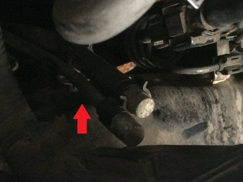

    I need some help figuring out where this vacuum hose attaches? I'm assuming this might be the cause for my P0441 code. This end is right next to the fuse box in the engine bay.
    2008 Toyota Tacoma 4.0L V6
    Thanks!

    That looks like the front diff and transfer case breathers. But I'm no expert. Hopefully someone else chimes in.

    Was going to say the same thing.

    bing thats a winner..both vents

    both are vents for the front diff.
    The one with the bigger tube is the main front diff case vent. The one with the smaller tube is the front diff actuator vent.
