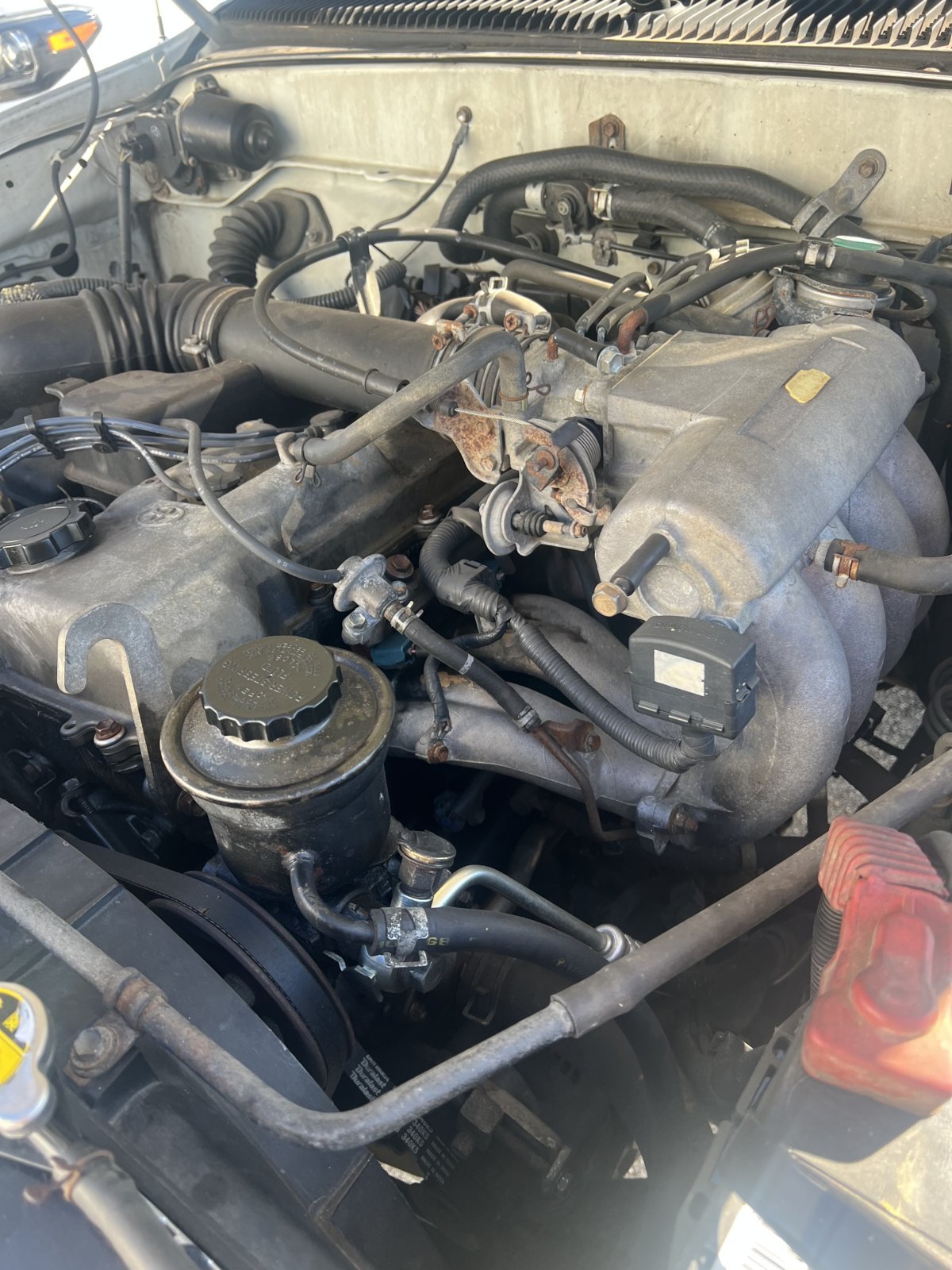

    Sounds like something was deleted. Any pics of the bay?

    Those vacuum ports that have the hose with bolts in them… the vacuum caps rotted and fell off, those are OK.
    IIRC, the code you gave is for EGR

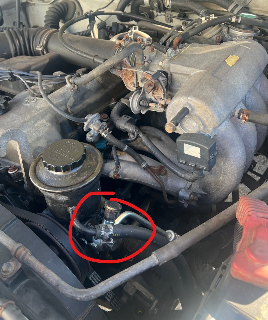

    The capped off lines in your image go to the idle up for the power steering pump. The part circled is not stock.

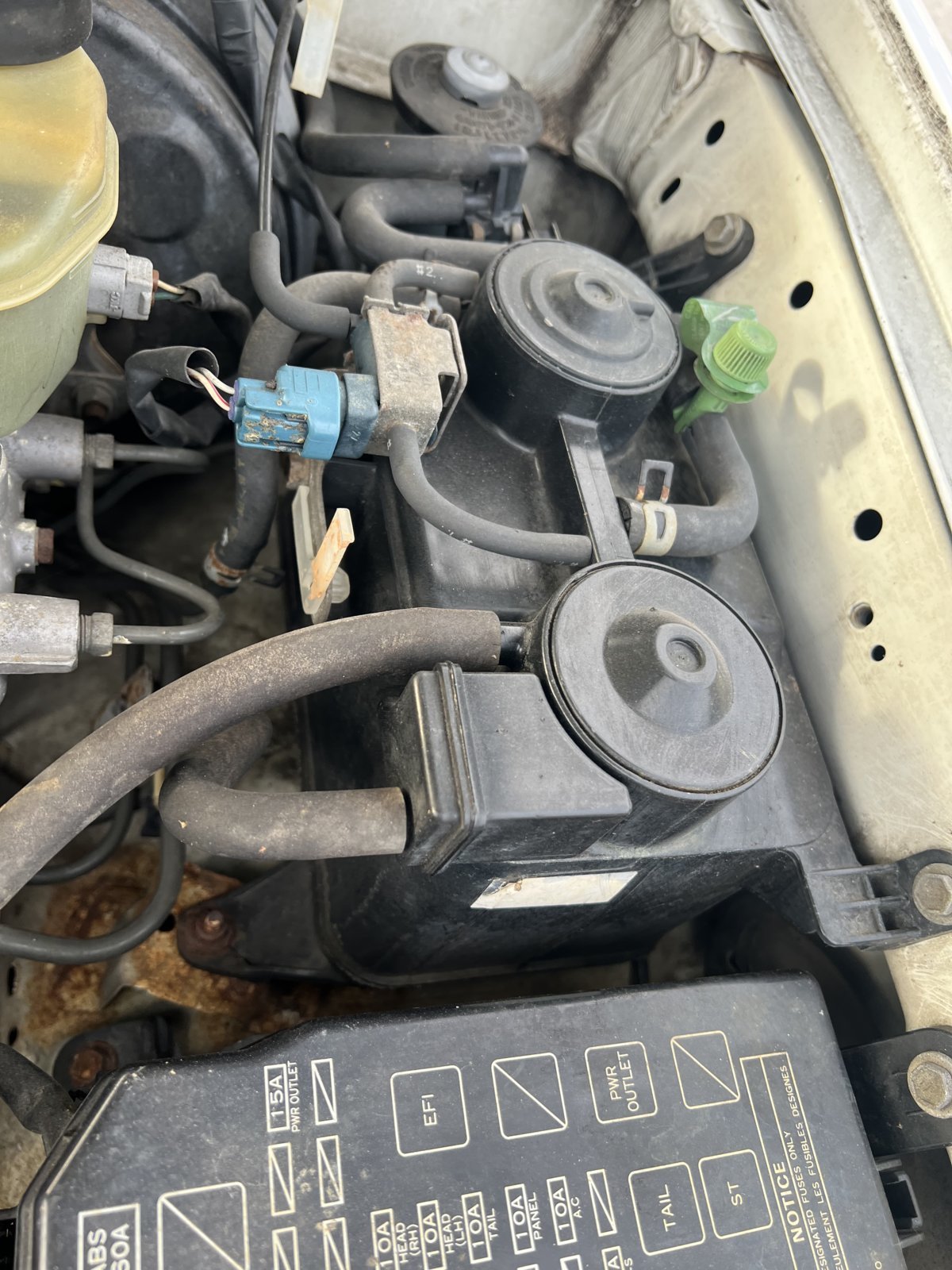

    What does your evap canister look like. It is just out of view to the right of the image you posted.

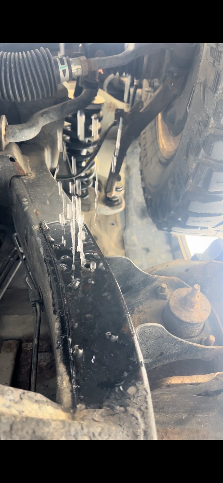

    It’s coming from the frame. Looks like a like from the canister drops into the frame, possibly for ventilation? Idk. I’m sure it’s not the fuel lines because I don’t have any leaks with the gas cap off.

    Is this the canister you believe its leaking from, do you see anything on the other side of it or under it?
    I think you need to lay under it while its running and figure out exactly where the fuel is coming from.
    It might be a more complicated issue, but I would knock a simple problem like a cracked fuel line or loose connection off the list of possibilities now before you spend too much time diagnosing a more complicated issue.
    I'm no expert on fuel systems AT ALL, but, is it possible its got a weak connection that only fails at full operating pressure, and with the gas cap removed the system never reaches that pressure?

    I hear you. From everything I can tell though, it’s definitely coming from the line in the frame. Not sure is another line may be clogged or not, but it seems to stem from the canister IMG_5725.png
