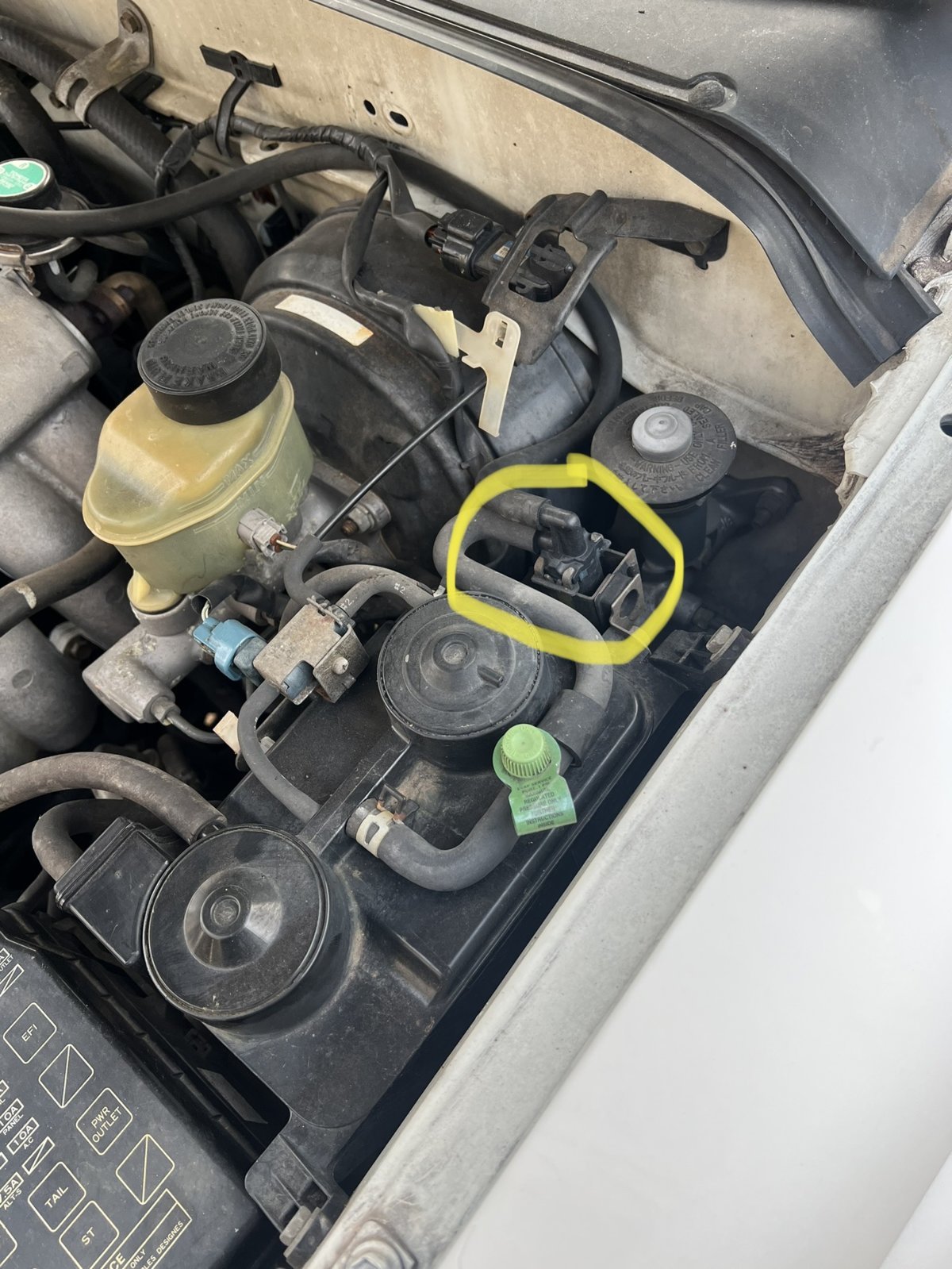

    One of the hoses that comes off of the evap canister vents into the frame rail. Is the fuel siphoning through the evap and out that hose? You should be able to pull it out of the frame.

    To my knowledge there isn't any fuel lines inside the frame, other than the vent @nzbrock mentioned. Its been a while since I've looked at my lines but I believe the fuel line is one of the hardlines on the left side of your picture. Id trace the line from the fuel filter which is a little further towards the rear, and see if you can find anything as you follow it up.
    I'm not sure how else fuel would be getting in there, as you are right its draining right out of the frame..

    Yes! Just pulled it out of the frame and that’s the one gas is coming through.
    @time623 it appears to be that vent line coming from the front end of the canister

    Also noticed the vacuum switch doesn’t even have an electrical connector attached to the plug. Could this potentially be bypassed as well by the previous ingenious owner? IMG_5727.jpg

    Take a good look around and make sure that connector isn't hanging around loose anywhere in the engine bay. Maybe you get lucky and can just reconnect it?
    Not sure if plugging that in will fix the problem or not.
