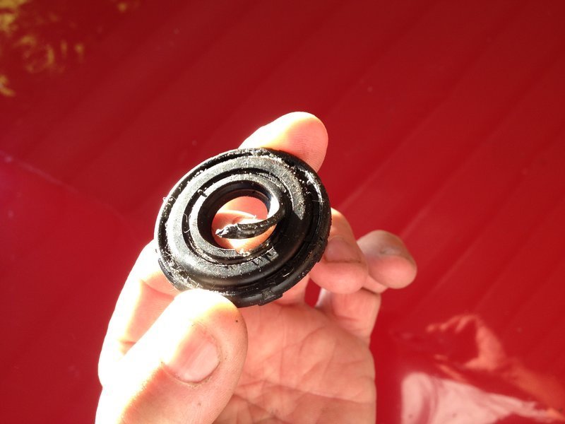

  11. Nov 16, 2019 at 9:19 PM
    Glamisman
    Glamisman Well-Known Member
    Oct 22, 2016
    #200436
    4,971
    This probably what you are inquiring about... I have never seen it sold separately but I haven't searched everywhere.
    License2Ill[OP] likes this.
  12. Nov 17, 2019 at 9:21 AM
    License2Ill
    License2Ill [OP] Woke like a Coma Toyota Tacoma
    May 20, 2012
    #79174
    2,253
    Ian
    It's a dry heat thou, AZ
    2004 SC'd 5VZ DC 5spd 4x4 TRD.GOV
    Bailing wire & Duct tape
    Yep. I searched high and low. Nahdah.
