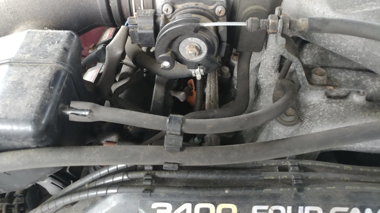

    How do I find the part number for this air (vacuum?) hose? What does it do?
    It connects an air box on the air cleaner to something on the manifold.

    It connects the resonator to the fuel pressure regulator, part number: 17343-62090
    you can also use any 1/4" vacuum tubing
    For what it's worth, you might want to consider getting the kit from yota shop with all the vacuum lines for the 3.4l: https://www.yotashop.com/vacuum-hos...a-vacuum-hose-kit-1996-2001-kit-1106/#gallery
    Edit: Here is a link to the Toyota parts page: https://parts.toyota.com/a/Toyota_2..._51507_6732946/VACUUM-PIPING/674460-1708.html
    you'll want to select the 0009 drawing for the 3.4l tacoma.
    Edit #2: There are also a few more vac lines in the ventilation hose sections (for the PCV and EGR): https://parts.toyota.com/a/Toyota_2...507_6733284/VENTILATION-HOSE/674460-1201.html diagram 0002

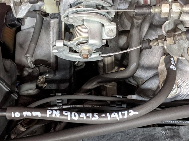

    Maybe this? Can't say for sure. This photo from 2000 PreRunner V-6, A/T. I got the parts number from the parts desk at local Toyota Dealer.
    This is the original hose; it was slightly split at the 10 mm end, so I just trimmed off the split end and put it back on.
    Note that the hose is unique in that one end is i.d. 10 mm, and the other end is i.d. 8 mm. (I measured!)
    Likely an "off-the-shelf" ("Auto Zone-Rubber Hose") hose will not fit. Also, thin wall tubing will collapse as this tubing routes a vacuum.
    Possibly the hose in OP's photo is split because it is actually an 8 mm hose trying to fit on a 10 mm fitting?
    And, yes, sometimes when I discover a part number, I write it on the part.
    Take your VIN and the photo to a Toyota Parts desk and they will look it up for you; no obligation to buy.
    Good luck @dcubed. Let us know what works for you.
    Oh, in answer to your question "What does it do?": It functions entirely to give you a panic attack at the parts counter when you find out the price PLUS SHIPPING.

    I think your dealer tried to pull one over on you. 90445-14172 has an MSRP of $60 bucks! 17343-62090 (which I can confirm fits my 2001 3.4L A/T 4WD Double Cab) is only $15 MSRP (or $11 online pricing).
    I'll also add, that in the past, I have used the "marine" grade heat shrink tubing on the rubber vacuum lines when the ends split like that. The marine grade / heat shrink with glue in it will help seal the split ends much better than a few wraps of e tape, or having to trim the line shorter like you've done here.

    17343-62090 is the correct part number for this hose, and it is a different diameter at each end. You should be able to get it for about $11.
    Jeff
