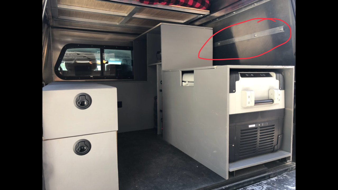

    I sandwiched the camper wall the same way I did the awnings: alum flat bar on the inside, closed cell foam on both sides, and marine sealant from West Marine. You can kind of see it here:

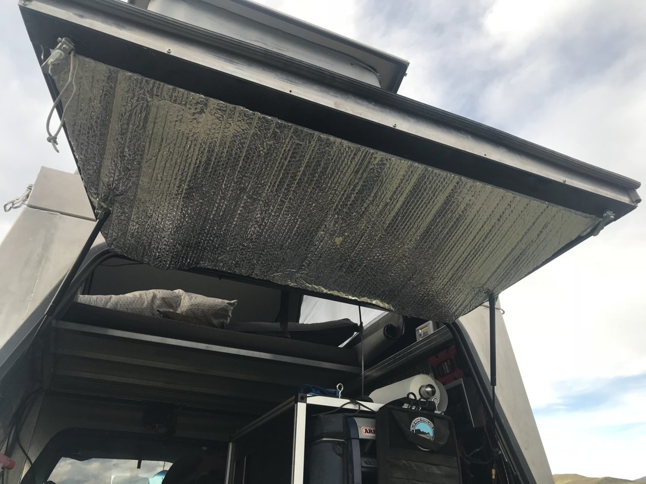

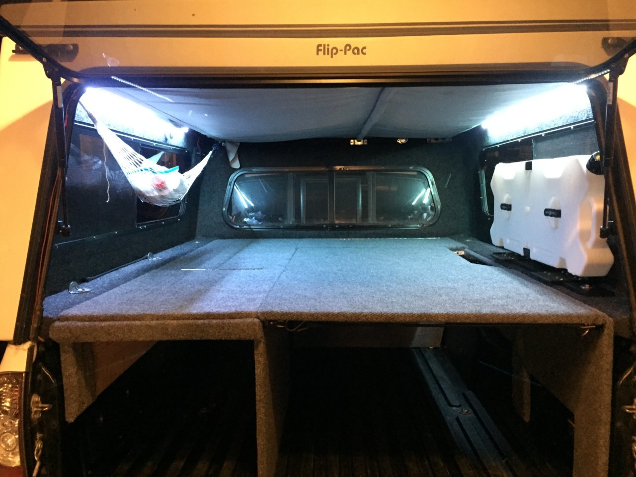

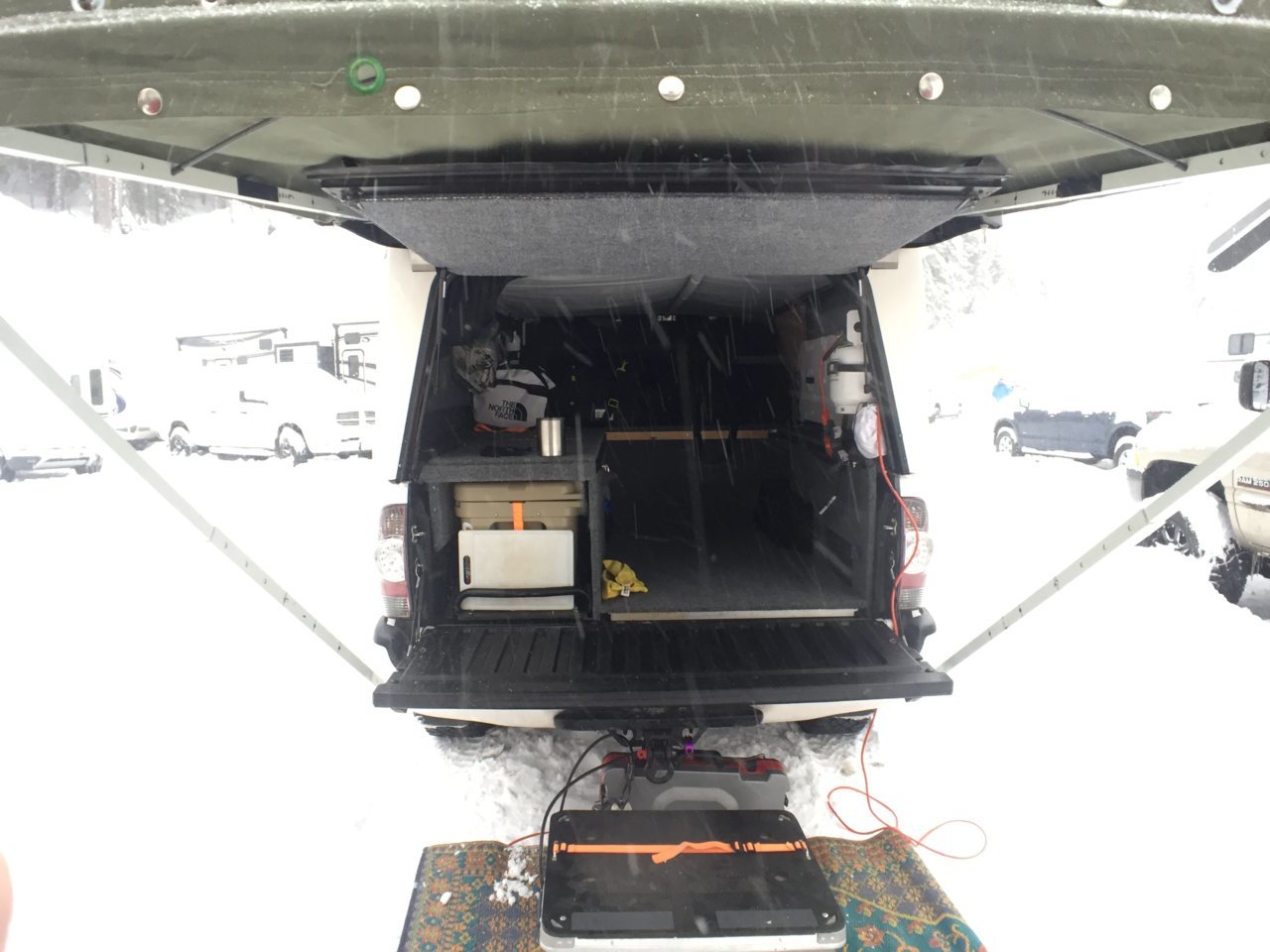

    I did this in my Flippac for winter camping and it worked good. I carpeted both sides which helped with condensation. A little harder to do on the road tho
    Not the best photo, snow washed out the photo lol

    Your build out looks awesome. Do you have any more photos of the interior?

    The wall mounted propane tank is a neat touch, really like that

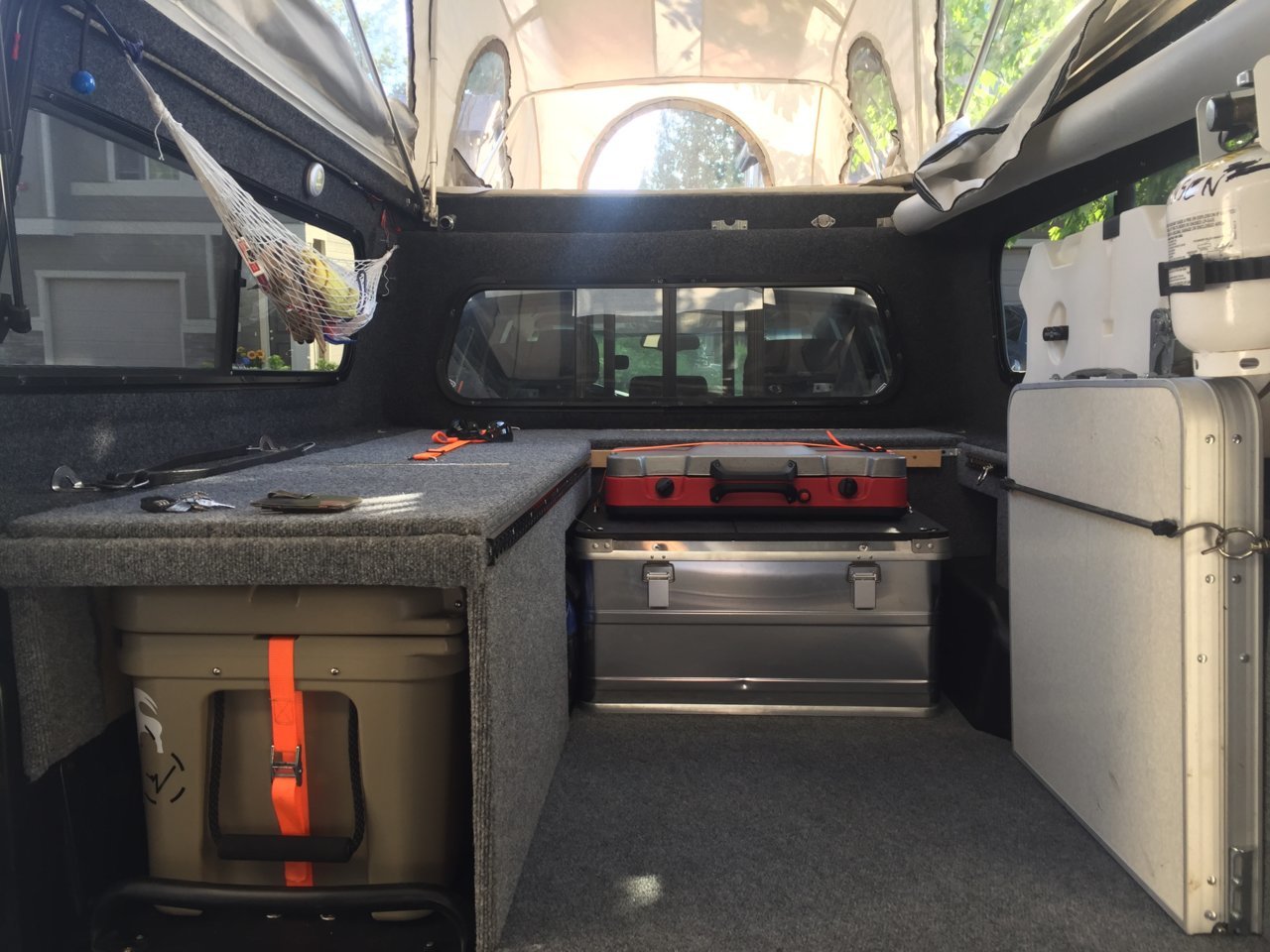

    Here are a couple. I’ve got a buncha detailed photos of the build I have saved for the day I decide to do a build thread lol
    All my recovery gear is in the compartment/bench at the front towards the cab, sleeping gear and a few additional totes/chars sit on the left
    Floor piece makes a complete deck for stealth camping or additional storage
    Thanks man, it’s works pretty good. Ideally it would be on a swing out rear bumper but who knows when that will happen.
    Both these photos are a little older. I don’t pack the table any more because I made a swing out table inside. Happy to share more if ya guys want.
    The set up has worked well for us. I plan to keep it nearly identical in the drifter with a few modifications my wife and I came up with

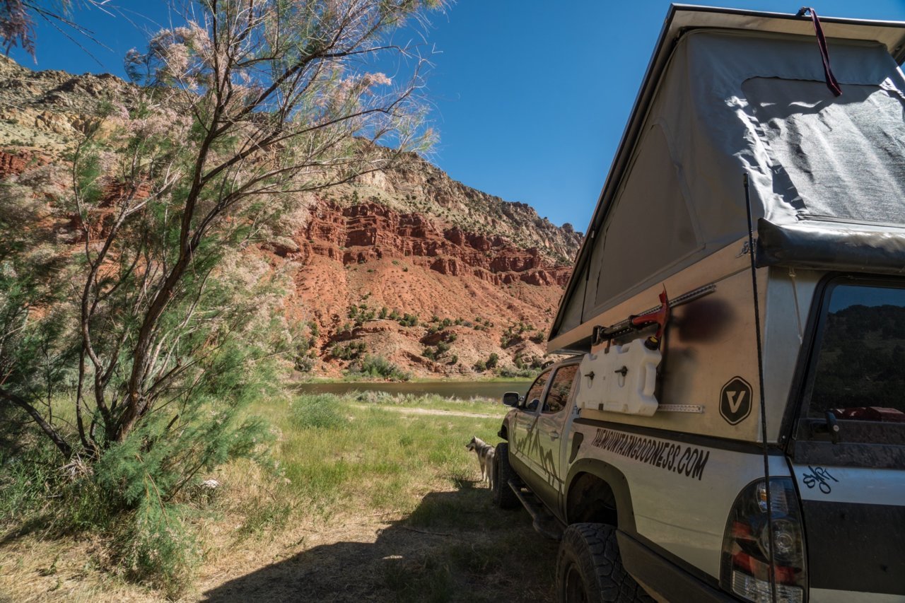

    Here is the better res of the photo Phil posted and a couple from my recent trip!
