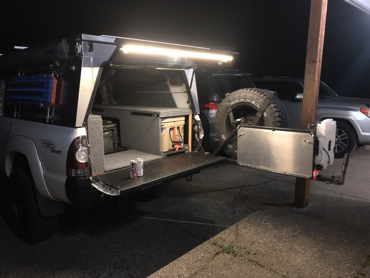

    For sure! I actually have a retractable bar that I planned to put a single pod on with an external switch. It pivots as well so I will be able to point it where ever but I mainly want it for when I’m loading/unloading my bike etc at night.

    Genius dude! I have some of the white 5050 lights left too. Did you just stick it straight on to the hatch or did you install the lights in a diffuser track?

    I was looking at putting it in a track originally but ended up scrapping that idea and stuck it straight to the hatch with some 3M. It also kept a lower profile that way. Its stuck just above the tailgate flap so it doesn't interfere or get squished closing the hatch. Routed the wire loom up the inside of the window frame then followed the brake like wiring back to the switch panel :cool:

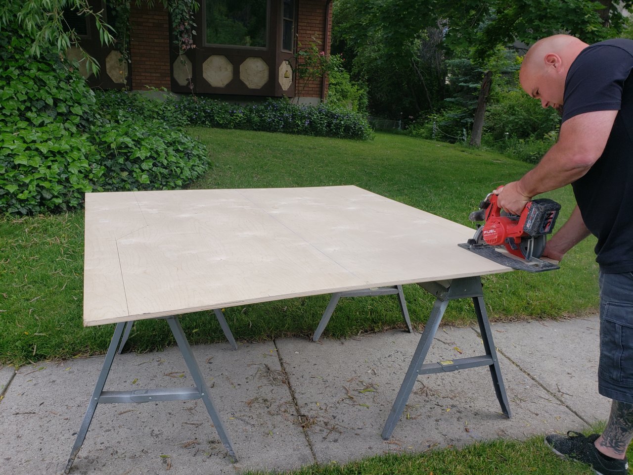

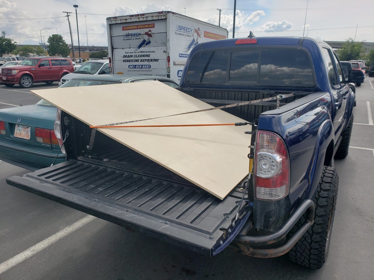

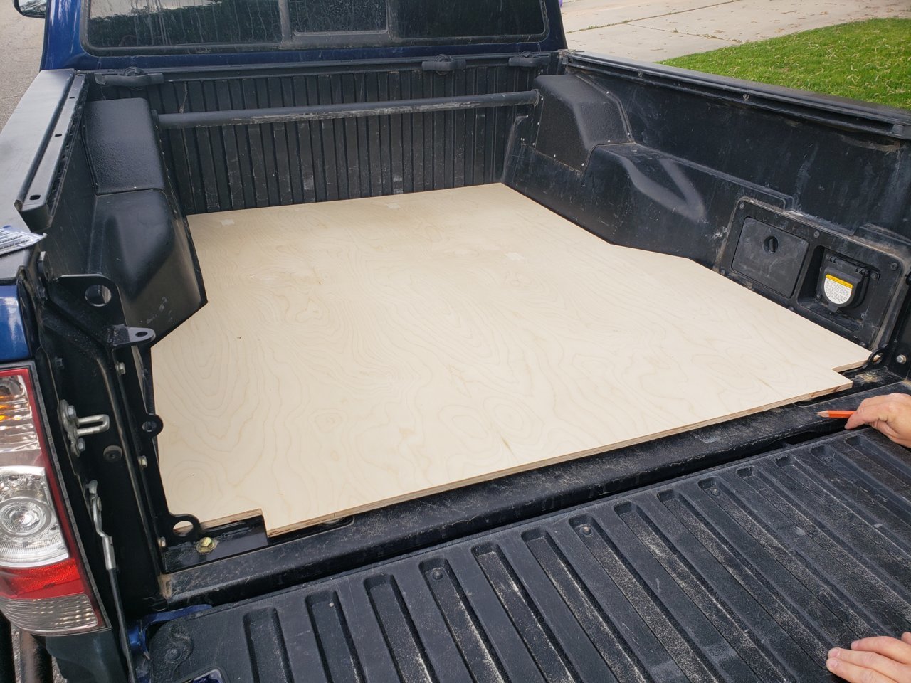

    I picked up a 5x5 ft Baltic Birch sheet for $31 at a local hardwood shop (Thanks for the recommendation @snwbrdr852 !)
    Contractor friends with the right tools make for very quick work, just as the rain came in so I'll have to start painting it another day.
    My next big question for you guys.. how did you secure the skeletal frames down to the flooring? I want to do a fridge slide and I cant seem to wrap my head around something strong enough to secure the frame of it down. (If that makes sense)
