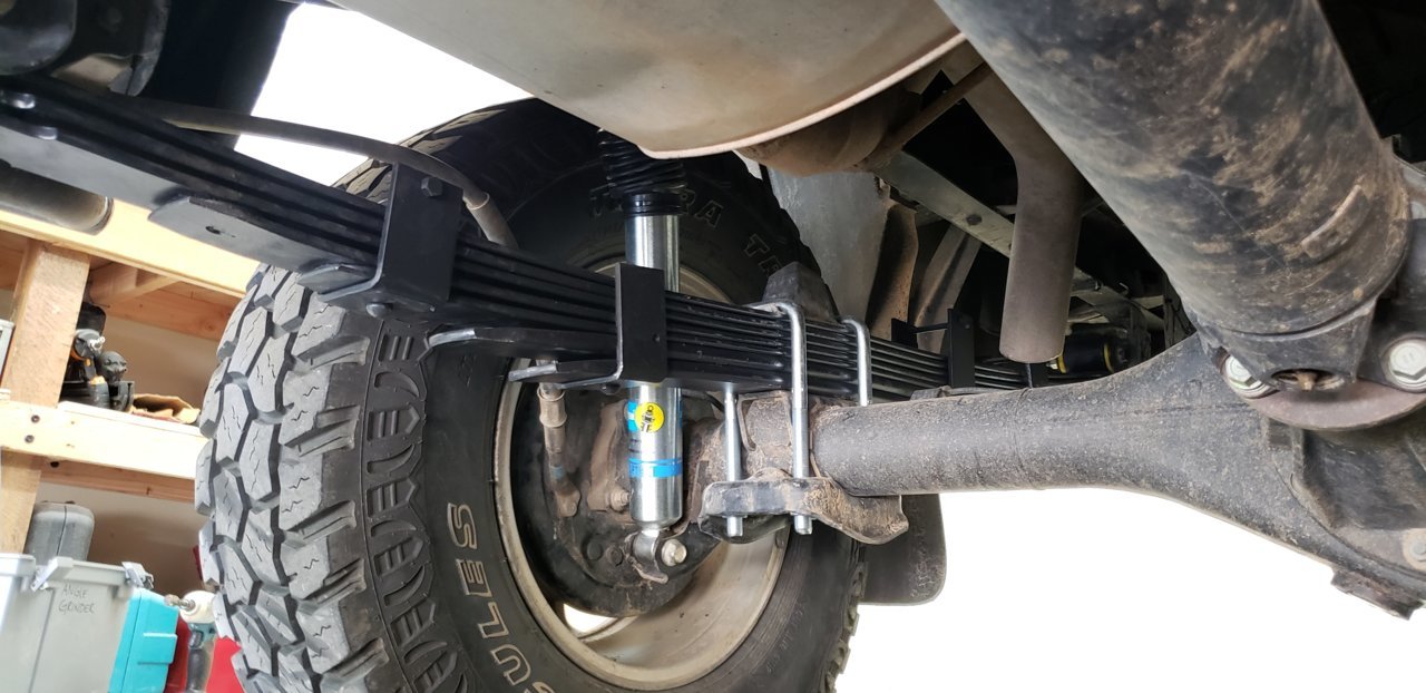

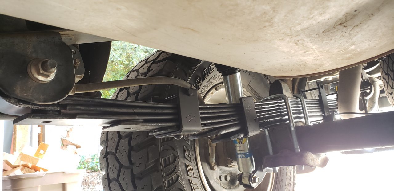

    I ordered my Drifter back in May and I'm trying to get my suspension dialed in before I pick it up around March. I just installed Bilstein 6112 in the front on the 3rd clip and Bilstein 5100 with OME heavy duty Dakars in the rear. The ride quality is way better then the spacer lift it had when I bought it, but here's my problem. They are supposed to be rated at 660 pounds, but they definitely are not holding close to that weight. I put 650 in the back and it's sagged a lot!!! Even with only 350 pounds it has the W shape in the leaf's. What should I do??? Try to return to Wheelers Offroad and get Deavers or add a leaf to the Dakars? Hopefully I can return them as they didn't work as specified.
    The photo is with only 350 pounds.
    See YouTube video : https://youtu.be/5JcxSJYVqJA

    Yeah warranty return them and get Deavers 100%

    Ok, that's what I was thinking. Deaver stage 3 is the one to get? Hopefully Wheeler's offroad will return them with no hassle...

    If I get the Deaver stage 3 will my truck be close to level? It's currently 22.5" in the front from center hub to fender and 24" in rear.

    I couldn’t tell ya. That all depends on your load.

    I started with an extra HD leaf and heavy Dakars (Icon front coilovers). The truck now has quite a few miles weight on the setup. It hasn't really moved from ~22.5/23.5 after a few measurements over time since adding the Drifter, LRA tank, f/r bumpers, sliders, Frontrunner drawers/water tank. I did have a weird diagonal difference that adjusting the coilovers got closer to even and probably will try to tune again after a winch and skids go on. When I first put the suspension on it was about 2 1/4" difference front to rear without tank/drawers/difter/gear load in the rear.
    If it were to move much I would likely add another leaf. Performance wise it has been fantastic. Very controlled and reliable in a few hairy situations.

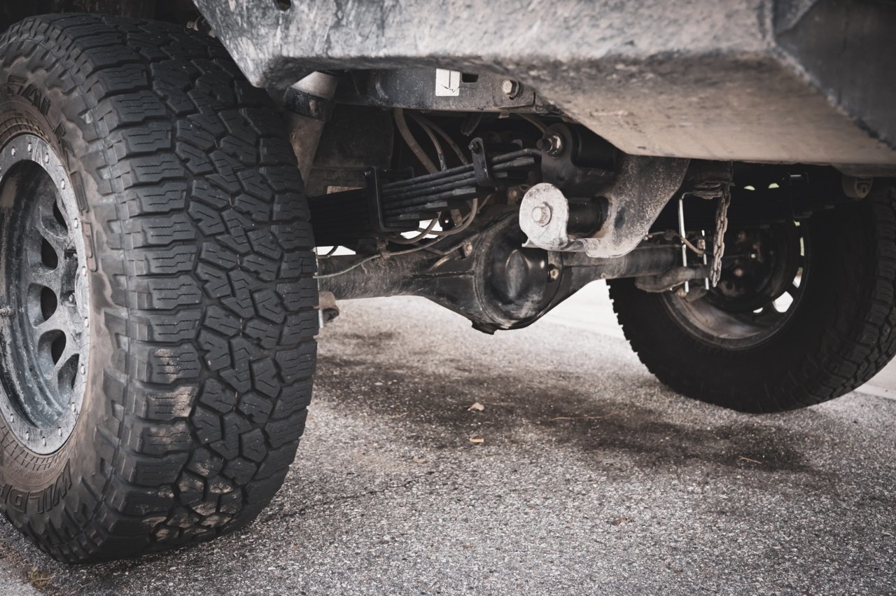

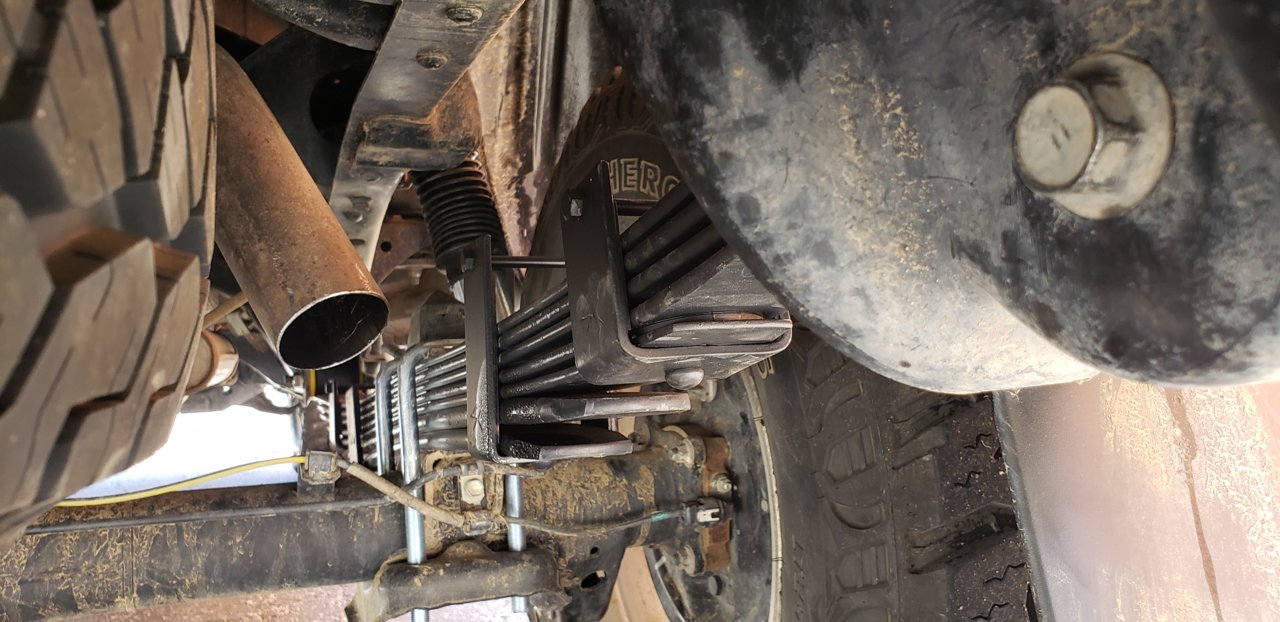

    This looks over loaded right? These are OME Dakar Heavy Duty with 650 pounds in the bed. 20190706_113410.jpg

    If that is level ground, then I’d say the “w” shape you have pictured here is telling me it’s loaded beyond the spring capacity.

    Yes, it's flat ground. Even with only 350 pounds it's got a slight "w" as you can see in the photo below. Wheelers Offroad is talking to OME for warranty.
