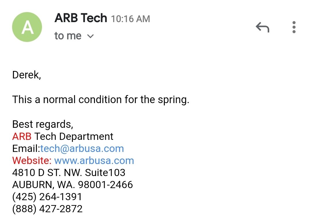

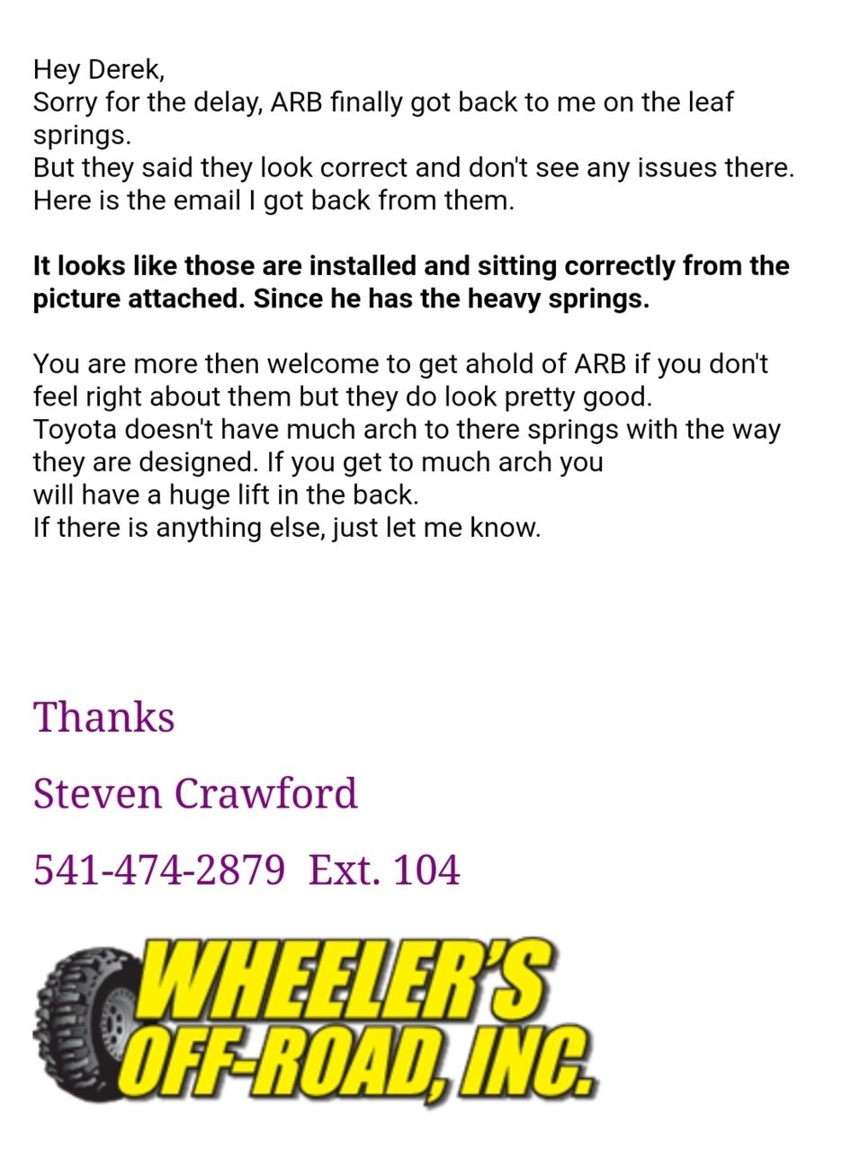

    Here's what I got from Wheelers Offroad who talked to ARB and here's what I got from ARB direct. They both said it's good.

    LOL I'm not buying it...crap I bought into the Dakar club years ago. Leafs should not look like that.
