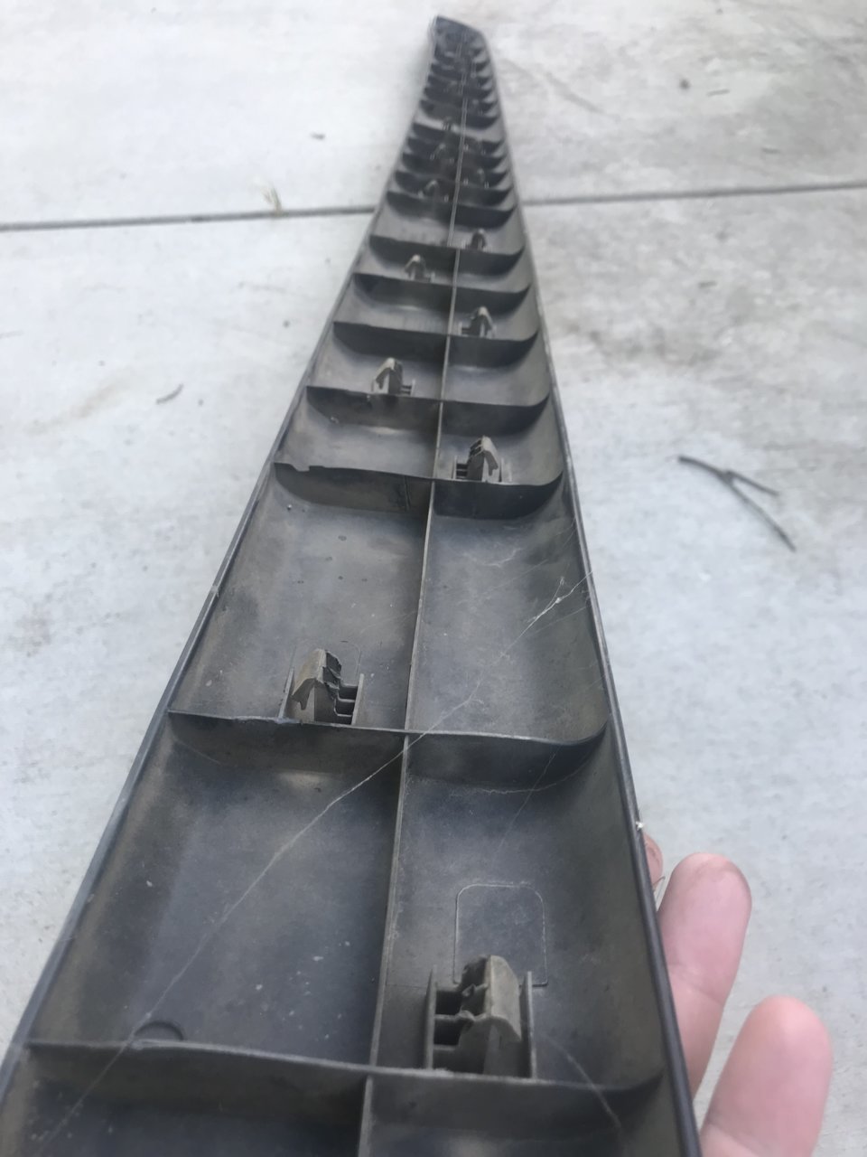

    The underside of the 2nd gen caps:
    Damage from one year of having a snugtop rebel on them:
    Almost every plastic support piece is bent or warped like this and the paint was damaged underneath as well.

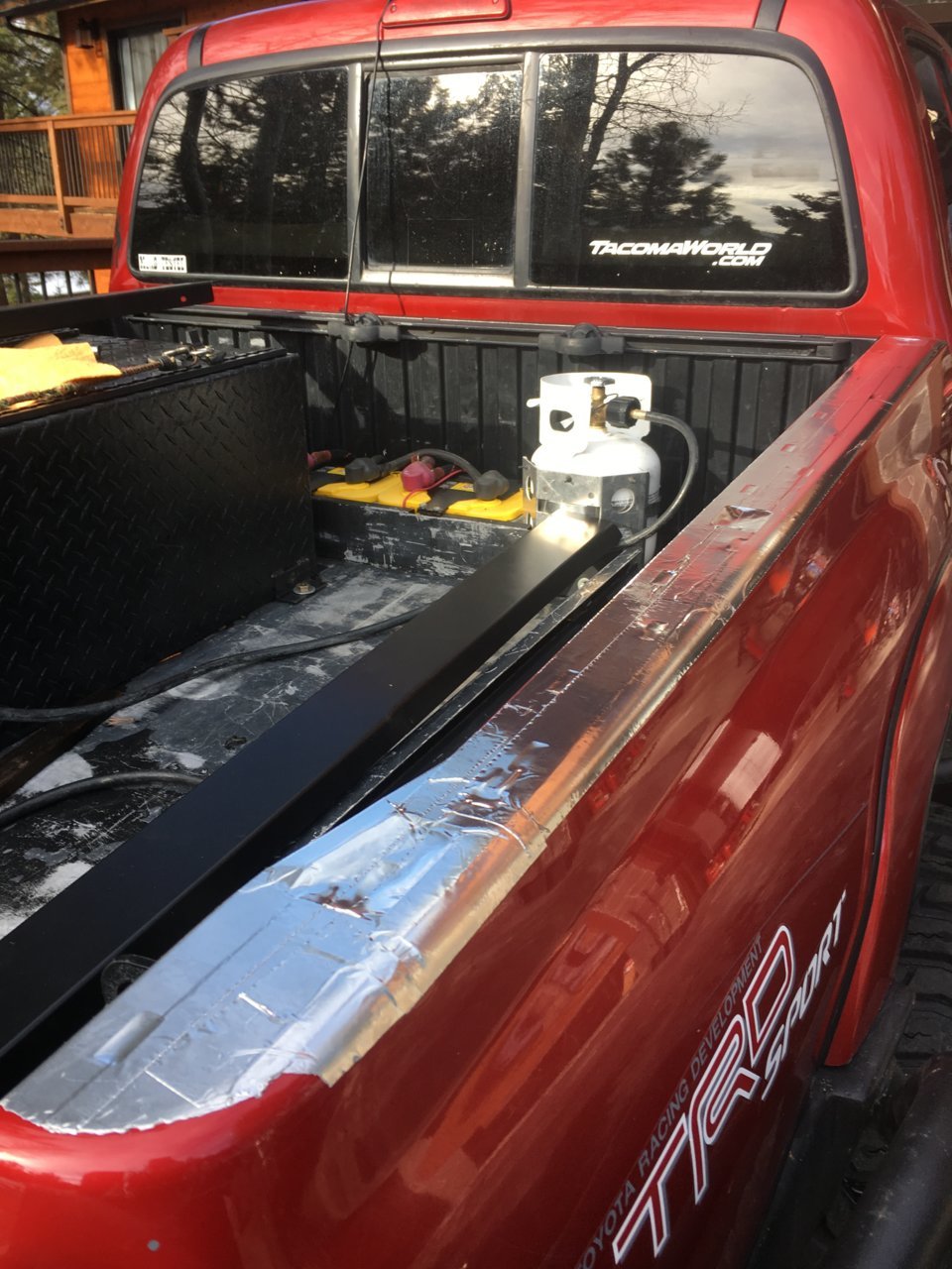

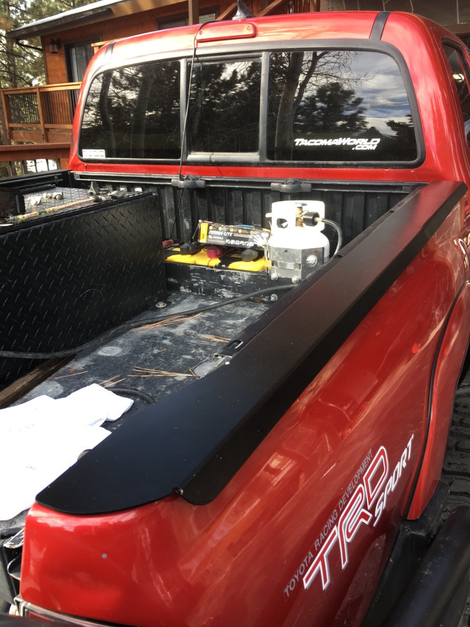

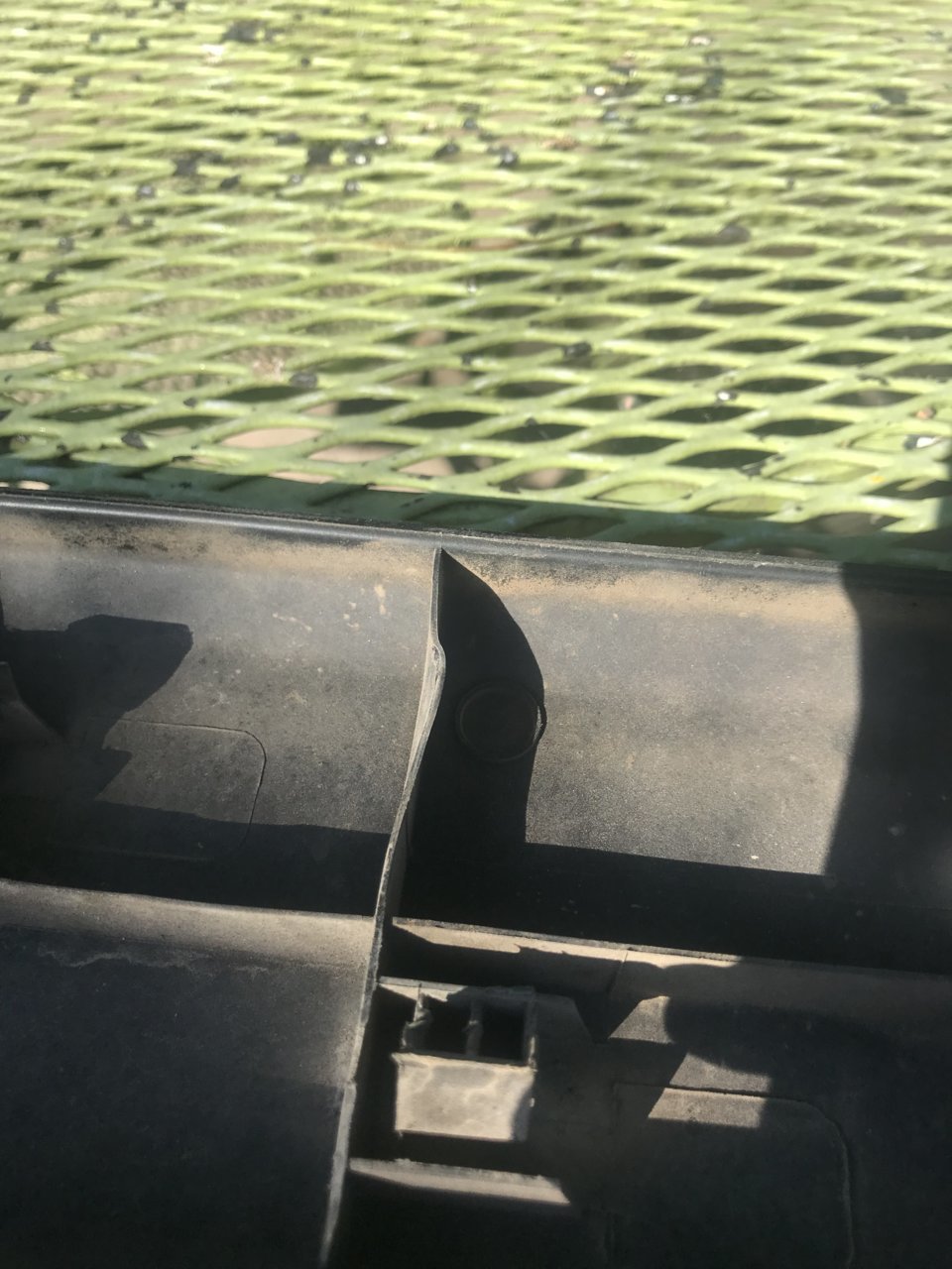

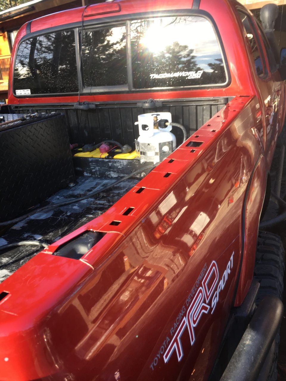

    Relentless caps are where it’s at with the proper prep
    7283130B-5BA2-4E48-8EAC-8E1D530C160D.jpg E51C5012-7168-48C1-9095-FA96D9F26148.jpg 076D57CC-6B96-4106-B7A3-763521290DF7.jpg
