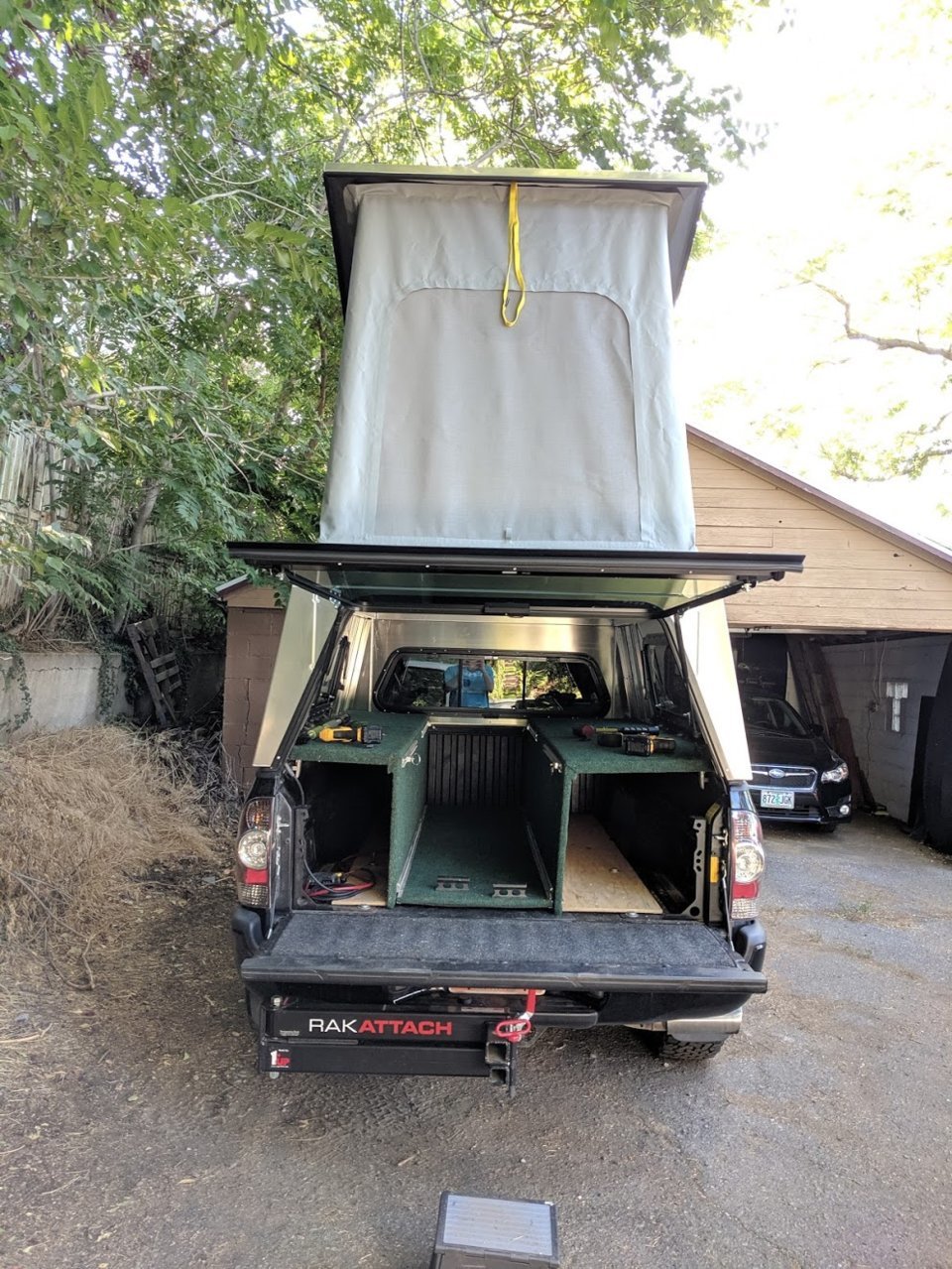

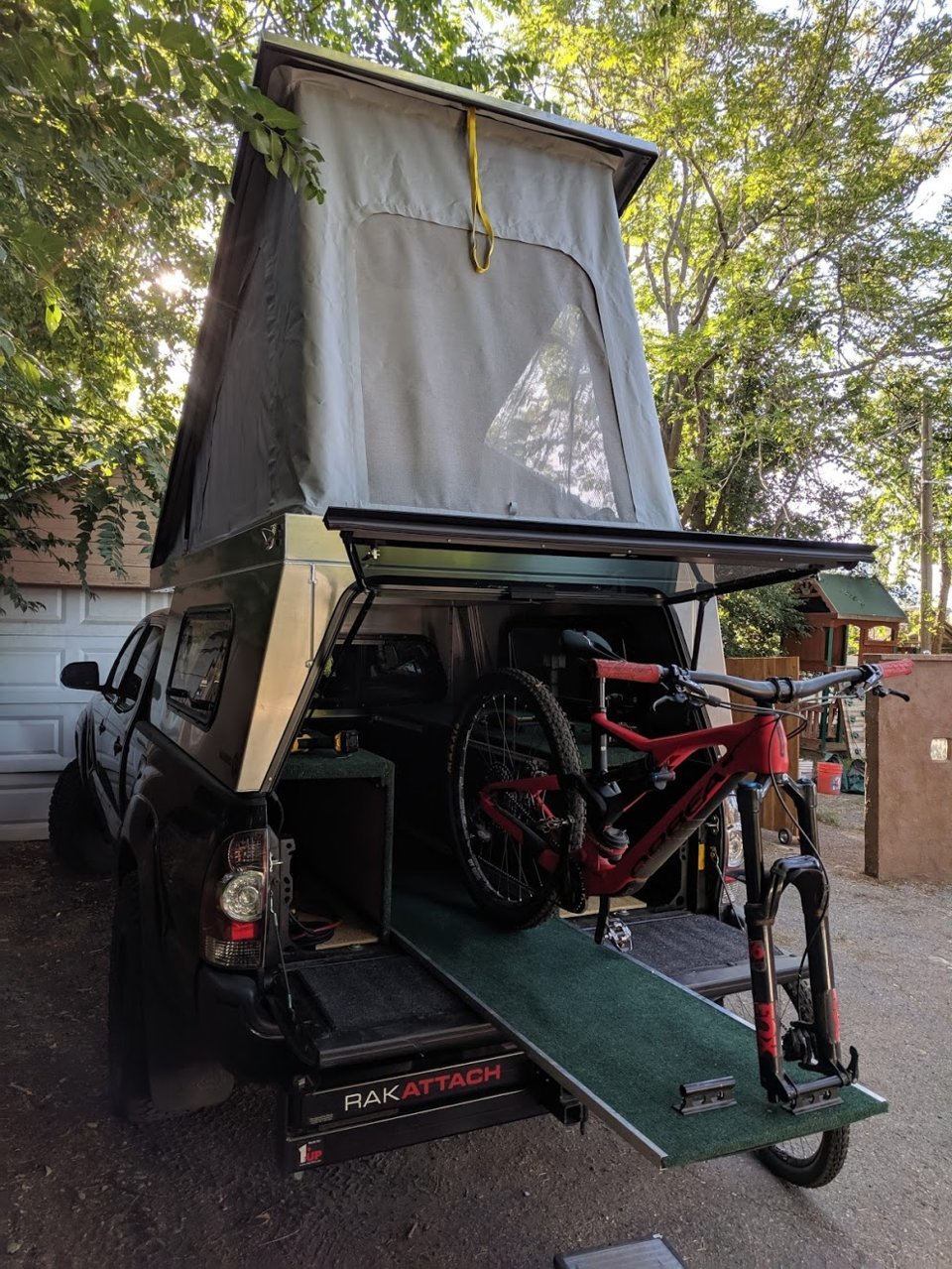

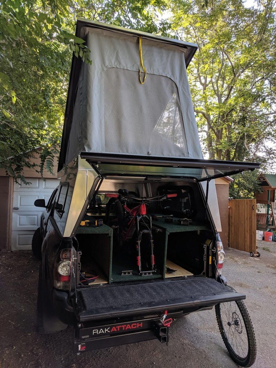

    Got my interior build re-installed. Definitely gonna need some tweaks now that the Drifter is on, but that's why I did the initial build cheap!NnwqGeh9x8g_LwzkcgW5uXQfFmYJ5vp_Gv4W0szx_5309d7e00d41935b4b1104ee81b5291b051fac1b.jpg
    @georginclay04 This is the interior bike storage solution I came up with. It'll fit two bikes and slides in/out on some HDPE. I'll probably upgrade to actual drawer slides when I'm ready to upgrade my build._M0EUel0RpkC06lfhpCY_kl1bg6wPUhTQU9nyzAq_de8d8e884643e12fc007e1dab1972ade62dfbfb9.jpg IRIRzJ71tv2V-Si_g9fhNb1kVMpN5ynvQUpRNH7q_72abbca379bc12e5136caf7393e7d754bf20a526.jpg

    O wow that’s great to keep my bike out of the elements. I’m leaning toward the backswing but I’m contemplating a cover for them... or my wife’s dirt bike may take the hitch... so this is something to consider for sure!...
    someone mentioned to play with drifter for a year or so prior to committing.. think I’m going to take that approach but I’m adding this option to the list!
