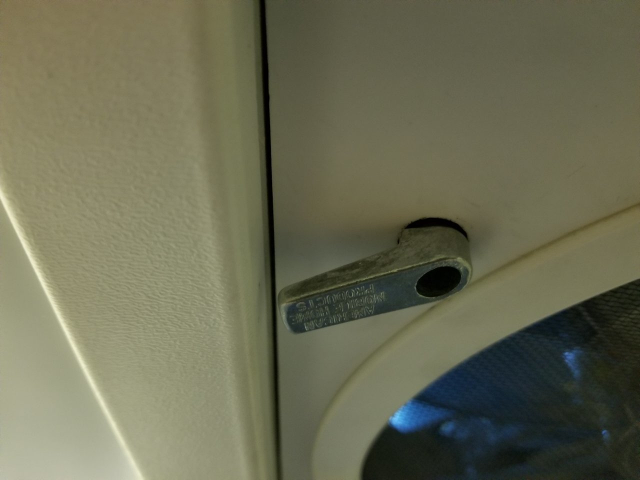

    To those looking for an improved knob/crank for the fan, I think I found it.
    *Disclaimer - I just installed it, so haven't put it through its paces yet.
    But it's aluminum rather than plastic, and the feel of it when you close it nice and tight is way more confidence-inspiring than the plastic one.
    The caveat is that you have to cut the crank portion down in order for it to clear the side trim of the fan.
    You need the 1 3/16" length unless you want it to hang down below the plane of the roof.
    https://www.amazon.com/UNITED-STATES-HDW-WP8887C-Windows/dp/B000BPE5MI?th=1
