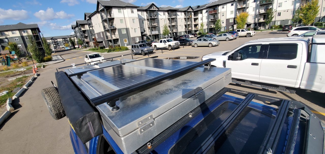

    Long time coming, but the official mod/buildout started today.
    Assembly of two 300 w panels done and installed.
    Tomorrow is wiring and cable install. Rewiring of switch pro and extending all lines to the bed. Followed by redarc battery management system,100aph battery and then going camping.
    Was going to install a propex but i'm having trouble sorting one fitting to make it do I can use a 20lber. . That will be next before my annual trip the southwest us, although I may stick in the PNW this year, will see.

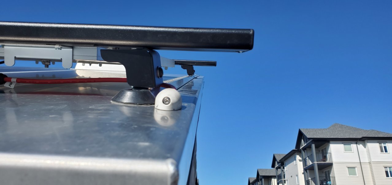

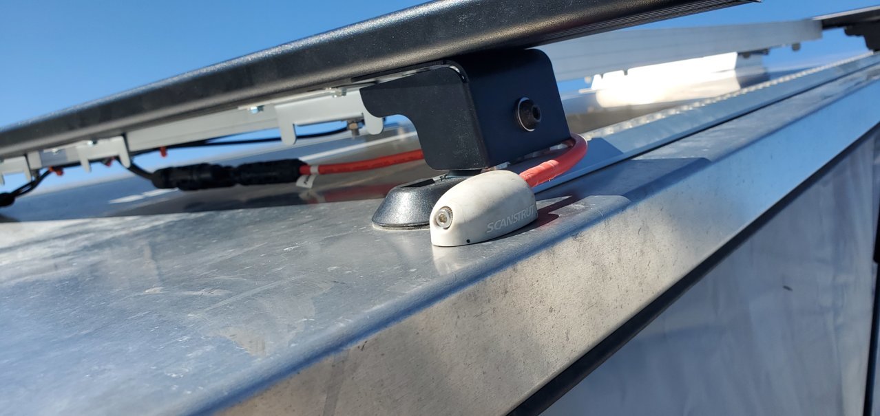

    Okay so those scan strut are a pain in the arse. Solar panel wiring well the stuff I have which is typical barely fits these suckers even though the cable size is suppose to. You do not need a cable gland, well I didn't they probably send me the wrong ones then what I ordered. Anywyays it's in and watertight and I injected the scan struts with silicone sealant.
    I was going toinstall them in line with the alum strut but decided against it. Ended up with this below.
    Scan Struts are in,w is inside the drifter now. I just drilled through outside the tent in the gutters and ran the cable through the hole at the front of the tent . Ran it all over to the passenger side drilled two holes outside the moveable bed frame rail and dropped them down into that corner.
    Tomorrow is ripping apart the switch pro and dual battery system and bringing it to the back of the truck and maybe extending wiring for accessories.
    Monday is new battery day (starter and house as my optimas will not work.with the new system well they will but too small in capacity). Then it's find a box/crate or something to mount the new battery under, red arc BMS system, inverter, circuit breakers and fuses.
    Steve

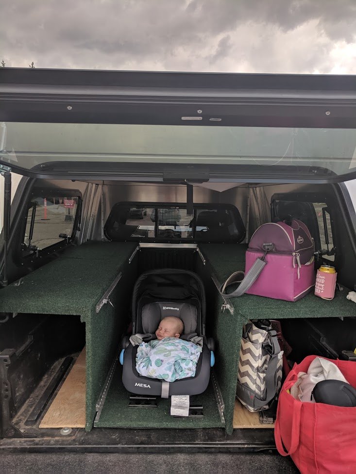

    When I get my Drifter next summer I'm looking to build a storage platform and some boxes on one side of the bed. Budget build, nothing elaborate but I want to make it look as decent as possible. Does anyone know any good carpet type material I could staple to the wood to have some nice surfaces and dull edges? I've seen something similar in here but can't remember what pages

    For my initial build, I used plywood I had laying around the garage and the TrafficMaster carpet from home depot (https://www.homedepot.com/p/Traffic...r-Outdoor-12-ft-Carpet-7PD5N620144H/203240737). It comes in a couple colors and it's quite durable so far. Plus, the baby finds it quite comfy for lounging!

    Webasto and Espar both make gasoline heaters. They're pretty popular for transit/promaster van conversions.
  19. Sep 24, 2019 at 10:55 AM

    The rails down the center? That's L-track, very versatile. https://www.uscargocontrol.com/shop/Enclosed-Trailer-Accessories/Airline-Straps-Hardware
    I mounted my boxes to the bolts in the bed of the truck, as well as the Tacoma's bed rail system using some bolts through the top and standard bed rail clamps. https://www.amazon.com/Better-Built...ocphy=9029760&hvtargid=pla-595419391159&psc=1
    In terms of corners on the carpet, this is useful: https://dadand.com/wp-content/uploads/2012/02/dadand-upholstering-a-corner.jpg
