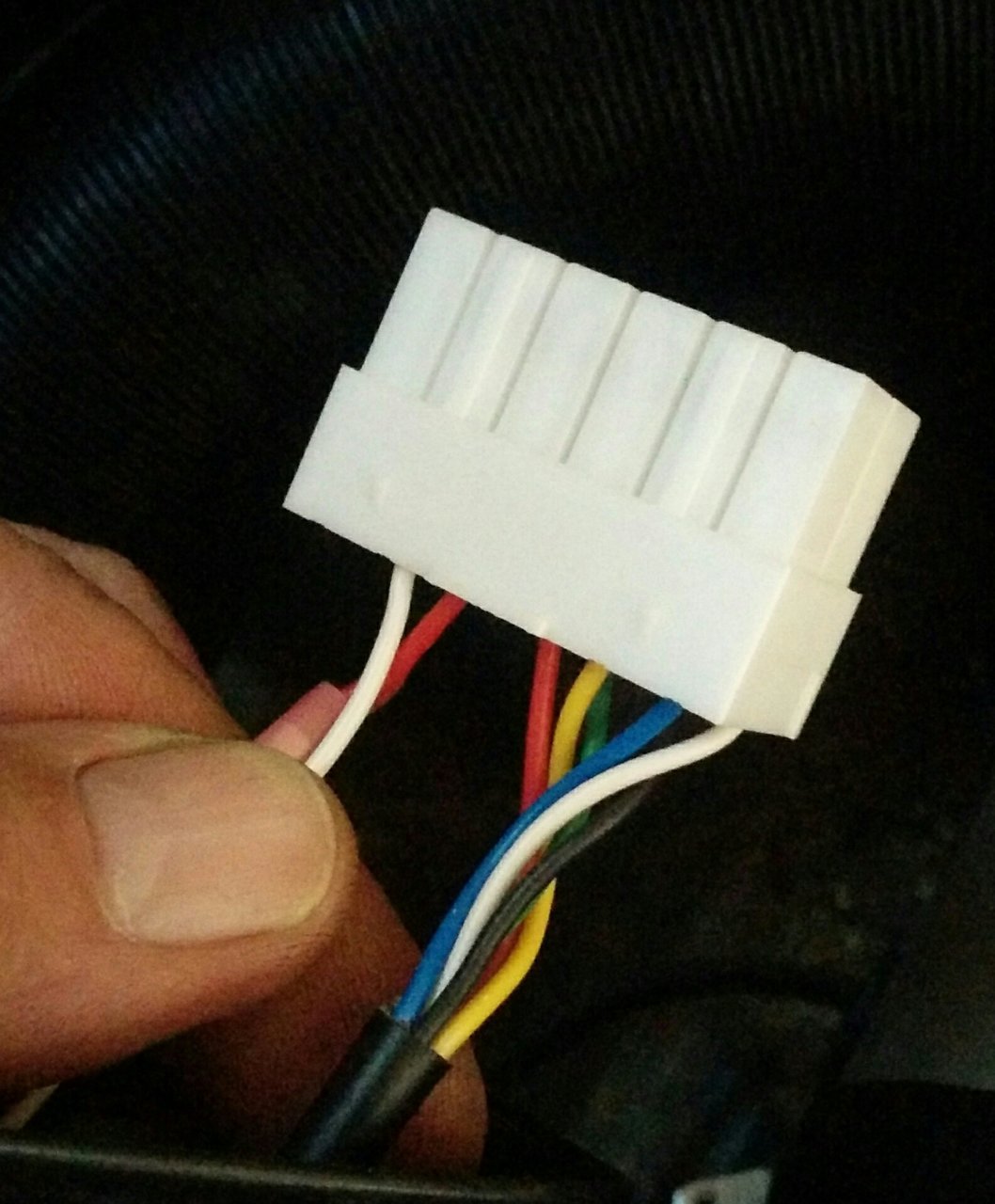

    I am wondering if a Propex owner could help me with a wiring question. What type of wire connects the thermostat to the Propex? I would like to have Vagabond run the Propex control cable behind my insulation at the factory. Any idea what cable I could buy off the shelf to have them run? I don’t plan to purchase a Propex for a few years.

    From pictures, it looks like 5 or 6 wires to the thermostat. You could buy some 18/7 thermostat wire and have Vagabond run that.

    I can help later today when I get home from work. I'll take a couple pics. It is a plug in harness on both ends.

    This is the heater end of the harness. There are 6 wires to the thermostat coming from this connector that pass thru their own harness..the other two wires under my thumb go to the battery. The thermostat also has a short leader with a smaller connector ( six pin ) to match the other end which I can't get a shot of without removing my panel.

    Vagabond uses a wiring channel above on both sides so it is not needed to run wiring behind the insulation as far as I understand.

    The wiring channels run all the way around the top and down all four corners. Makes it super easy to run wiring to anywhere in the camper.
